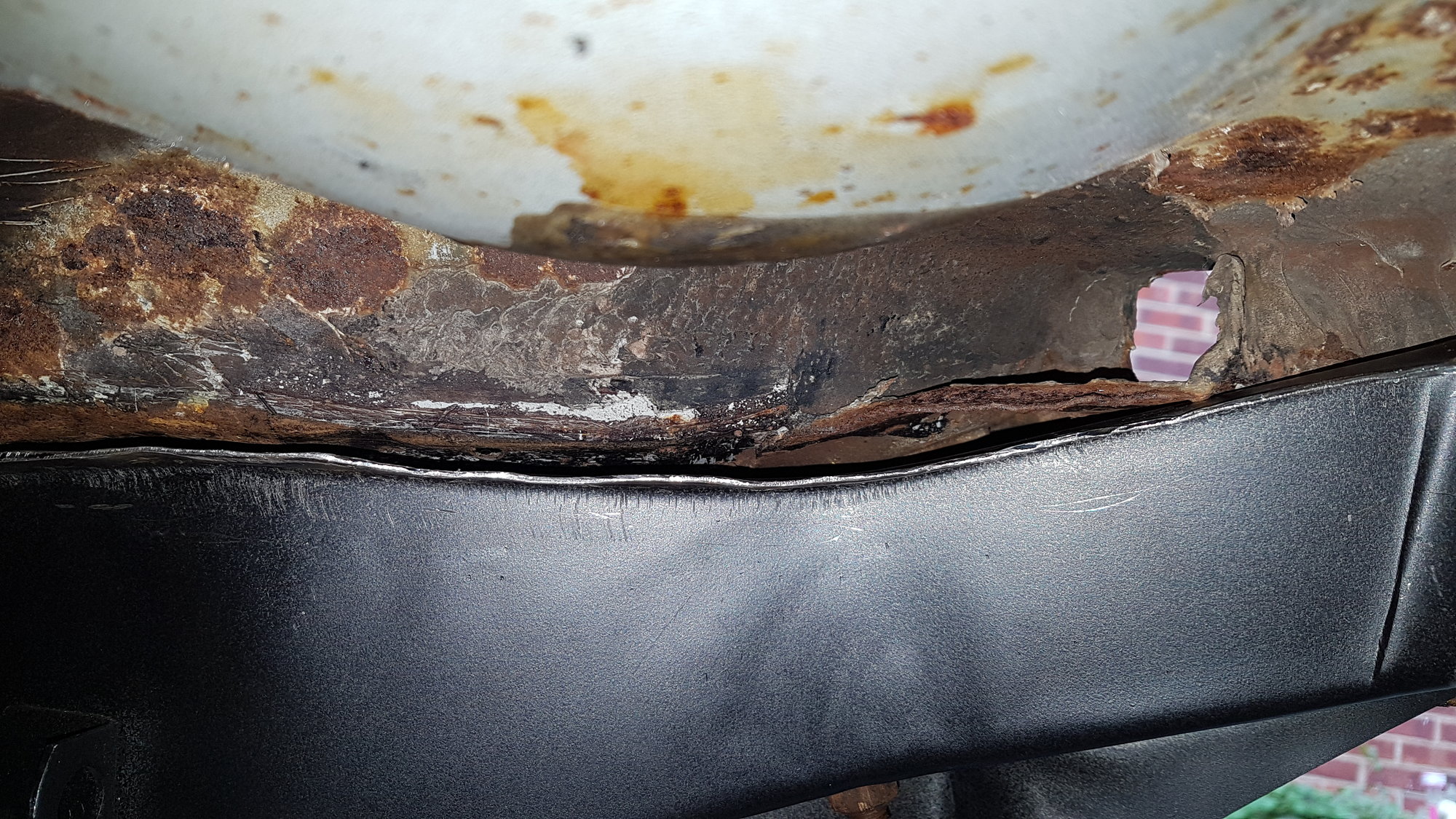

It doesn't look a mile away and I would think a bit of fettling would get it. I've never heated a pressed part so not 100% sure if heating will help. How about a jack and a block of wood to get it up at the low end? Another option would be to cut the flange off the new part and weld it directly onto the car.
