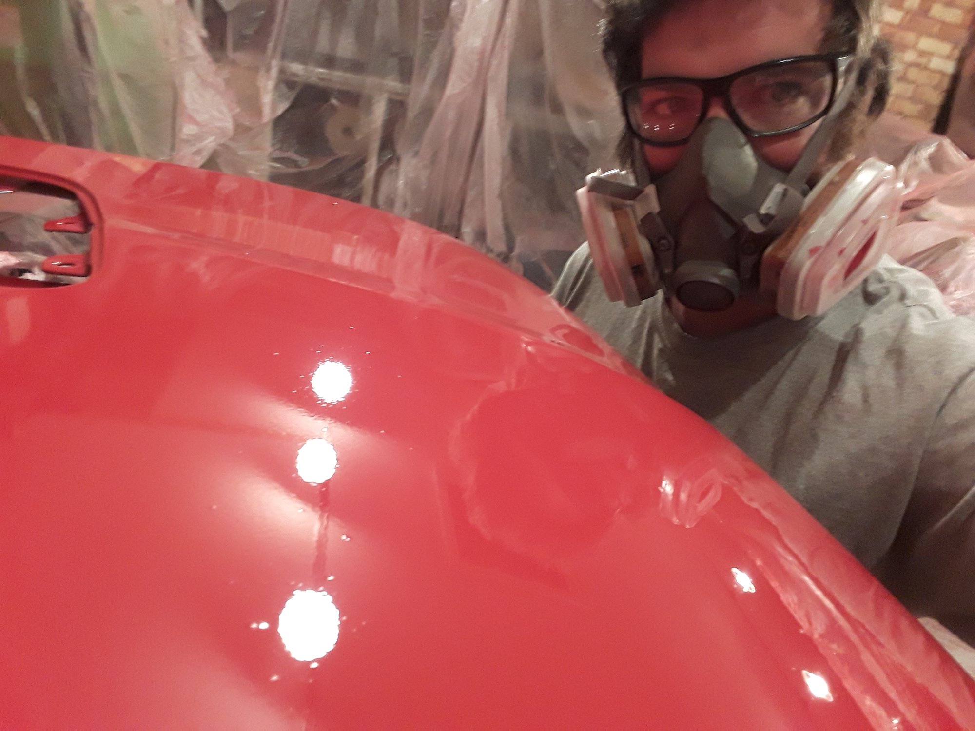

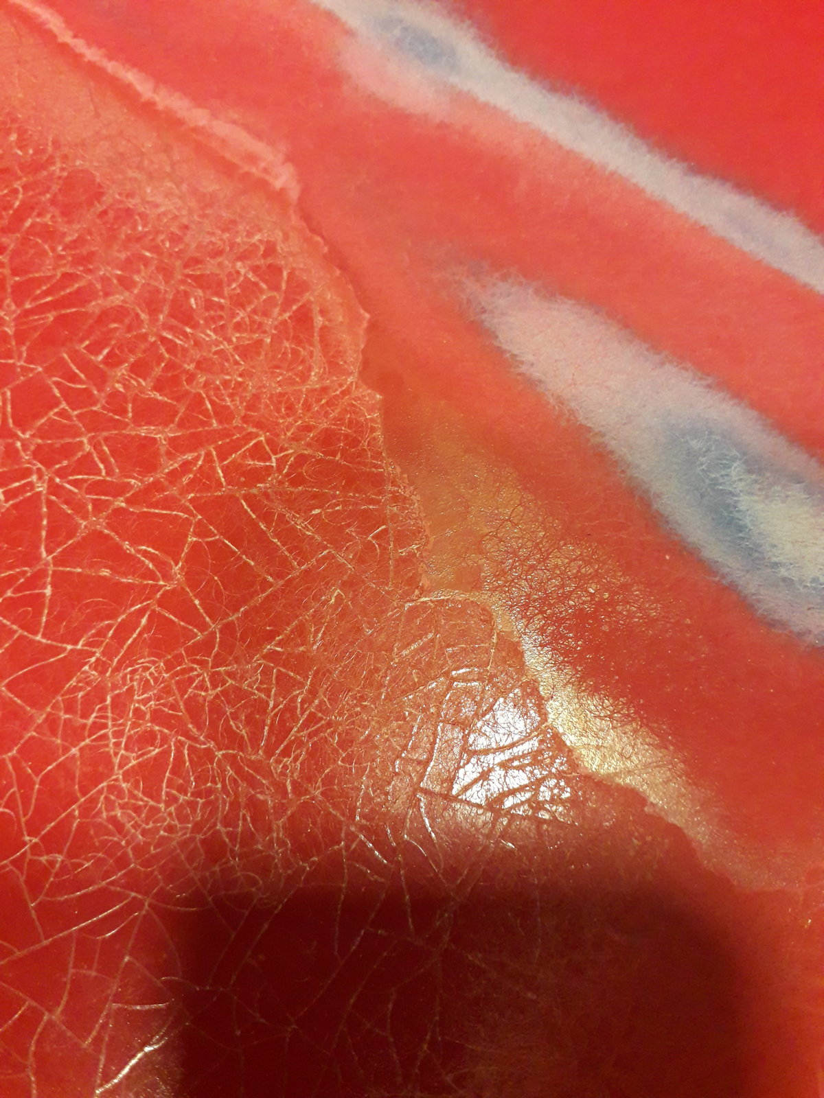

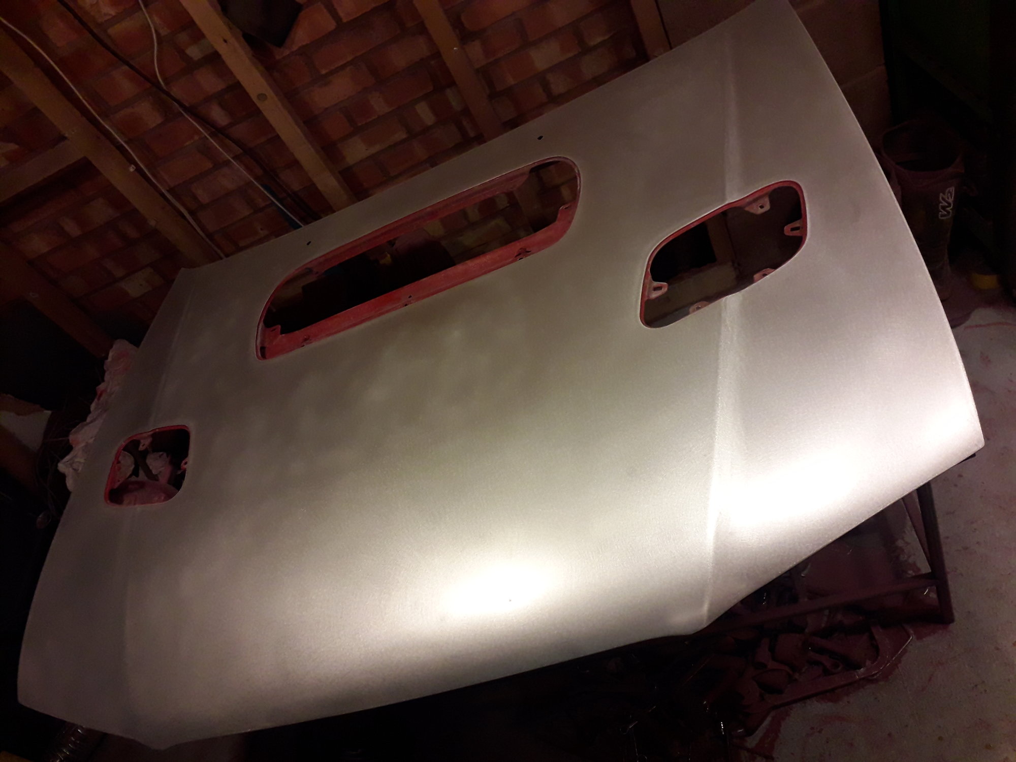

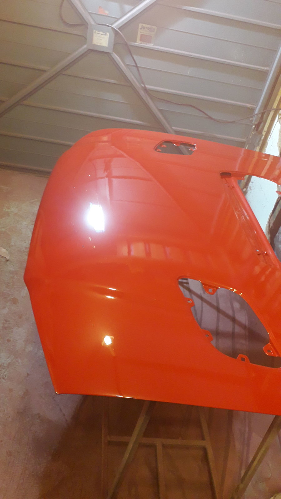

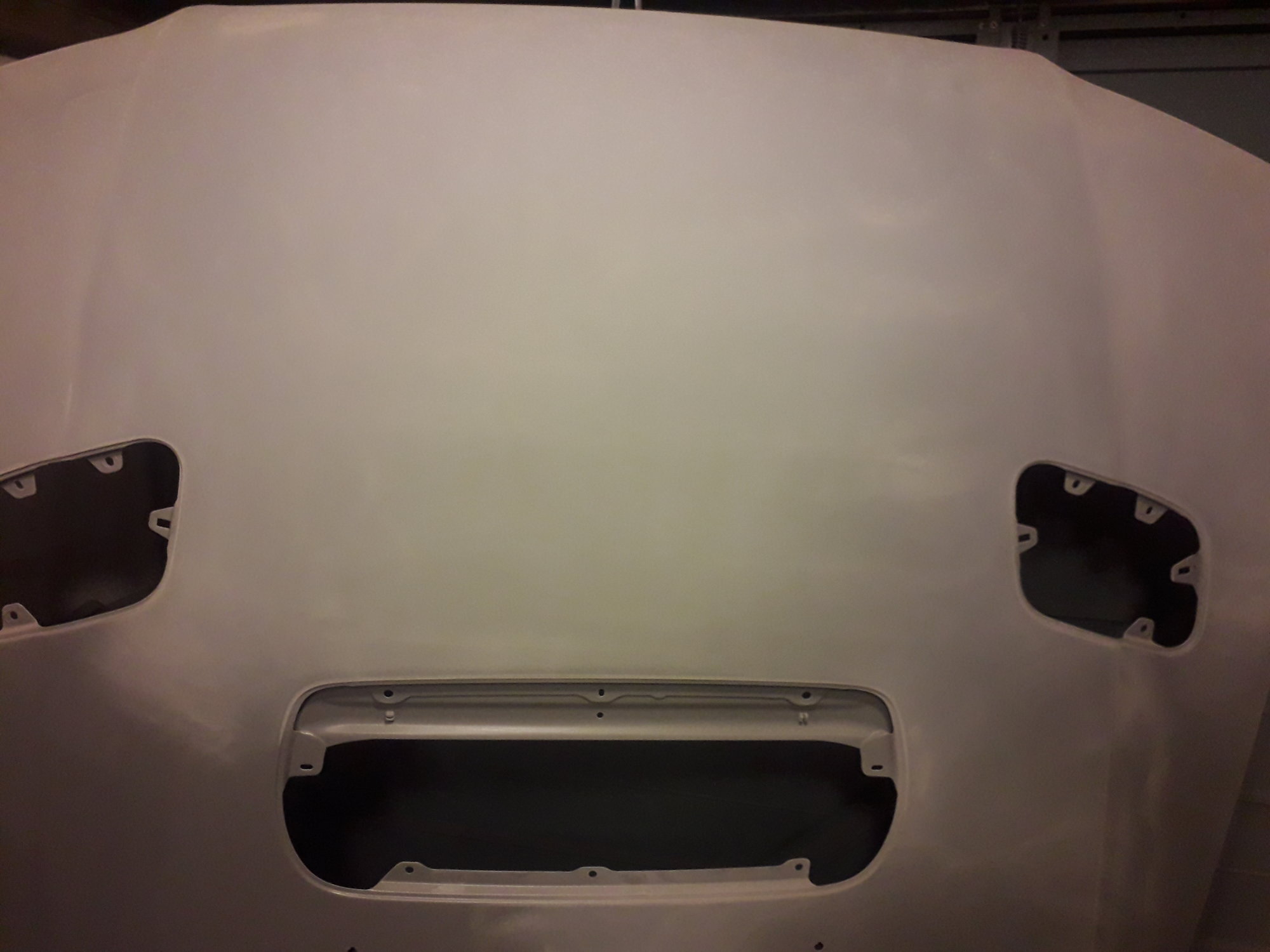

Please please people,
Dont use single pack or acrylic paints unless your willing to leave it forever and a day to dry.

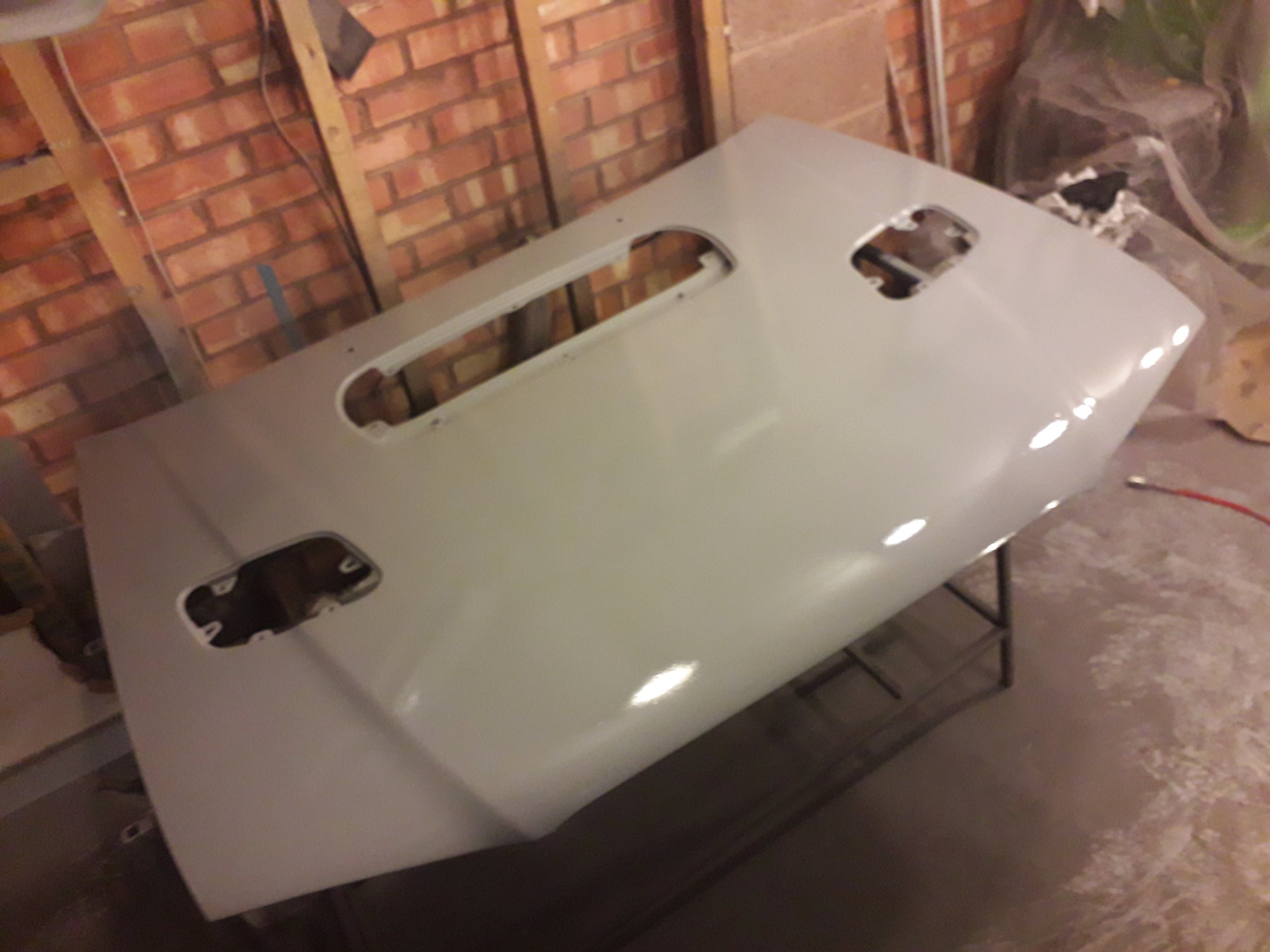

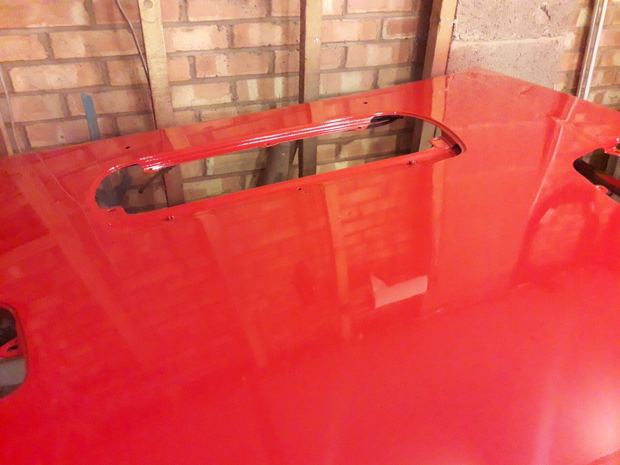

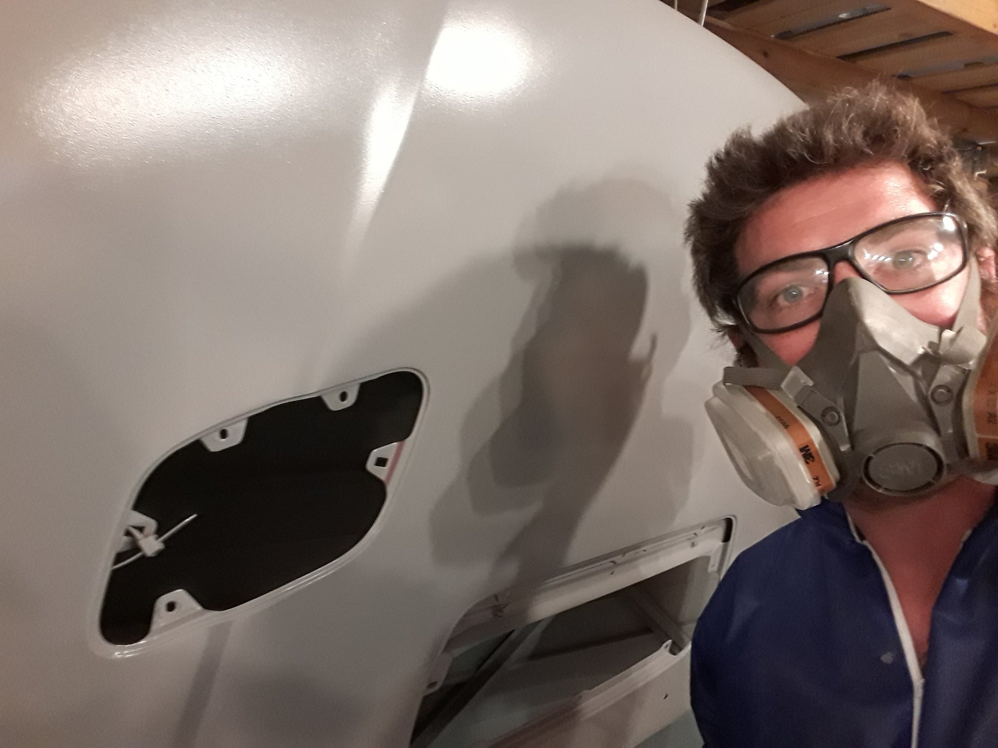

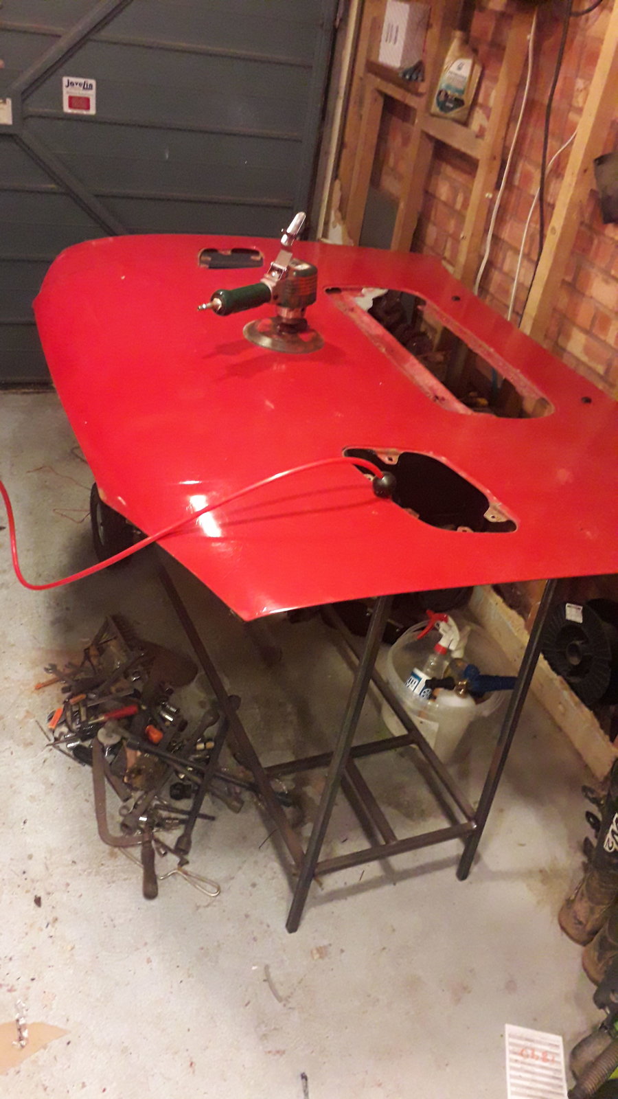

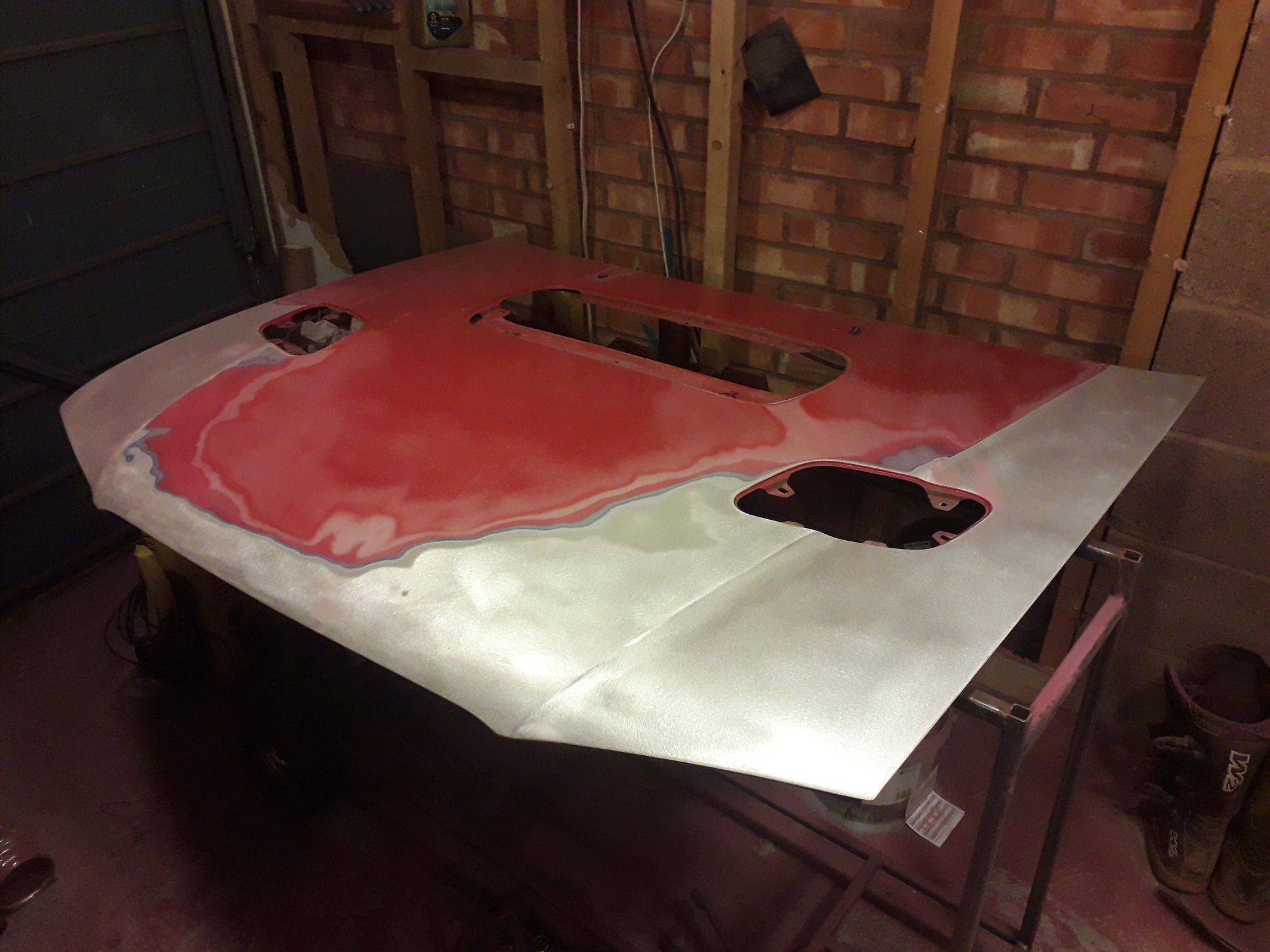

Due to not trusting the product on the bonnet due to crazy cracking shrinkage (suspected) it's now a bare metal job to give me a chance at a decent finish

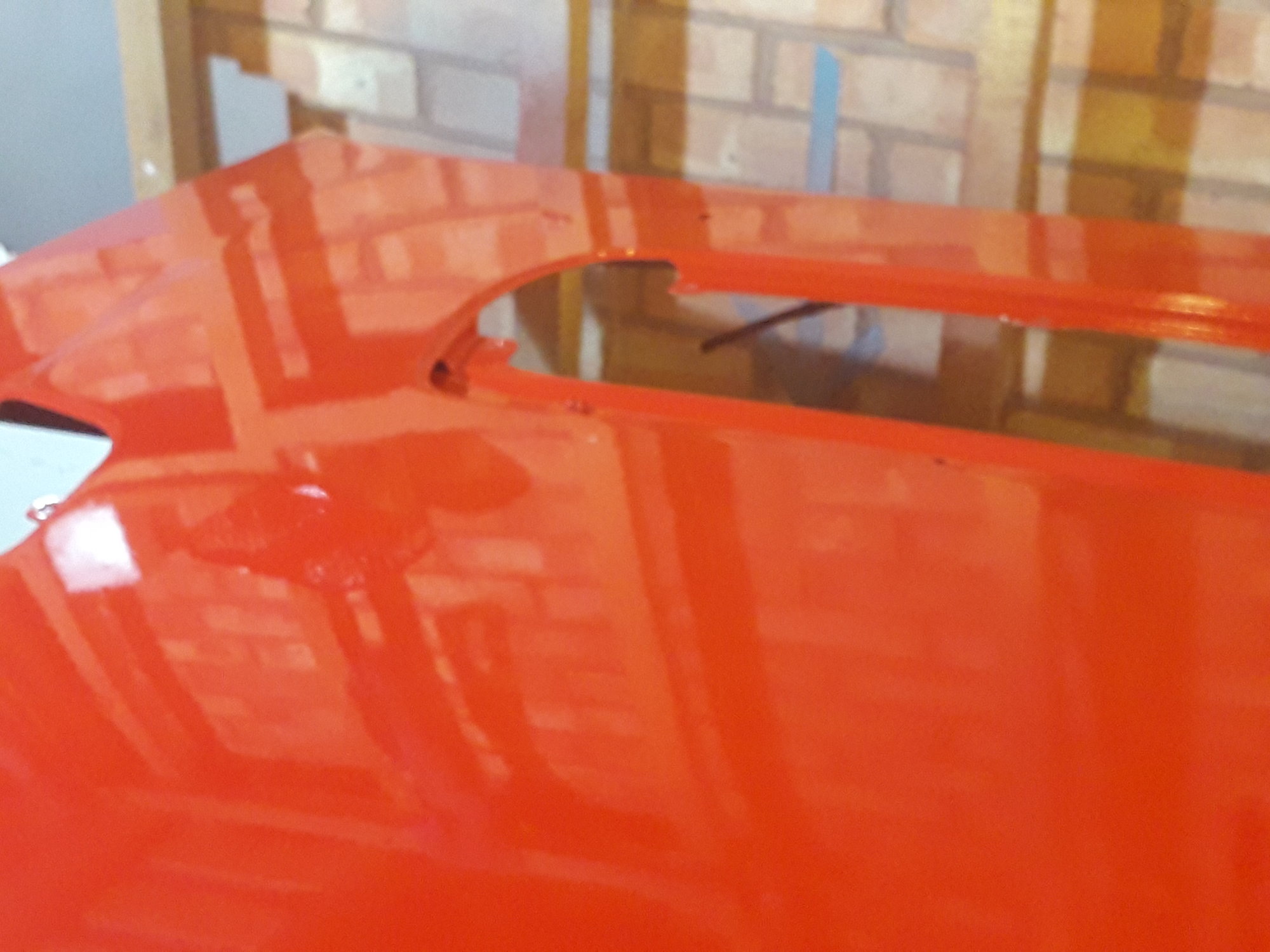

But now I have really nice octarel 2k primer and 2k paint in the right paint code to lay a decent base till end of next year when will be repainted.
