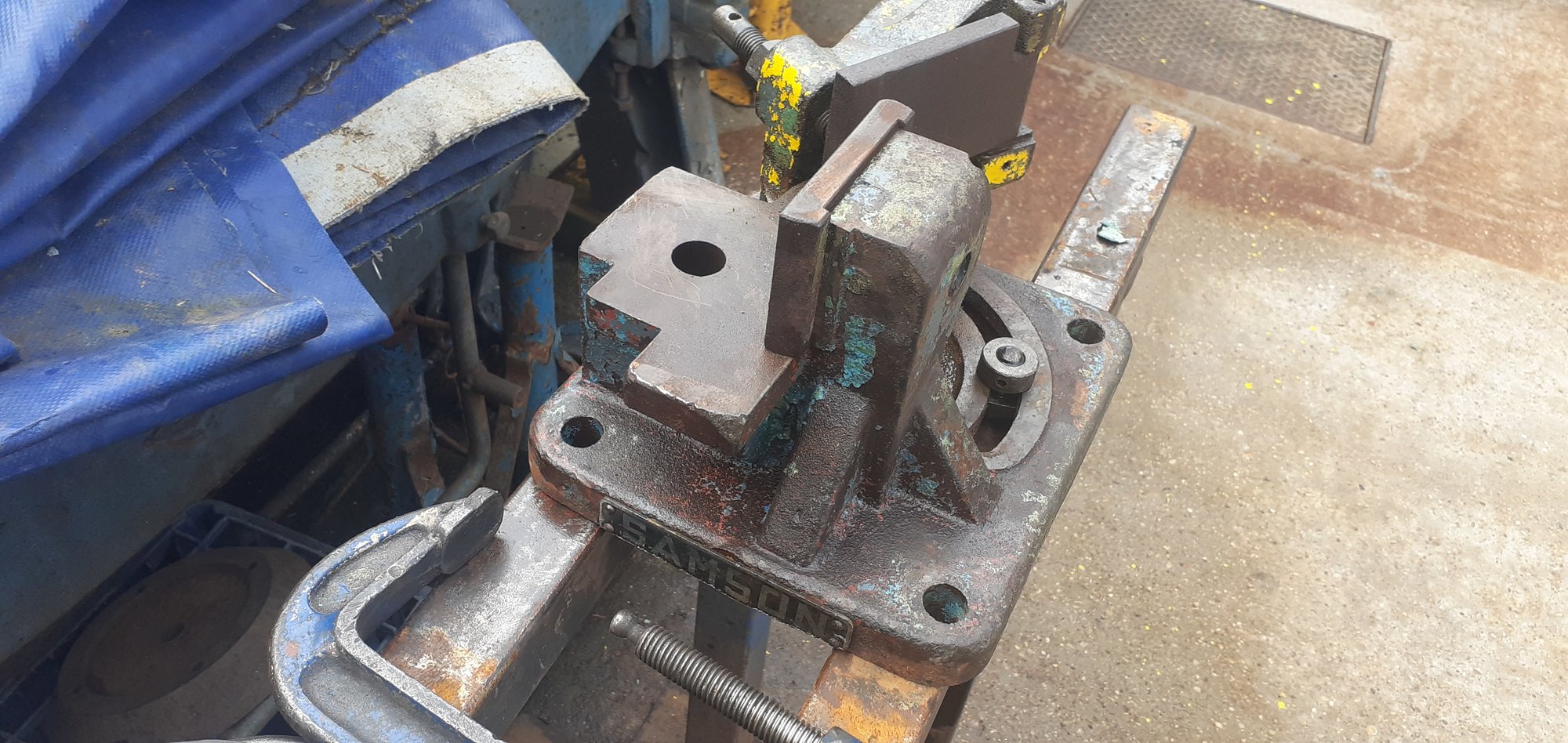

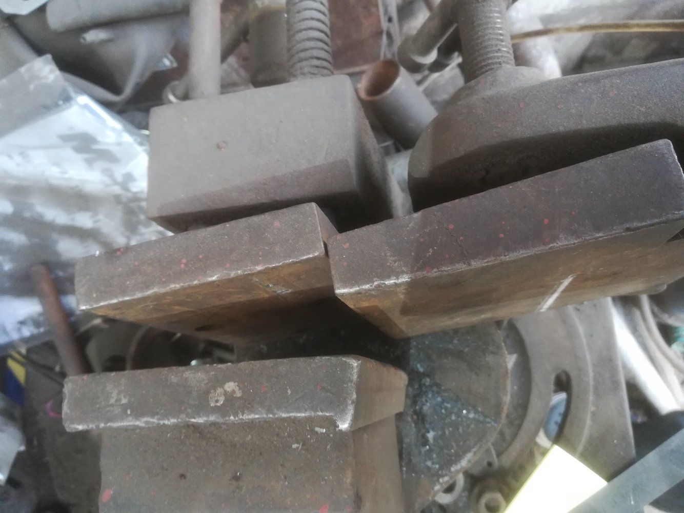

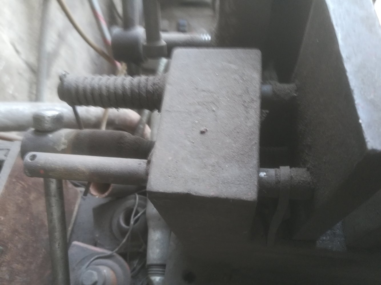

If you need to make hot bends,I made this sleeve to slip over the jaw,just protecting the edge that takes the pressure,which I built up with a nickel chrome rod.You can see it’s been welded around the pivot,by a previous owner,then again by me,that was about 30 years ago,time flies
