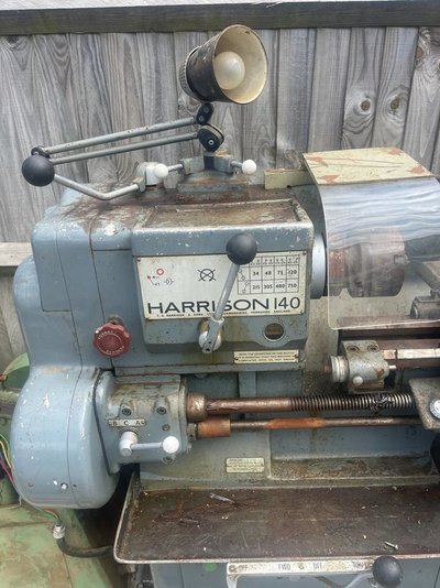

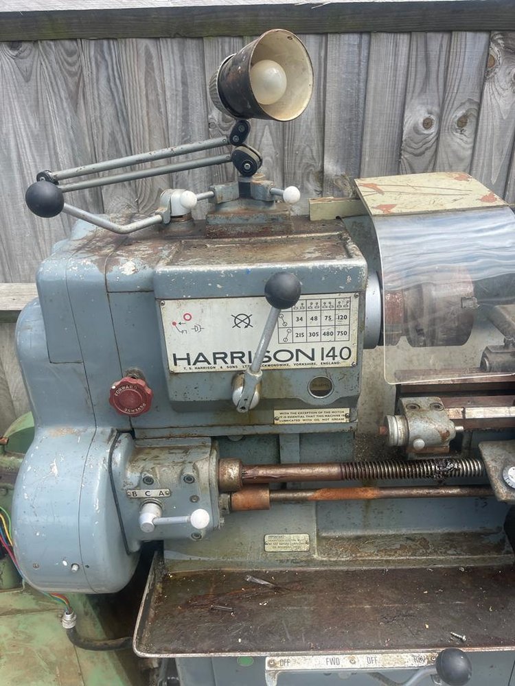

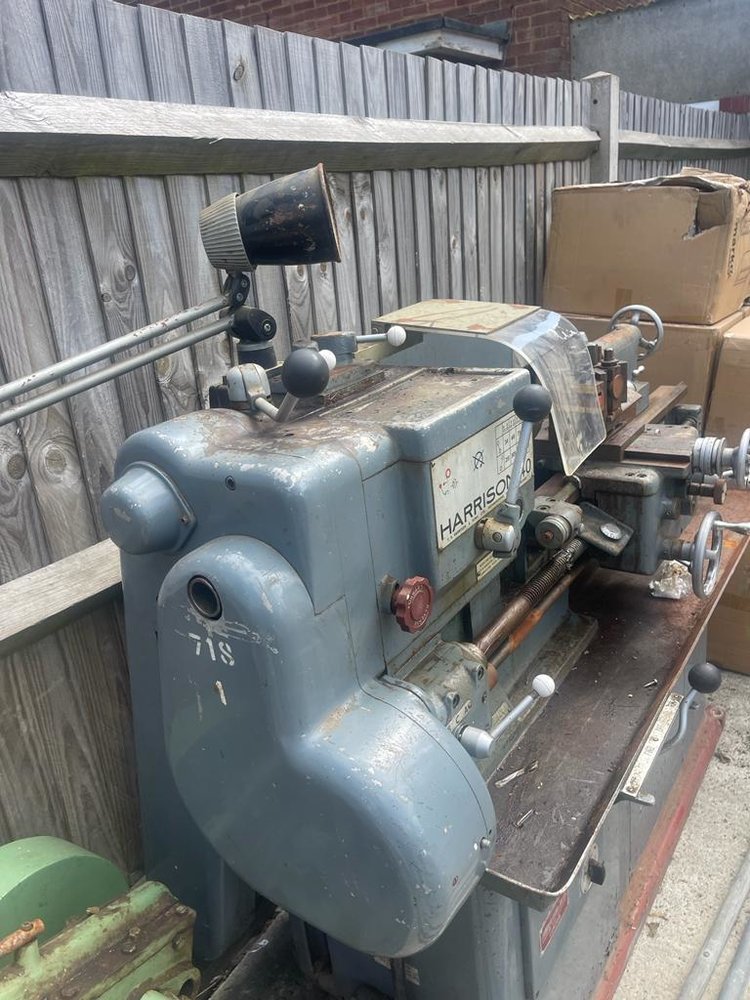

It's from a school , so may have had an easy run , not been outside ( in a container ) coming my way next week !Manual here:
As above, if you want to use it for screwcutting, check that the change wheels are there.
There has been lots of discussion on here about the various speed ranges they came in. That one looks like 750rpm max. I am hazy on the details, but I think this was originally aimed at training establishments, so it may have had an easy life.

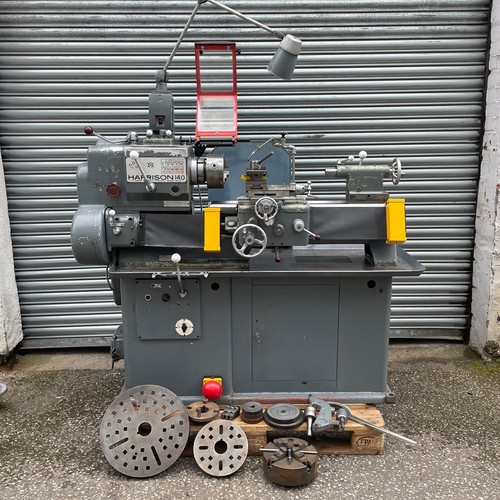

For reference, the 'full package' would look like this:
Harrison 140 Gap Bed Screwcutting Lathe 3 Phase Dual Speed Motor | eBay
Find many great new & used options and get the best deals for Harrison 140 Gap Bed Screwcutting Lathe 3 Phase Dual Speed Motor at the best online prices at eBay! Free delivery for many products.www.ebay.co.uk

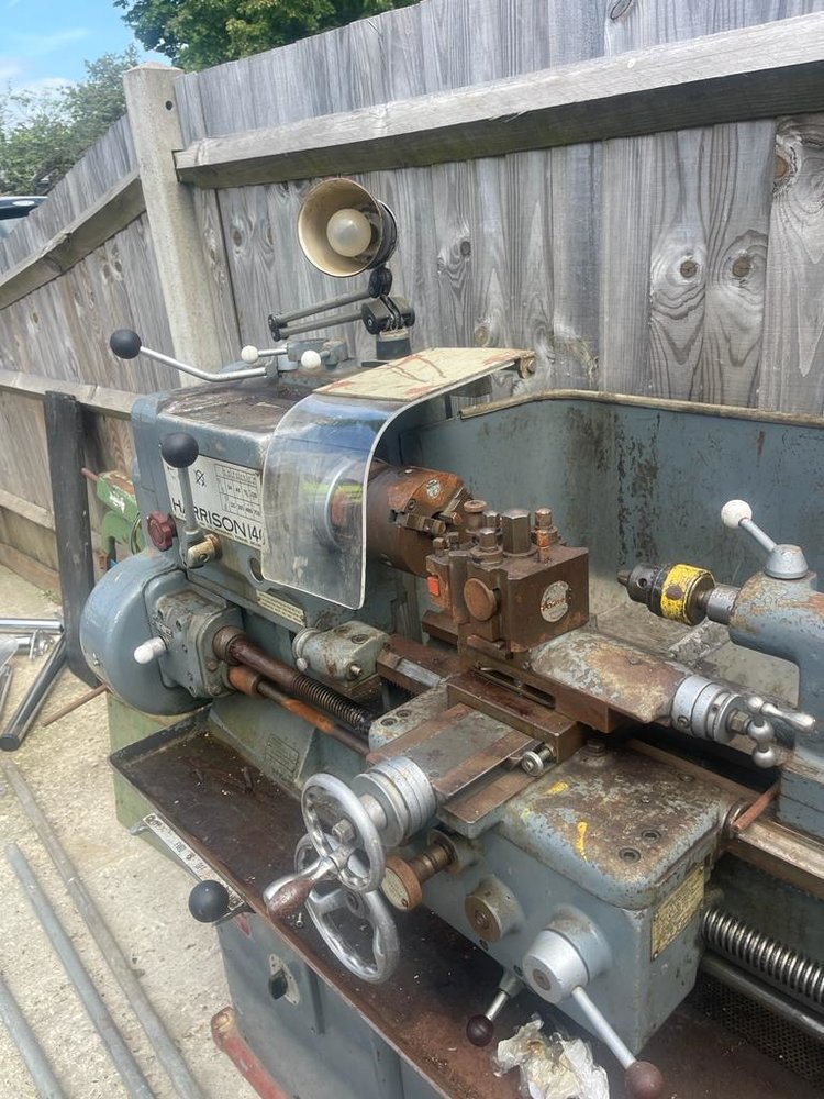

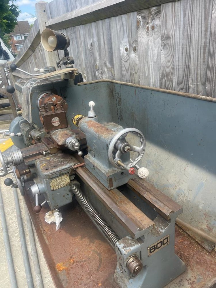

It's an adjustable micrometer stop.What's clamped to the gap? Some kind of anti crash stop? A school/collage lathe?
RareIt's an adjustable micrometer stop.
There's the money !Rare
Austin Allegros are rare.....................There's the money !
Rendered obsolete by DROThere's the money !
Not necessarily.Rendered obsolete by DRO
they don't have a tripNot necessarily.
If you have an automatic feed trip on the carriage feed they're still incredibly useful:
• Move it to about the right place,
• Take the first cut with the DRO,
• Set the micrometer stop to touch the carriage,
• Every subsequent cut will stop in exactly the right place.
The DRO actually makes it easier to make use of the stop in that scenario.
The 140 has a spring-clutch overload mechanism for both feed shaft and leadscrew doesn't it?they don't have a trip
It's not foolproof and should not be used as a trip. it's a safety mechanism for crashes onlyThe 140 has a spring-clutch overload mechanism for both feed shaft and leadscrew doesn't it?
I thought that was the feature that had made them such good machines for training establishments.
