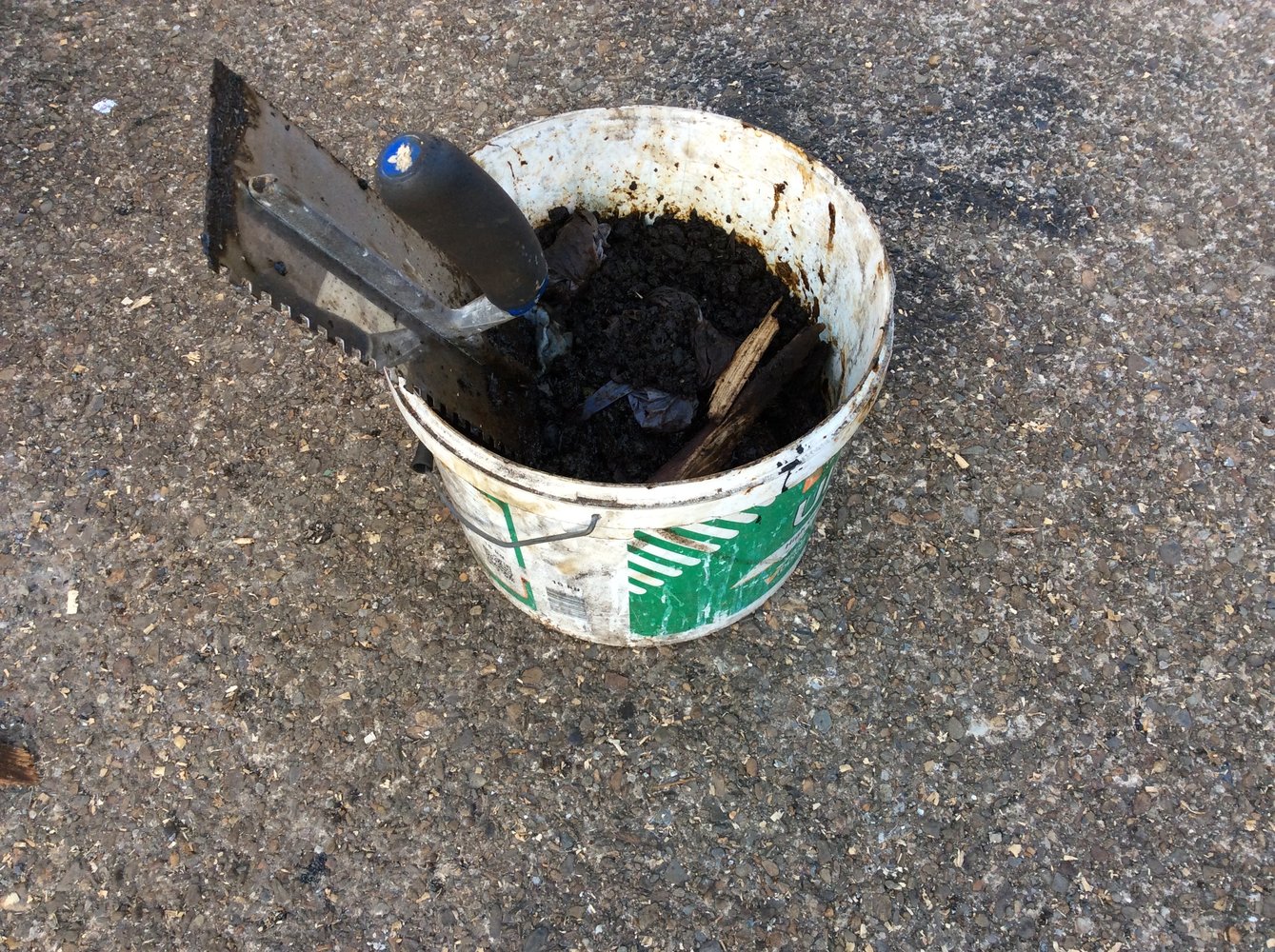

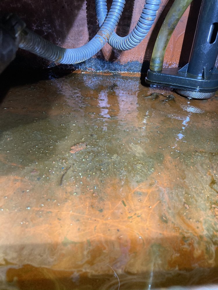

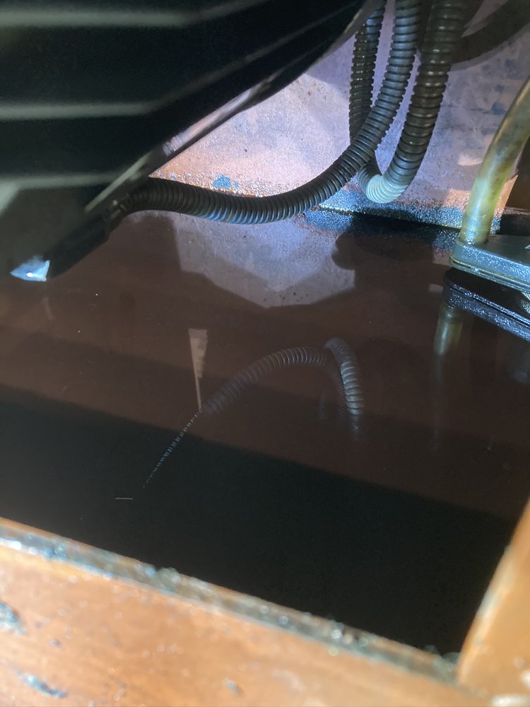

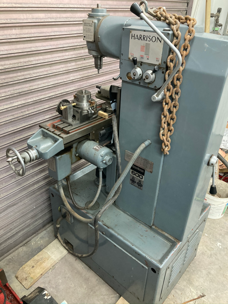

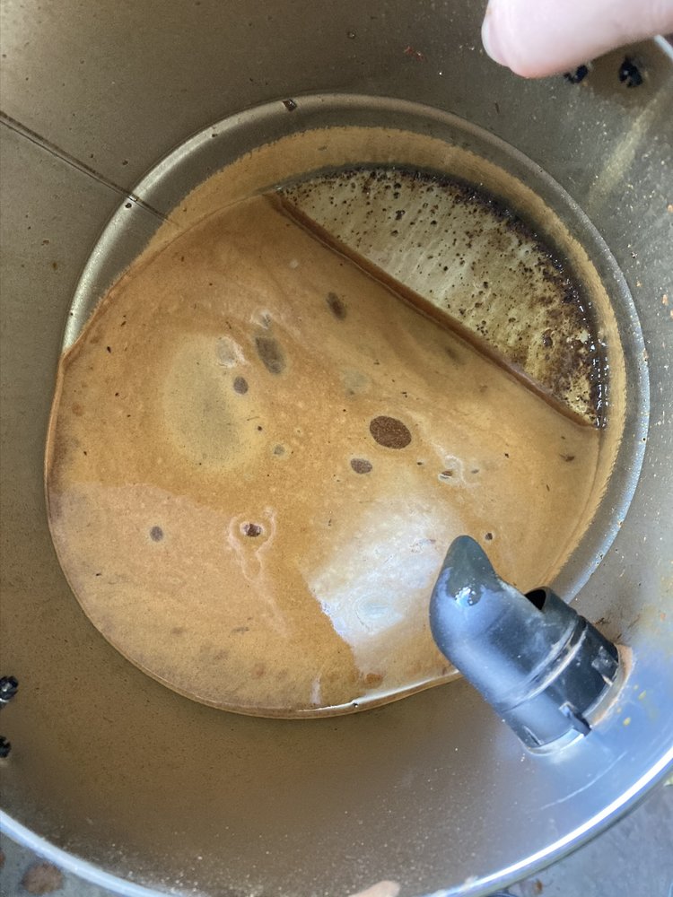

So I had a brainwave and I tipped the mill back slightly so that all the gungy oil accumulated at the back and then I used a cheap wet/dry vacuum to suck all the scum out.
I then disposed of it in a safe and responsible manner.

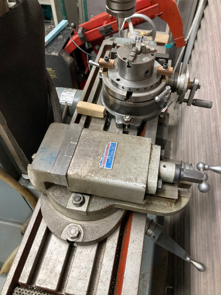

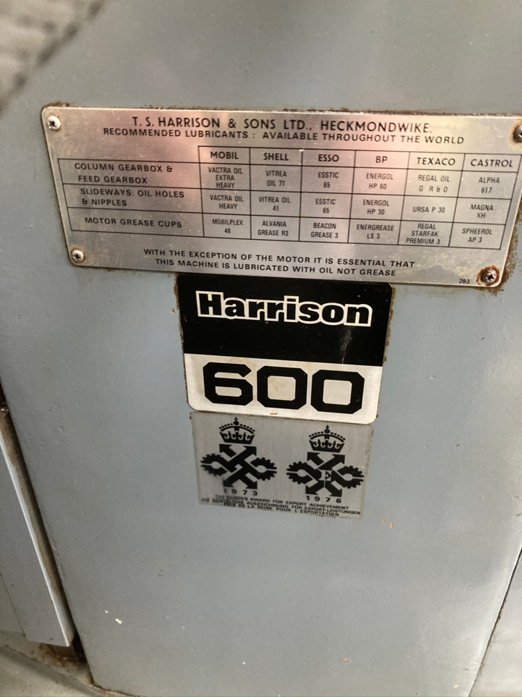

I managed to get it to run perfectly fine off the Teco/DrivesDirect Digital Convertor and then moved the mill to where it's going to live for the foreseeable future, I'll get it all wired up properly in due course. Does anyone have a recommendation for an oil can/gun for use with oil points on this? Mine just gets oil everywhere except into the point, obviously I need one with a finer nozzle or something.
