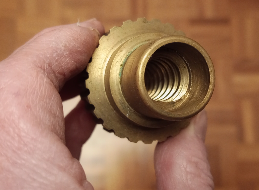

I have a Harrison Milling machine. There is excissive backlash on the X Axis of around 0.2mm.
This is caused by play in the power feed gearbox and nut.
I am currently trying to track down the actual source of the play/wear.
The feed screw goes through gear 14. Does anyone have any experience of this.
Is this a normal amount of play ? To me it seems excssive.
