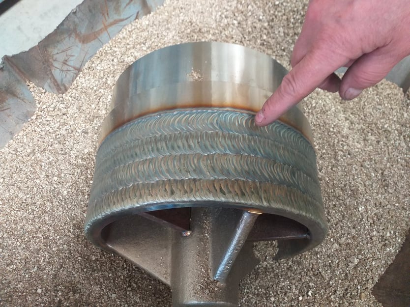

I am sure that is what he said it wasThat looks very hot for a duplex base metal.
Well, not exactly, that would be 312. Which you could call a semi 'duplex' metal I guess but isn't a proper duplex like 2205 or 2209.Duplex is sometimes used as a buttering layer for hard facing, I believe?
