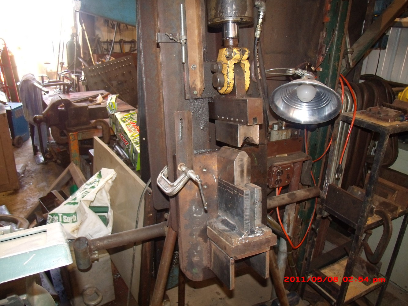

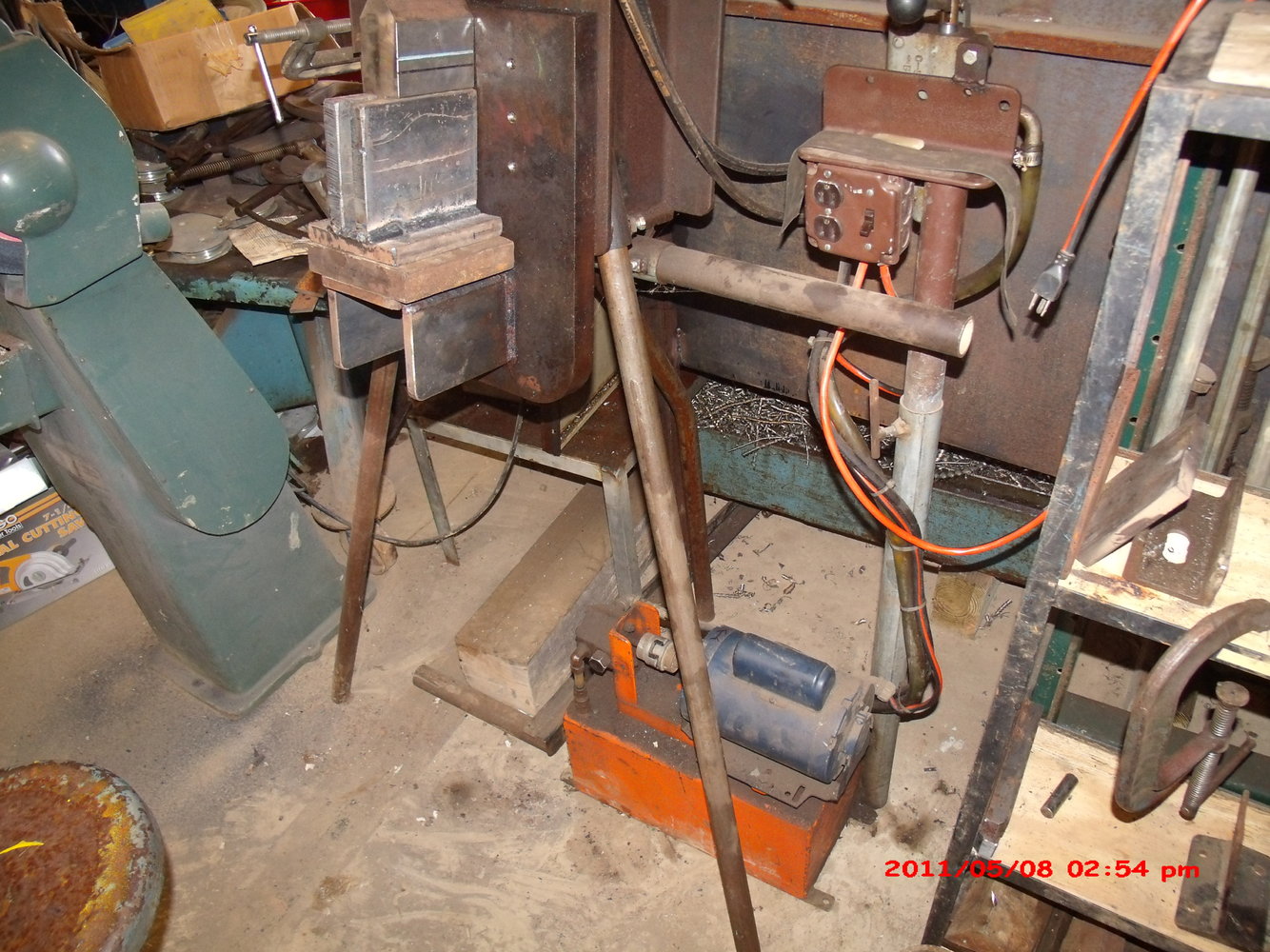

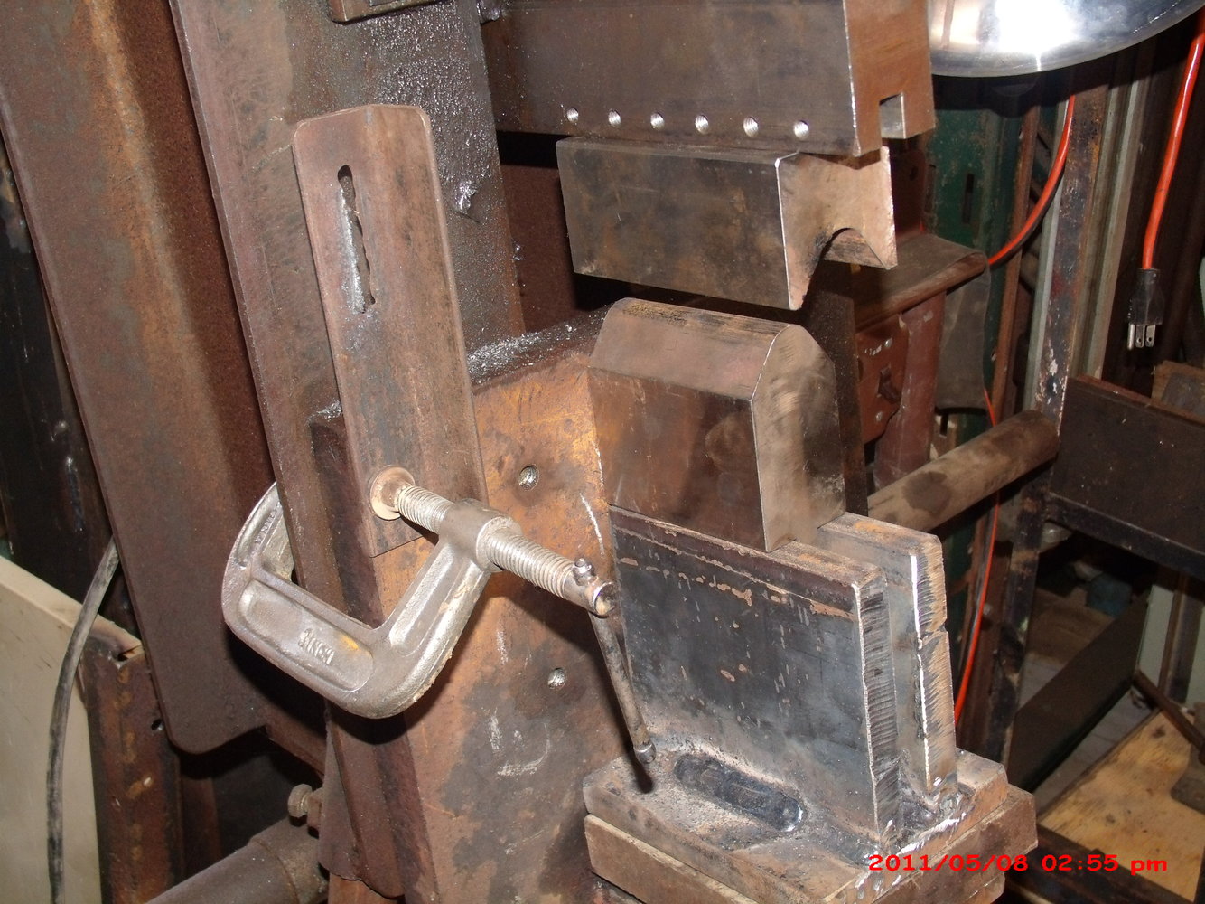

When i was putting up my shop, I quickly cobbled up this from stuff I had laying around.
i made it to lay flat on the bench to bend 13mm rods for the bar joist's (zig-zag bends)

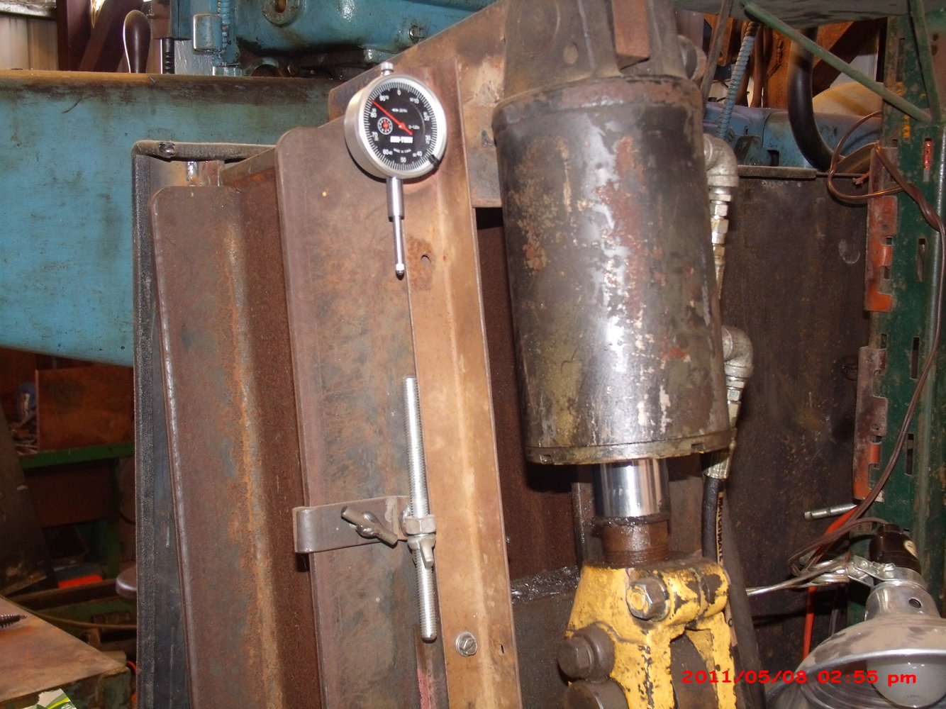

After wards, i put legs on it, and added the cheap dial indicator for depth control.
