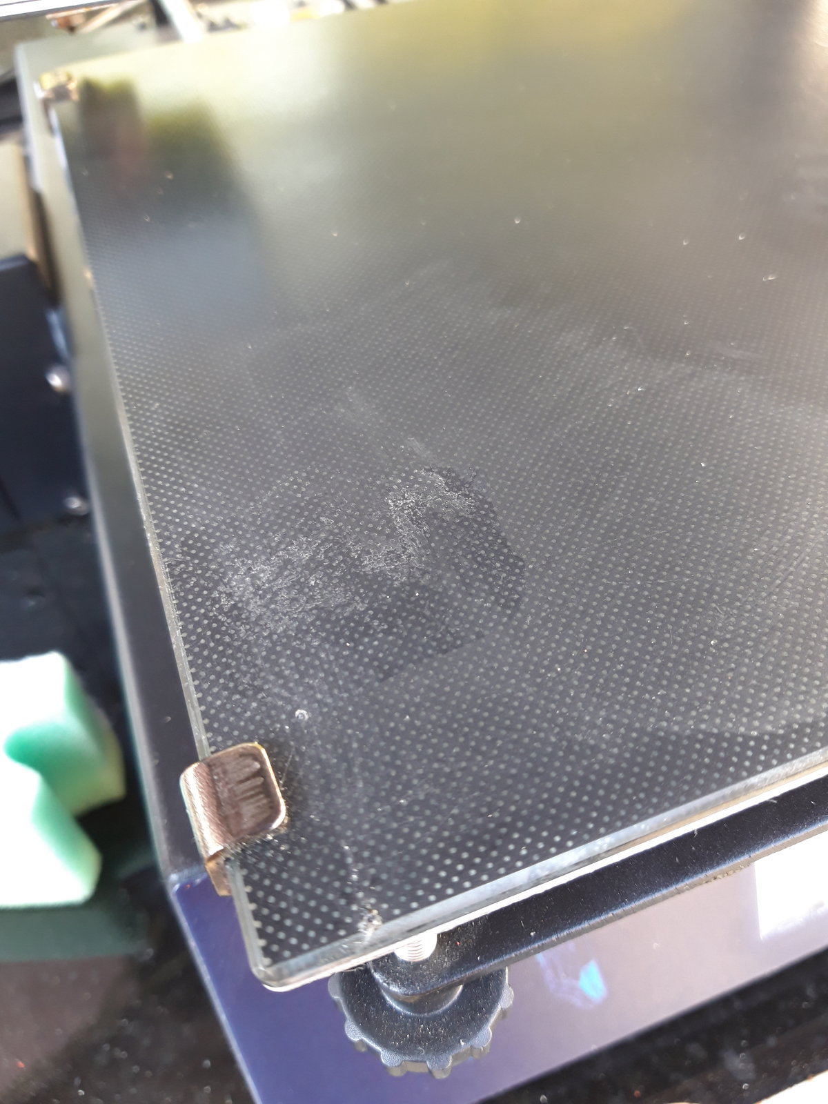

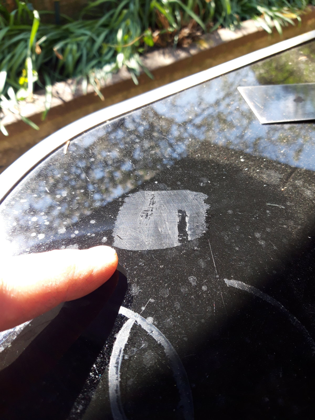

Do you use anything on the bed to promote adhesion?
I've read suggesting to take the bed off before using hairspray as otherwise over spray can gum up moving parts over time.
The other side should be flat glass..
