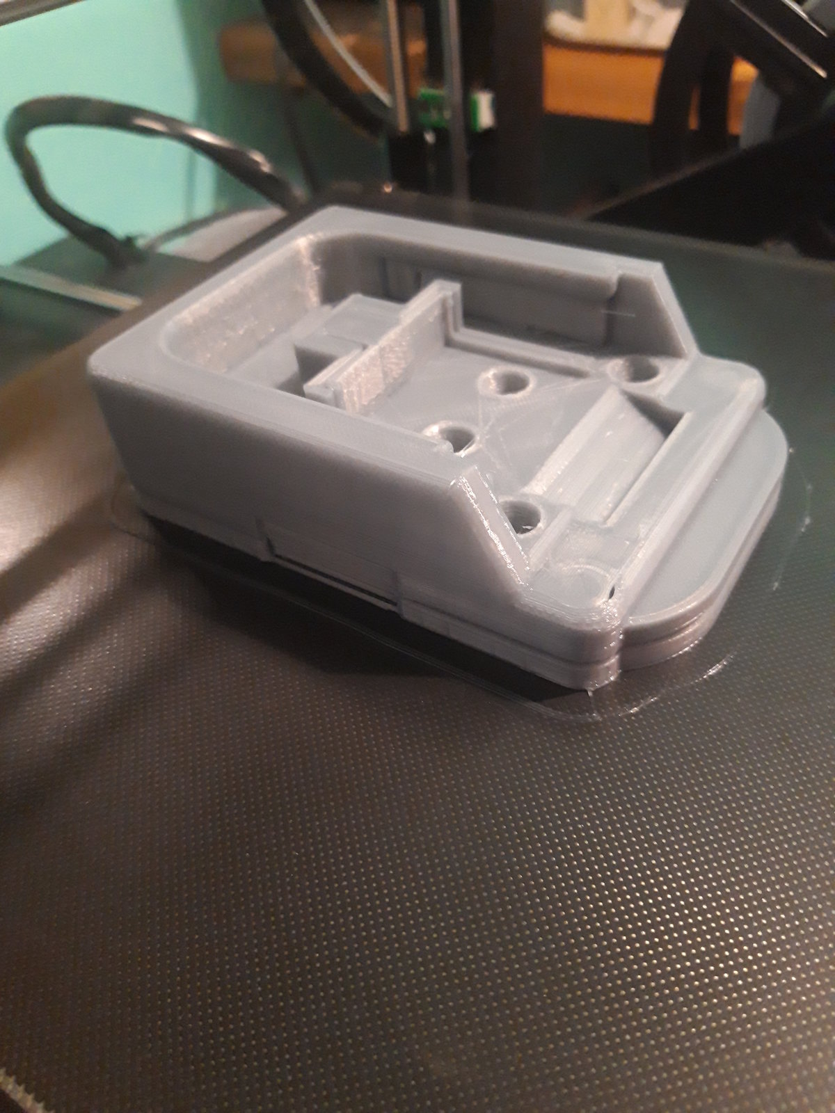

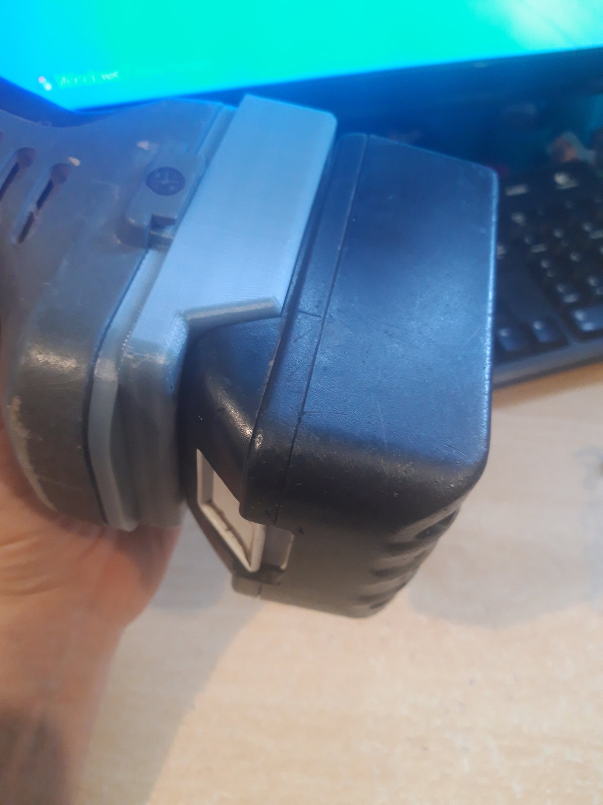

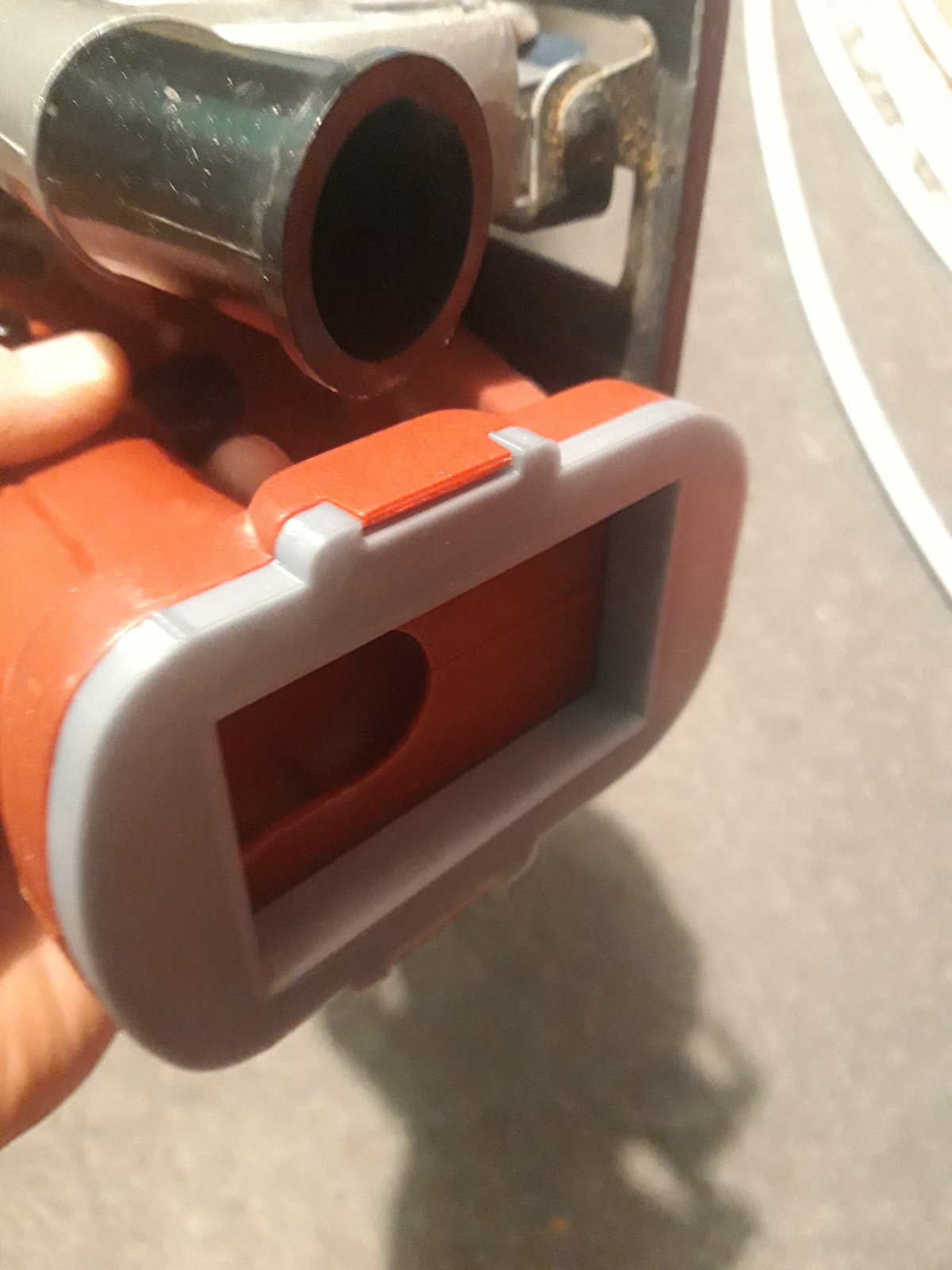

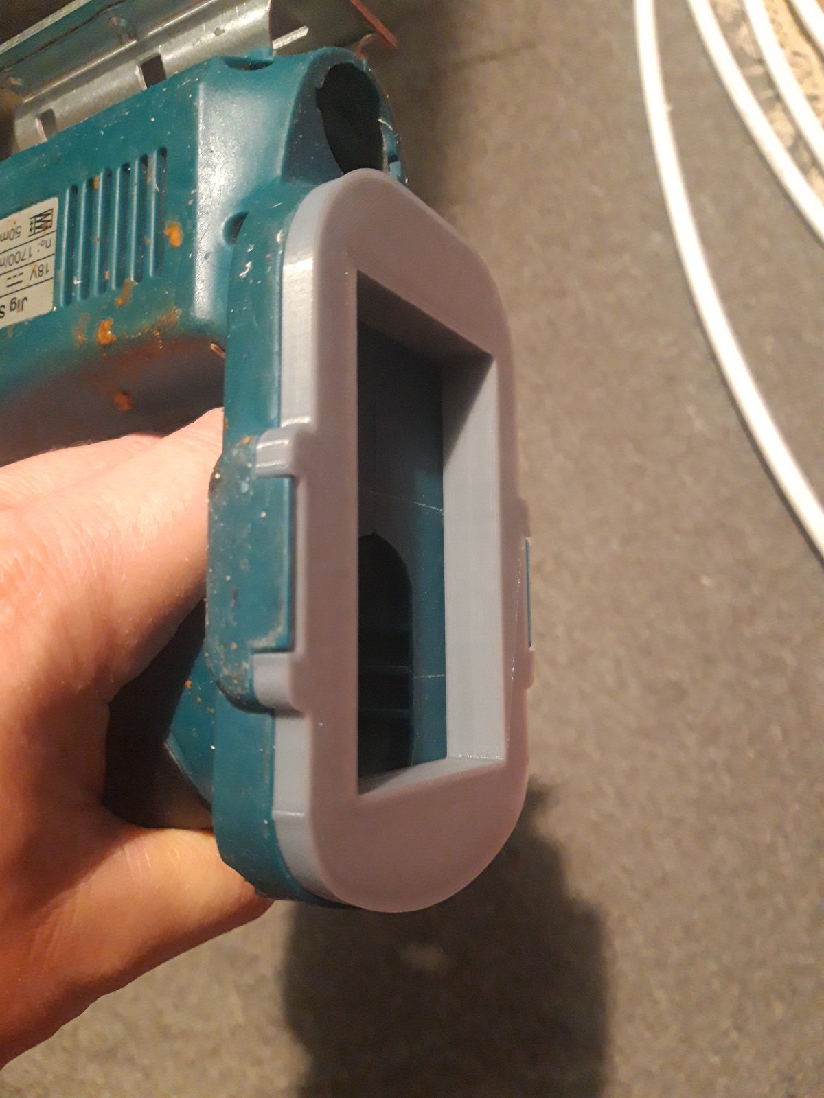

Pretty pleased with the prototype!

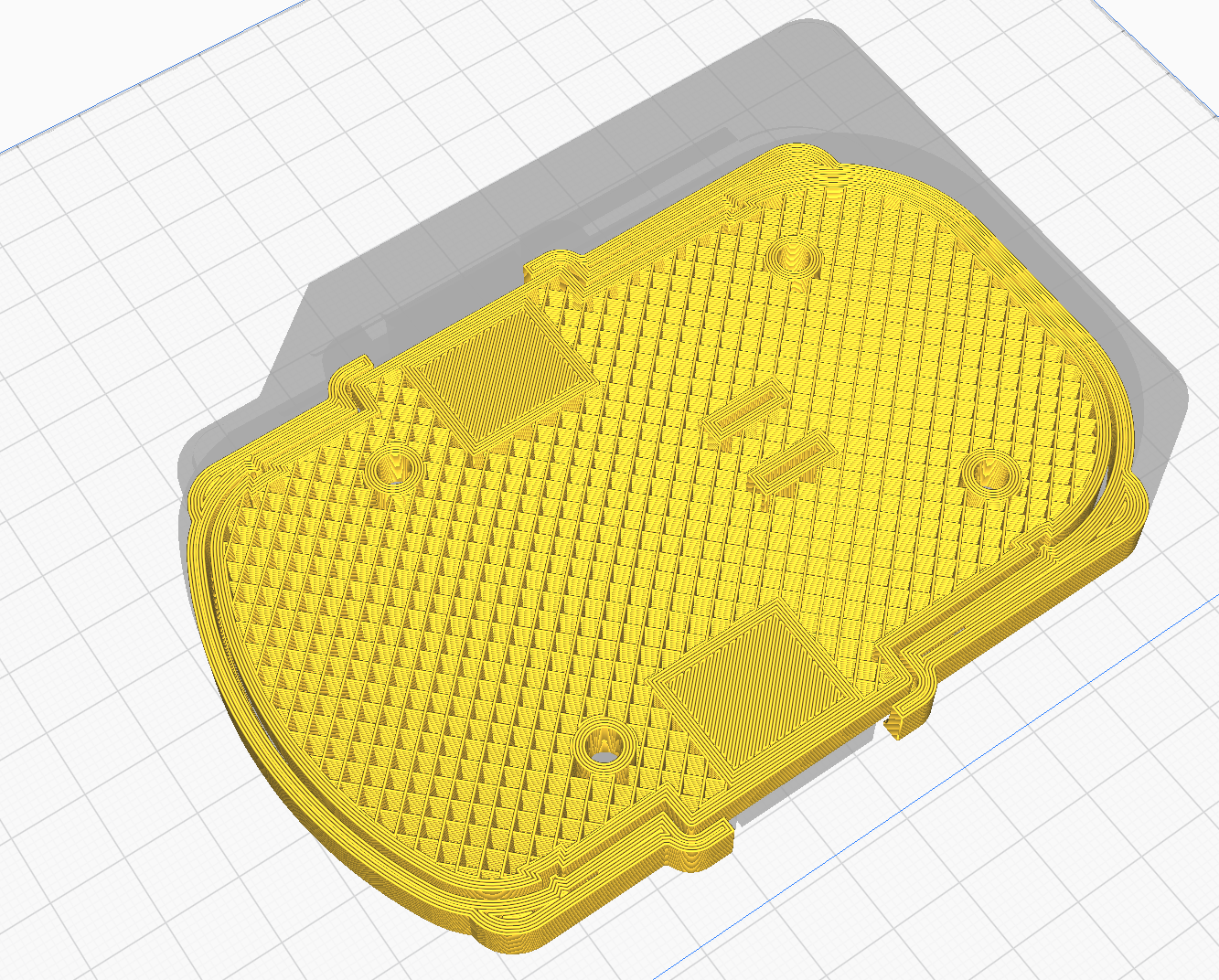

Next time we'll "iron" the top surface to make it smoother. Not strictly necessary as it'll be hidden for ever more:

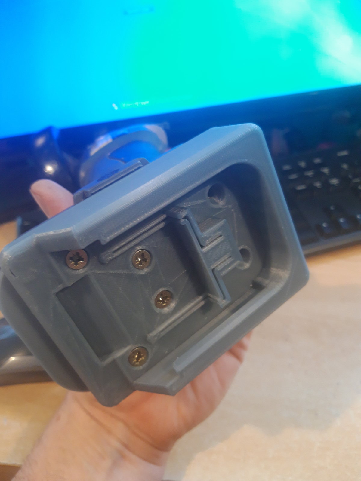

Two screw holes need to be moved as they clash with internal ribs within thd grinder base but it fits. Screwed on with 4x30 Goldscrews.
Just realised we can move the Makita section up by 5mm saving material and print time and meaning you'll see less adapter.
This one is workable though. Onto making the connector plates next!
