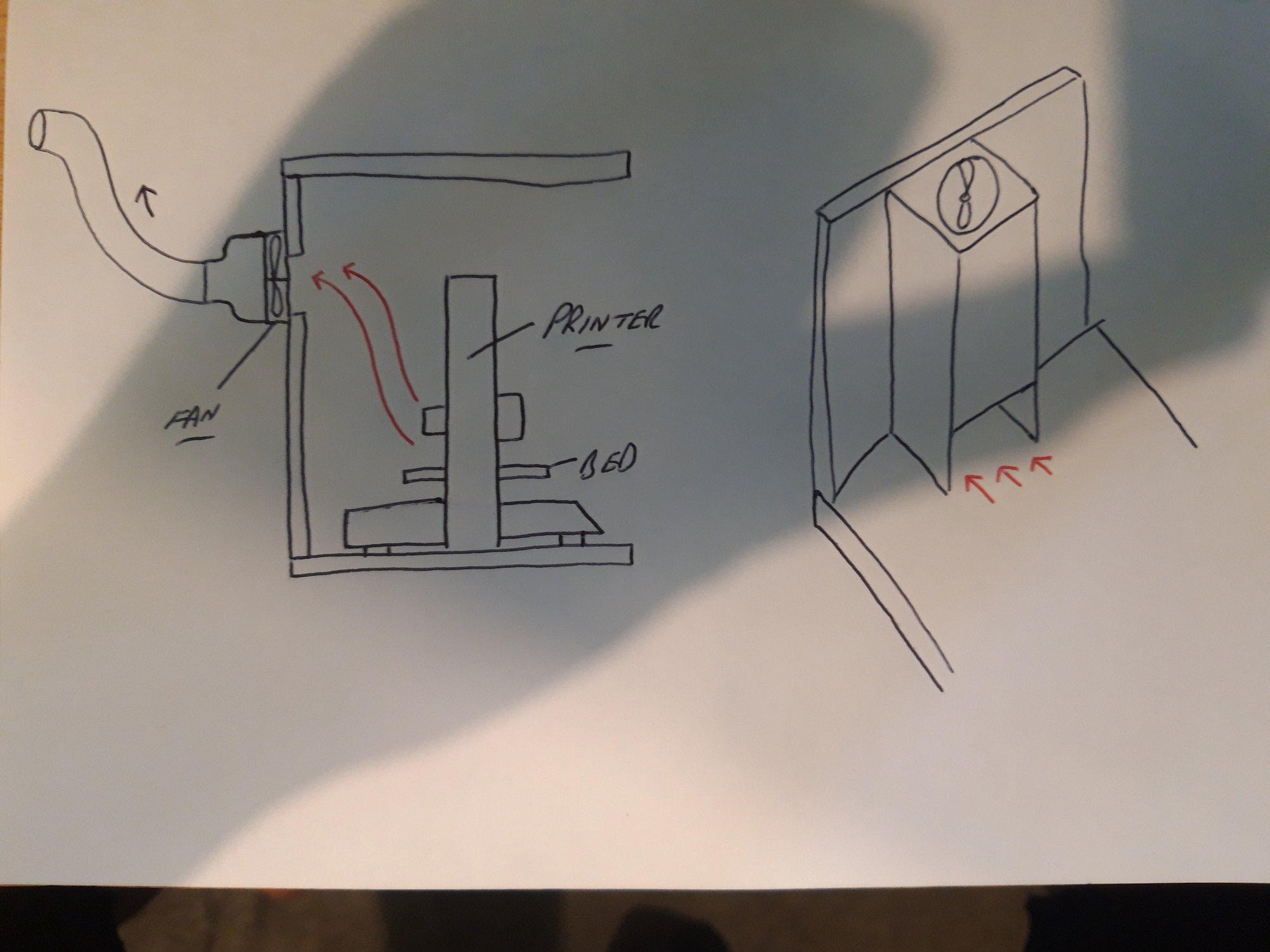

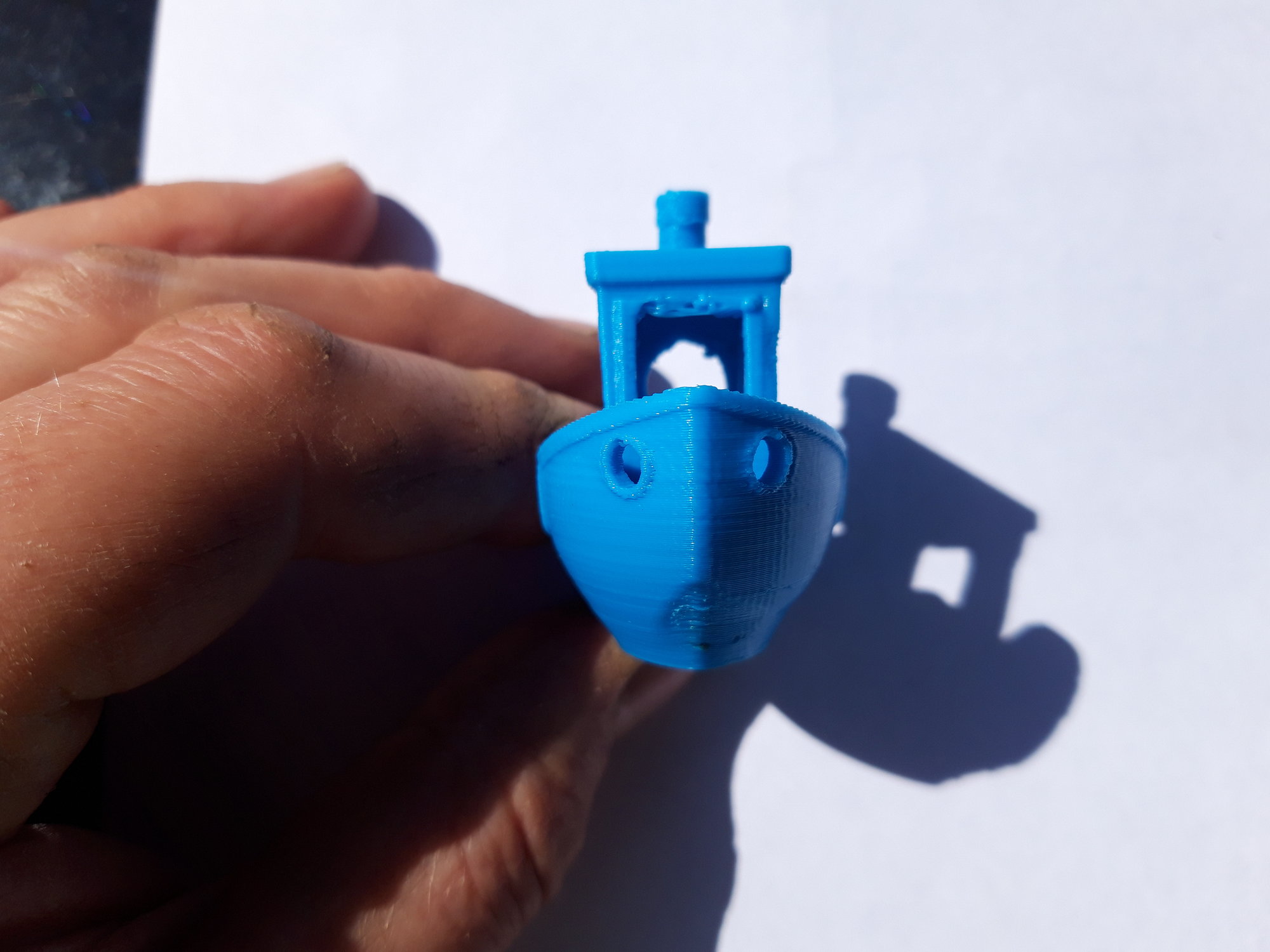

Thanks @tflnemesis , will try that link. I'm wondering if the extract fan position is wrong and too high up, as in taking heat away from the print area? You have I believe a similar 120mm fan you said but lower down in one of the corners, is that on the back or side of the enclosure?
We're limited with the enclosure sat on a desk as it is at the mo. Can't vent left or right or low down to the rear.
I might quickly knock up a ply "chimney" to go on the back wall of the case. The idea being that "damaging" heat from around the electronics and psu will be drawn in at the base through the "fireplace". Above the bed will stay nice and warm.
Hopefully it'll drag in any smell too.
No discernible smell last night whatsoever, fan on & using Steadytech ABS Pro.
