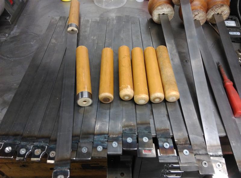

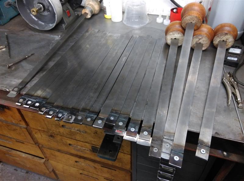

I dislike the Sandvik scraper as they are a bit on the stiff side but their scraping inserts are very good. You can buy the 25mm x 3mm steel shanks from Tilgear you'll get enough for £20 to make 10 scrapers:
Here's how you make them:

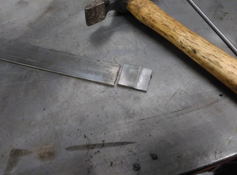

Mill a 1mm deep relief about 8-10 mm wide in the end then cut it off

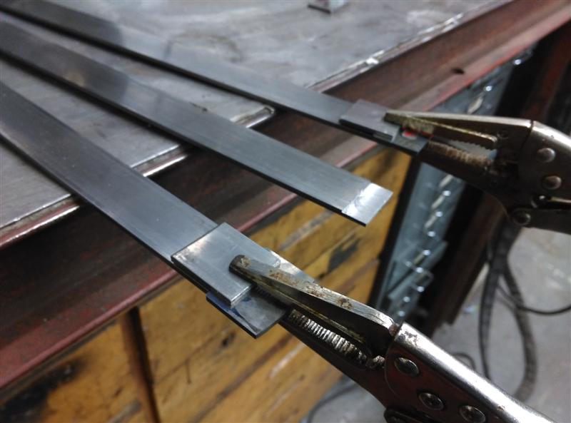

Now mill a relief in the end again. Clamp an insert between the pieces with mole grips.
Now weld along the back of the clamp then remove the insert before it gets too hot. Drill and tap for M5/M6 countersunk screws.
Easy peasy. You can cut a file tang the other end for a (large) file handle of I bought a big fat curtain rod from the boot fair for £2 and made handles from that.
I made all these in an afternoon.

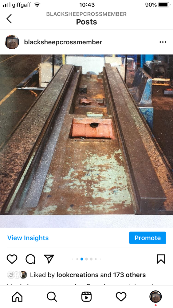

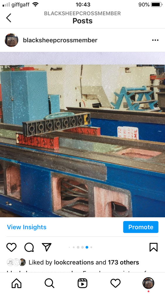

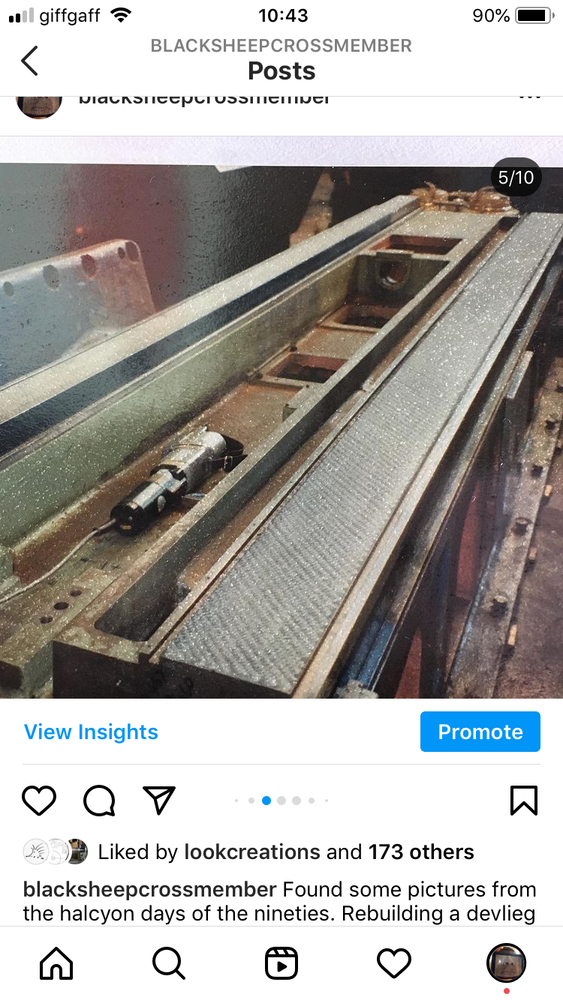

I think Lookcreations on YT scraped in his Holbrook lathe bed with a straight edge shorter than the bed but it didn't look fun!
Thats interesting, looks like the true edges are the most expensive and hard to locate part in all this
How is it possible to avoid runout from one end to another with a straight edge shorter than the lathe bed?
You use a precision level to scrape longer than the straight edge. You can loose control with a long straight edgeThats interesting, looks like the true edges are the most expensive and hard to locate part in all this
