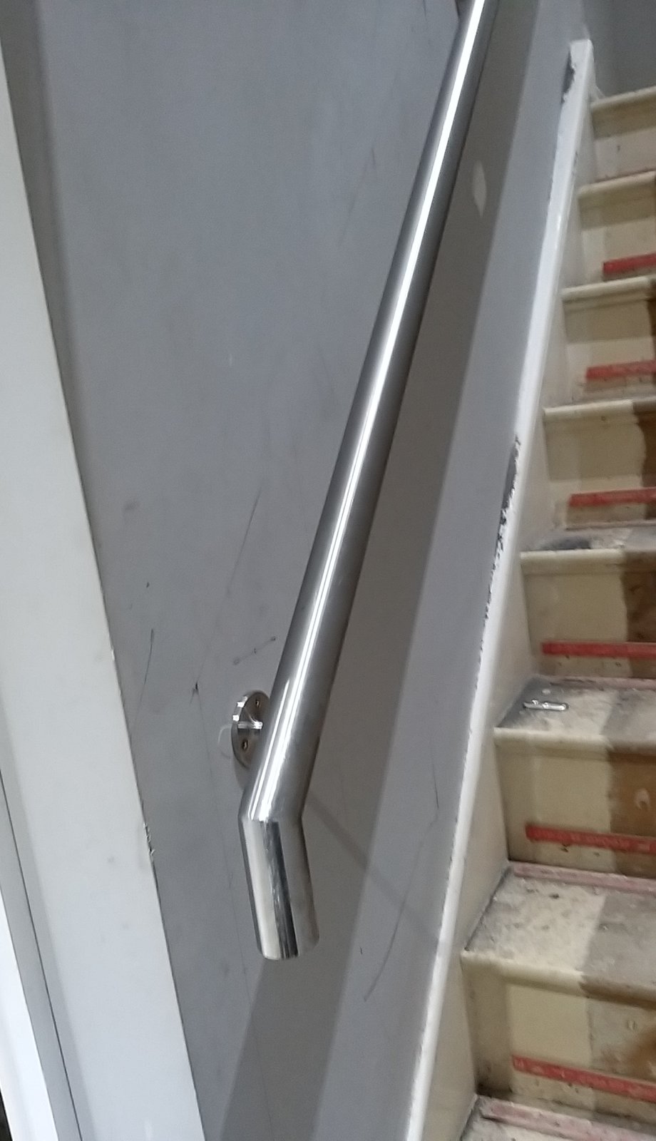

It certainly gave me a workout!10 out of 10 for neatness Sir. I should imagine the steepness will give the fixings a good work out.
Thats a good question! The customer supplied all the parts and materials and asked me to just turn up and make something. He pulled the hand rail tube out of a building site scrap metal skip!!
It came complete with paint speckles and cement blobs stuck to it.
He’ll ring you up on Monday and ask you to take it off and fit it on the opposite wall (‘Client change’/set it out wrong)

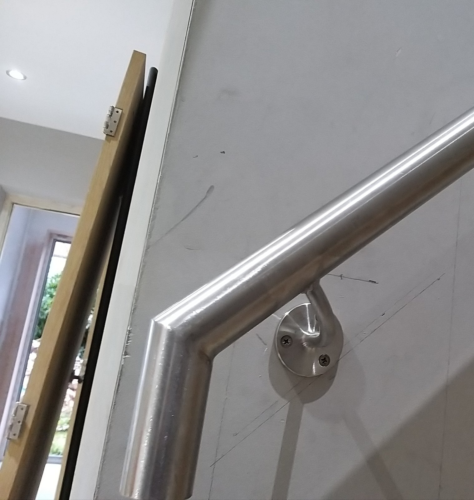

Flap disk for most of the work but I borrowed a hand held linisher to re grain. You can re grain with emery tape and a scotch pad but obviously slower.
