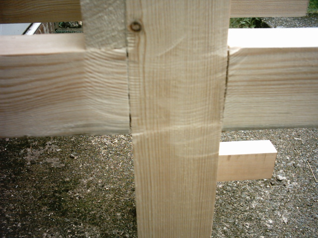

I am interested in buying a belt sander-the hand held type not the fixed bench type. I can sort out the brand I require, but would welcome advice on whether these machines would help with what I am doing.
It would be used on timber to sand over the joints. I made some lap joints on furniture. I am not a joiner and it shows by the standard of the joints. So, I ran the angle grinder over the end of the joints using fibre sanding discs and the joints look fine now. The only problem I have is the round marks on the wood where the sanding disc bites in. Even using it lightly with a fine grade disc will leave marks. So, would a small belt sander with fine grade belts get around this issue? If anyone has one and has used it on wood I would be interested to hear your views. Thanks
, a RO sander will clean that up as good as anything, a belt sander will just tear up the cross grain and you'd have to use a RO to finish it anyway.
Some basic tools that can help you cut these joints accurately, every-time, are; a marking gauge, a marking knife (stanley), a square, tape measure, tenon saw and a good bench area.
