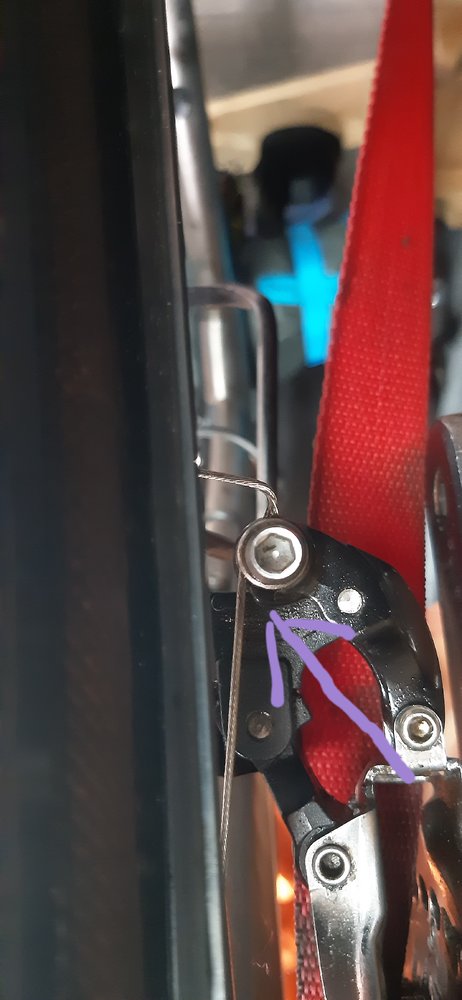

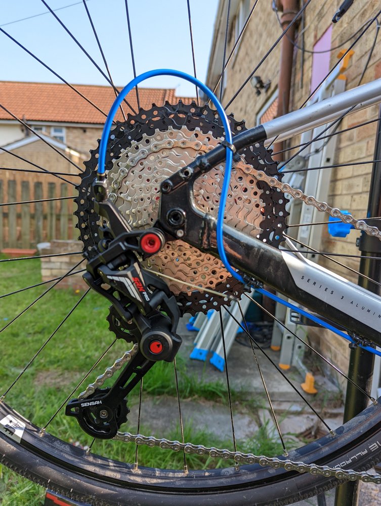

I did that. Bent the hanger on my nice new mountain bike, and bought a spare off Cube. Then straightened the old one and carried on using it. Guaranteed to never need another.Thanks for the offer, I've ordered the Amazon kit, which means the new hanger will probably still be in my spares box long after the bike is replaced
3D scan it, draw a copy up in AutoCad, print off a 3D printed copy, scaled up by 3%, sand cast it in alloy, machine it to the right size and then Helicoil it. Voila!![]()
Rod > back springs to mind
The problem running a tap through stuff like that is it will just cut new path, you may get away with an M10x1 thread restore tool as they aren't designed to cut new threads just reform/clean existing ones
I think the picture is for illustration as it say 1.75

No the ones that look like this.Are you thinking about the ones that loop round under the seat tube clamp, then go back up to the mech? If so yep they do look odd![]()
My old bike wouldn’t select lower x2 gears on the rear cassetteCertainly worth investing in a derailleur hanger alignment tool, it's surprising how far out they can be.
They’re designed to fail. Lost count of the ones I’ve replaced over the years on bikes we’ve had. Doesn’t take much for them to fail
