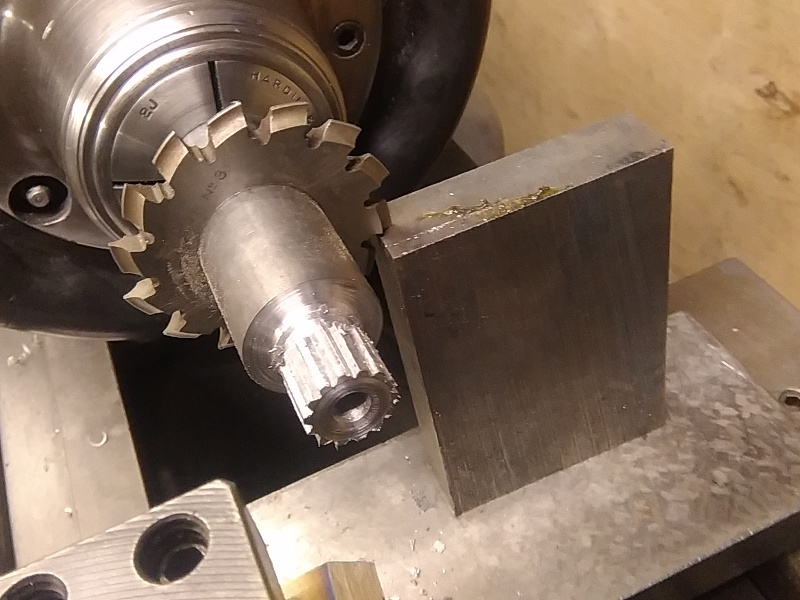

I counted the splines and made my best efforts to measure the diameters considering the bolt was deep in the well on the wheel. Then I had to find something for indexing to cut the splines on my lathe. Turns out I had a gear tooth cutter with the correct number of teeth so I used that.

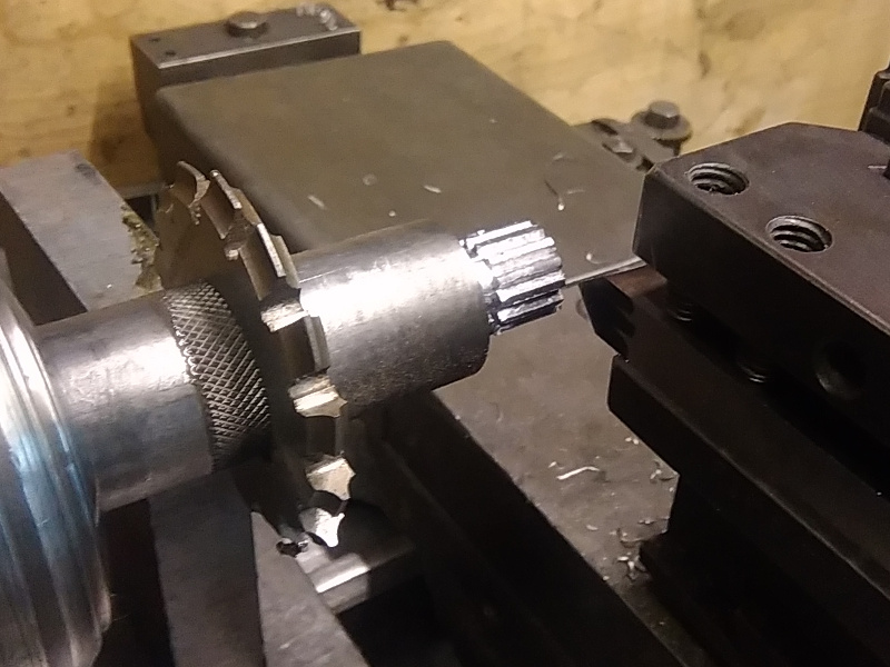

The cutter has a 1" bore and I had some 1" BMS rod so I put that in a collet and knurled it to raise the OD somewhat. Then I tapped the cutter onto the knurl to grip it and found a couple of bits of cast iron to rudimentary indexing.
I turned the spline OD in the bar, machined a relief groove then made a tool to cut the splines. It's just a normal lathe bit ground 45 degrees each way to make a 90 degree cutter. That was put in the holder on it's side. Once it was set up all I had to do was use the cutter with the lathe motor turned off, all the cutting being done by hand-cranking the saddle up and down using the cross-slide to make a series of 5 thou cuts until I got it to depth.

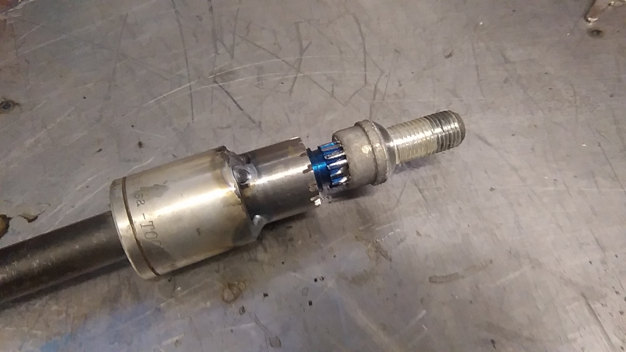

Once it was cut I parted off the bar and welded it into an old 1" socket. After a couple of false starts and a bit of relieving with a 5" grinder I was able to bash the home made tool into the locking wheel nut and remove it easily.
