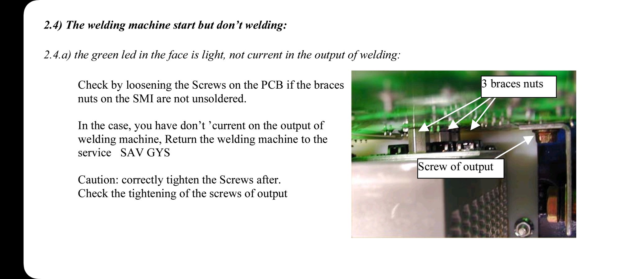

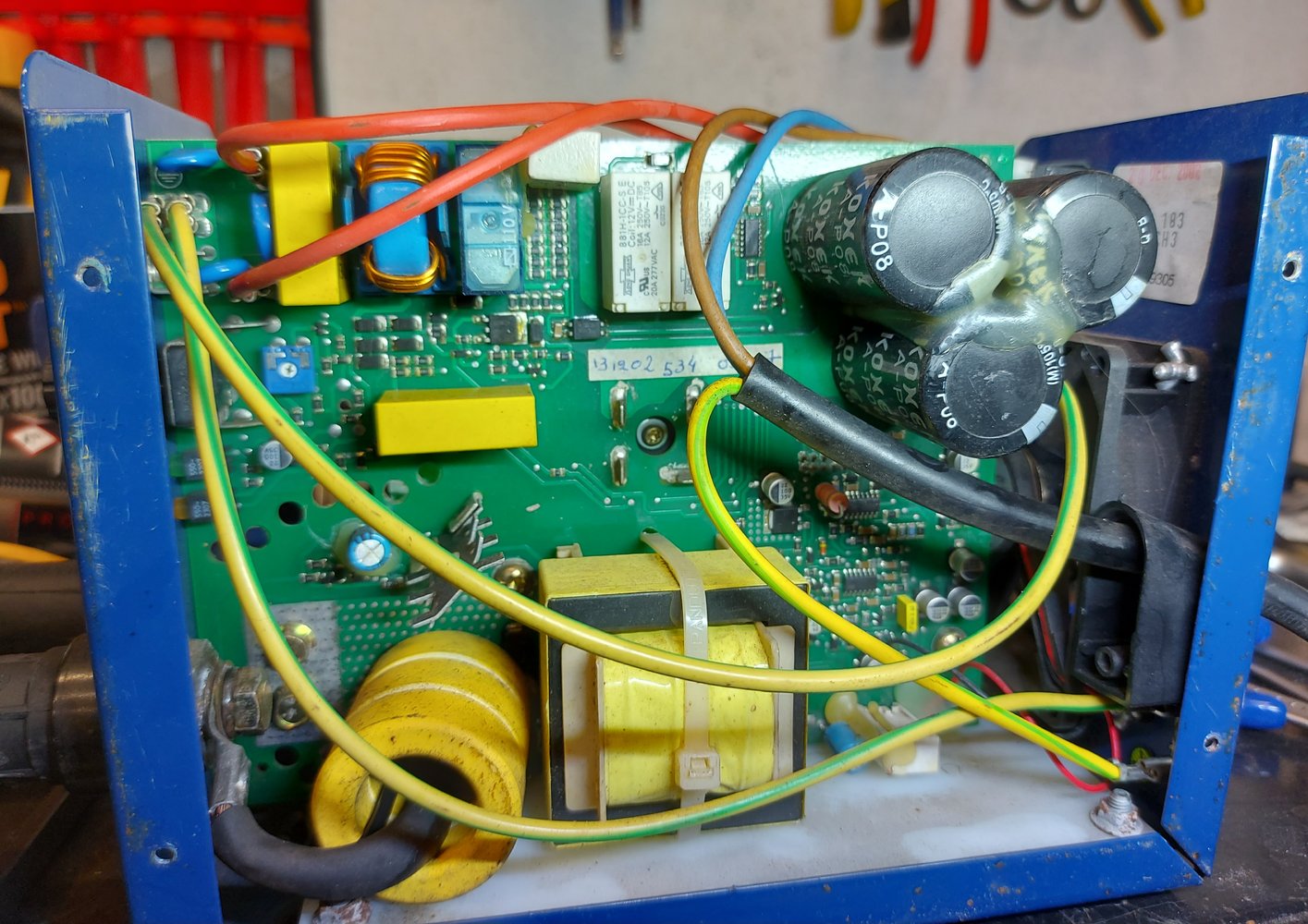

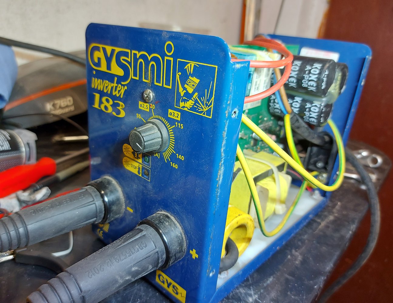

Picked this little guy up last week. In non working condition.
It does turn on. LED on. Fan spins. Adjusting the power dial can hear electrical differences inside so it must be adjusting something.
But - it won't weld. No sign of an arc. I have removed and cleaned the welding cable to board and no difference. Both sides test zero resistance to board.
I am aware this is my second dead welder. Apologies in advance.. but this one seams like it should be easier to repair I hope.
Its a nice little made in France unit. I sure would like to fix it and keep it.
For a fault like this is there a particular area I should be checking please?
Leads are new and tested on my other welder. Metal clean etc so it's not a fault on the hot end of things.
