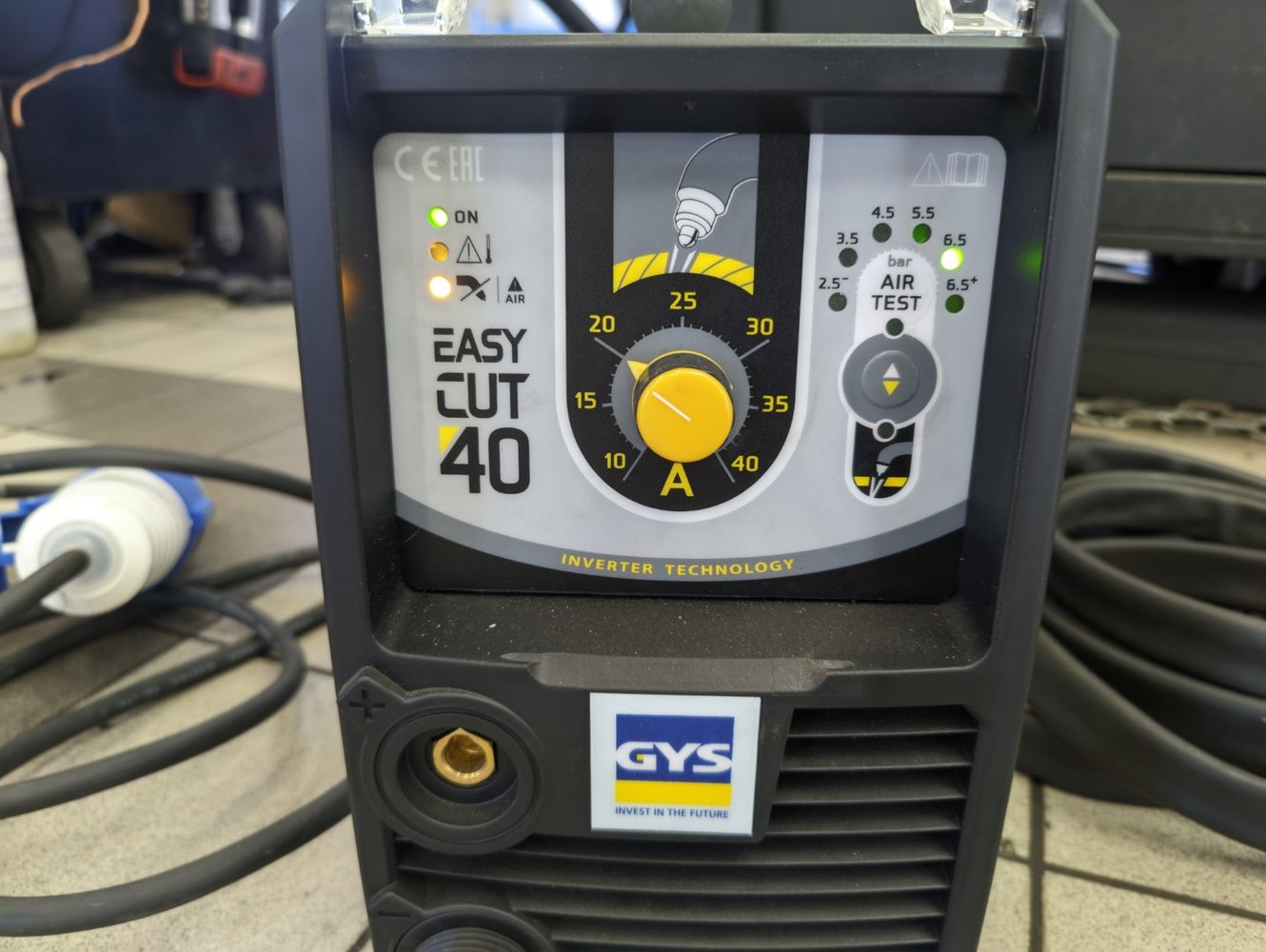

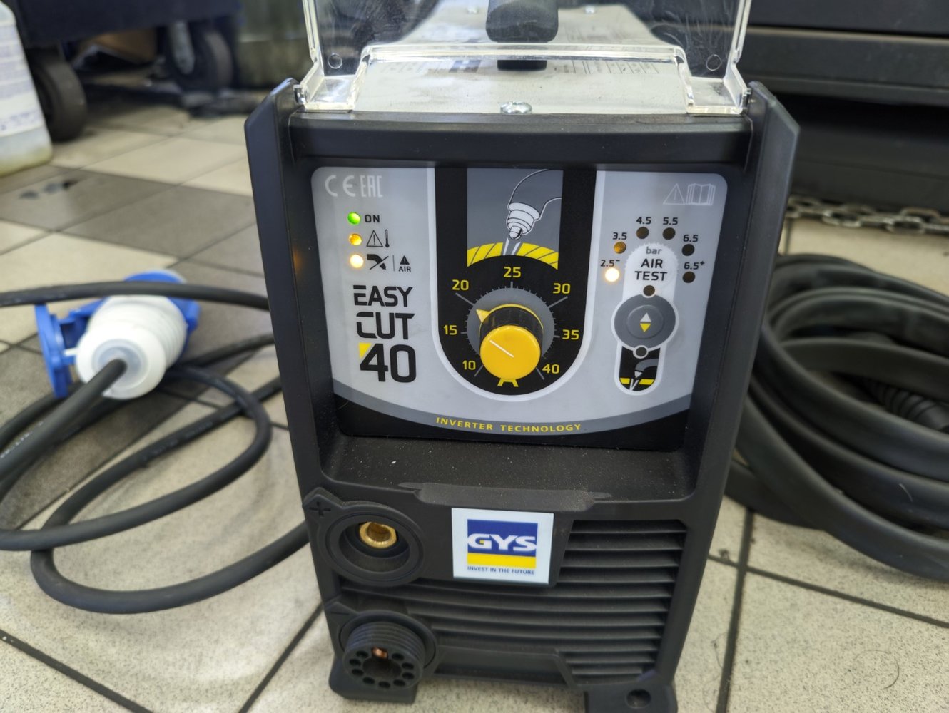

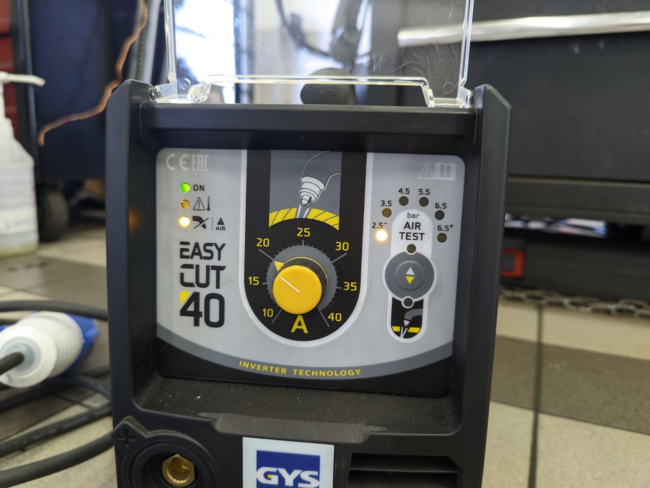

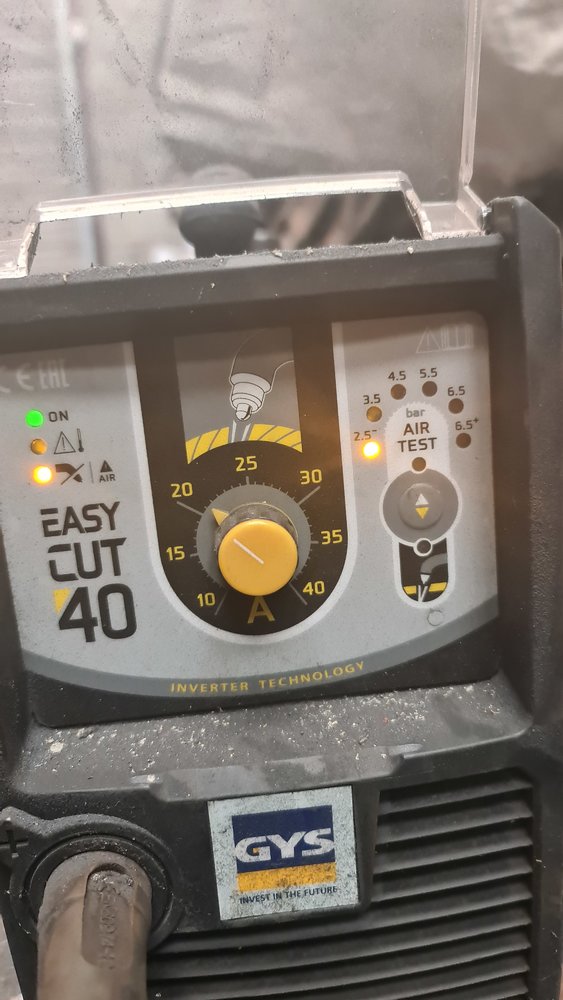

A customer on a sculpture class was happily using it one day.It was working fine last week.
I came to fire it up today and nothing.
Does the usual diagnostic routine but orange instead of green lights.
Lack of air?
I tried it on a neighbours compressor and got the same display.
I've changed the electrode and nozzle.
Air test button does nothing.
Any ideas?
I do have two types of consumables that only work in pairs but it was going find on what's fitted a few days ago.
