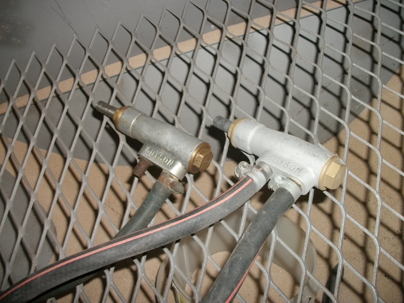

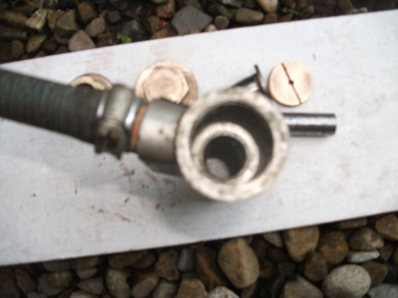

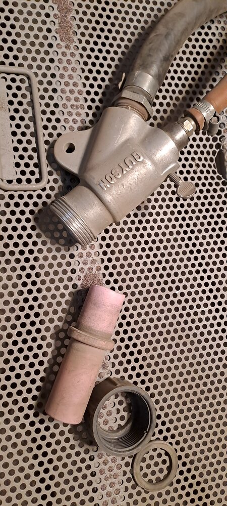

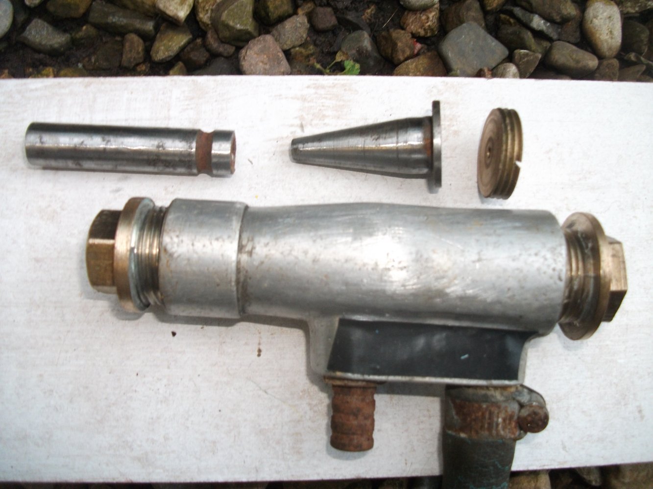

My ceramic nozzle is shot, seemed to last forever, then has gone a bit lacklustre. It used to have a 8mm ish bore, now is 19mm so no wonder!!
The guyson site is no help and I remember folk saying that they were unhelpful and hidiously pricey so I thought maybe a generic replacement gun might be the best way to go. Anybody recommend one, my current air nozzle is about 3mm, 8mm ceramic. 2 compressors 3hp& 7.5hp happily hold at 90+psi when blasting.
Or does anyone know a source for the guyson type ceramics?
