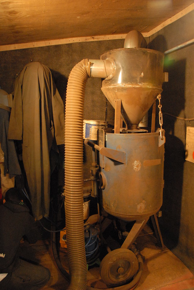

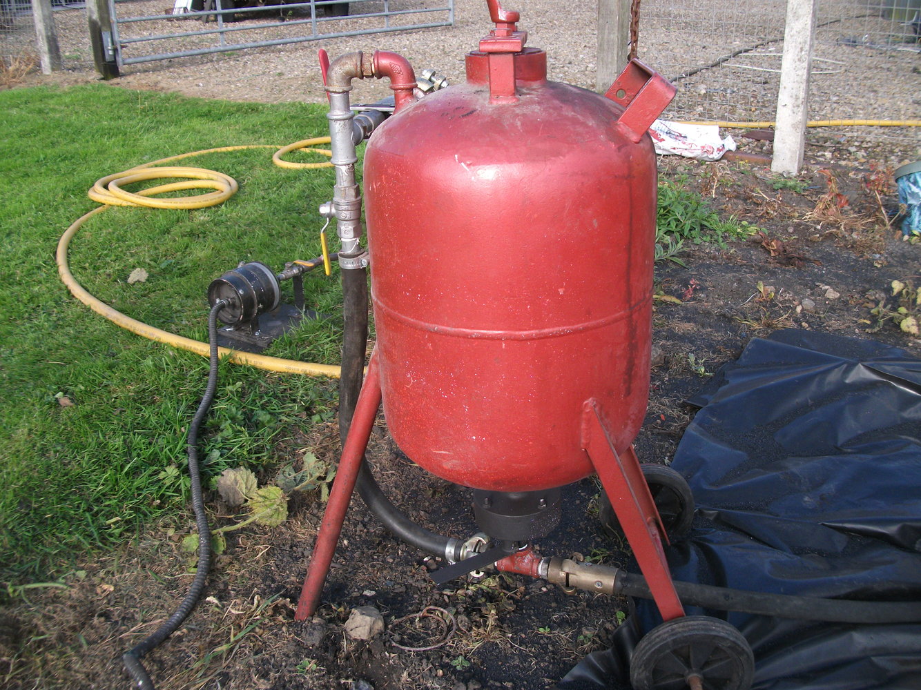

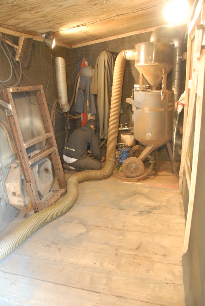

Yes, that’s the one I closed about half way. The more I close it the more powerful the gun becomes but also the longer the air takes to escape from the pot when you let go of the foot pedal. The air drains through the gun rather than through that top pot outlet. Not a problem really though. I guess if I open the media mix valve more I’ll want to close the red handle more to help force the extra grit through. Can use it closed to help unblock the gun too possibly.
Do you know how much media I should or can have in the pot? 1/3 of the volume? 1/2?
Will be interesting to see how it works out on longer blast runs.
Thanks
Thanks
And that's sucking up heavy steal grit not the expendable media which is lighter.
