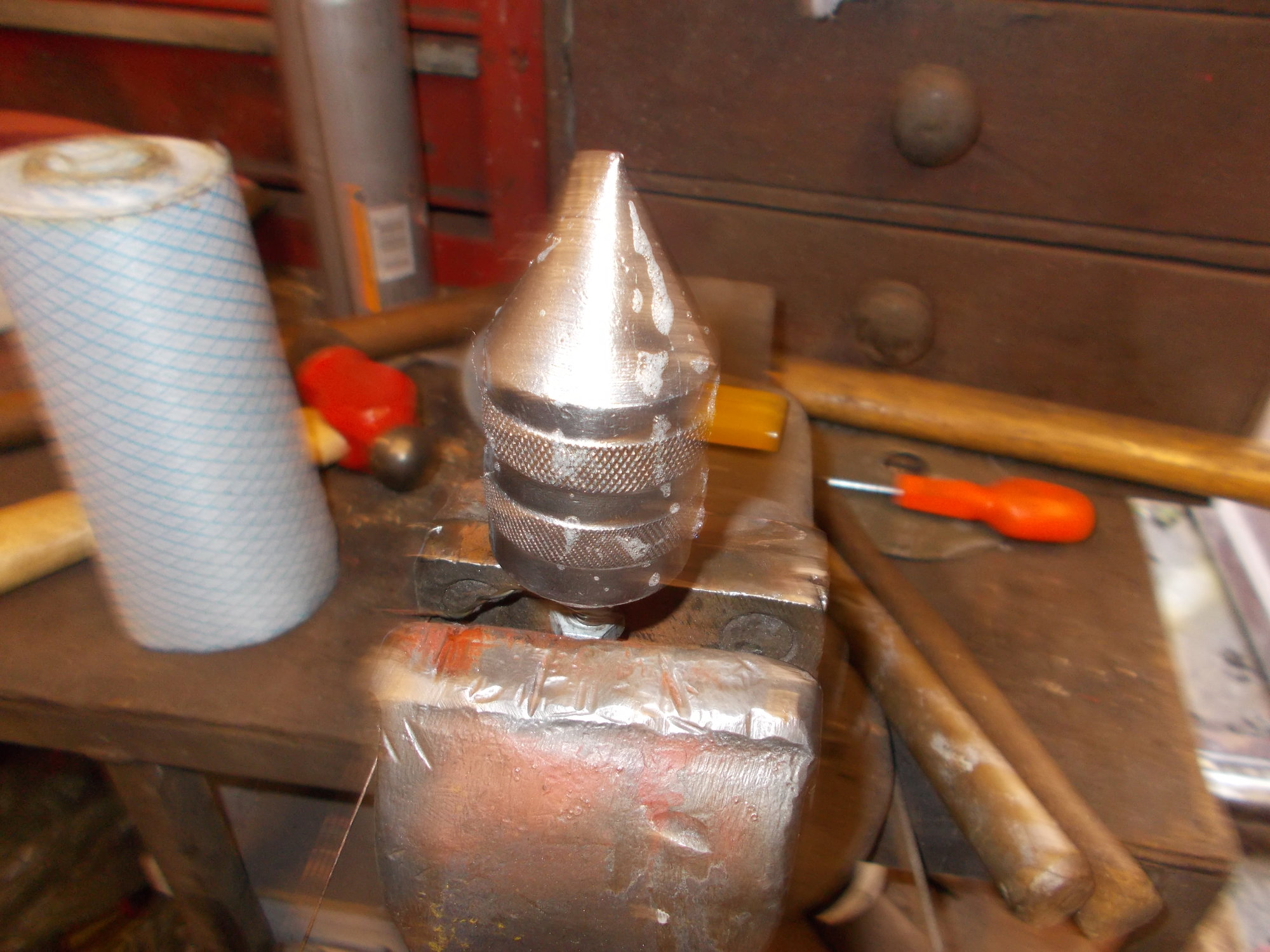

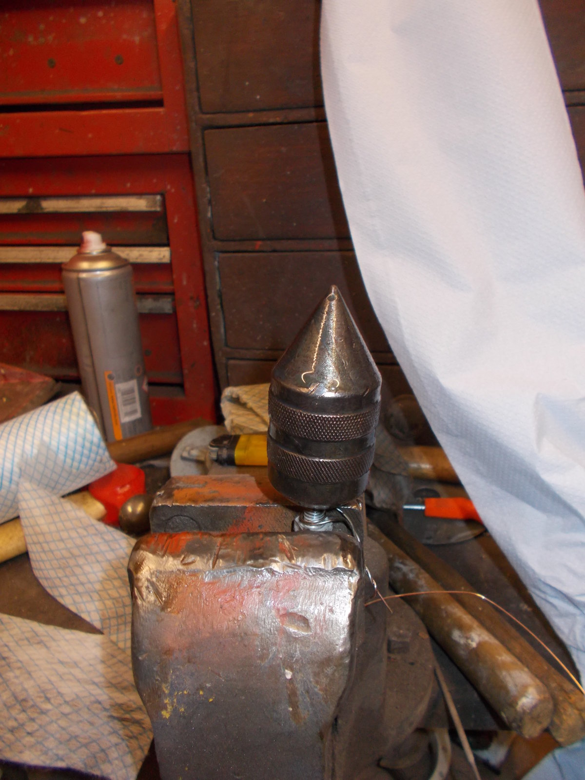

The experimenat No 1.
Plump bob.
Cleaned up again.
De=greased using nail polish remover. Borrowed from Mrs TYA (6 years ago, I must return it soon)
Then using a rag I wiped the blackening solution over it. Again Instant colour change. Then sealed with a hard wax.
apart from a run. I got the result I was hoping for. Soft wax next time.
Plump bob.
Cleaned up again.
