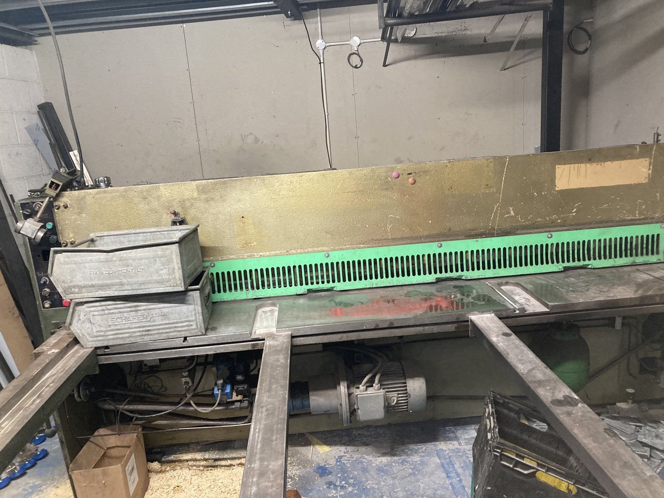

I’ve got an aging safan 2500x4mm capacity guillotine currently. I got it cheap and have abused it for 4 years! Probably owes me around £2.5k including a few repairs it’s had
It really now needs a set of new blades as the current are past sharpening (I need to check if I can rotate them) and it’s refusing to cut full width and it’s leaving bad burrs In the parts it’s cutting.
It needs work to the backstop as there’s play in parts and also broken parts from previous abusers and the chain and sprockets are worn meaning it runs out across its width. Also the backstop is motorised but there’s no readout or controller
Really to get it upto good condition I would be looking at about 3k plus
