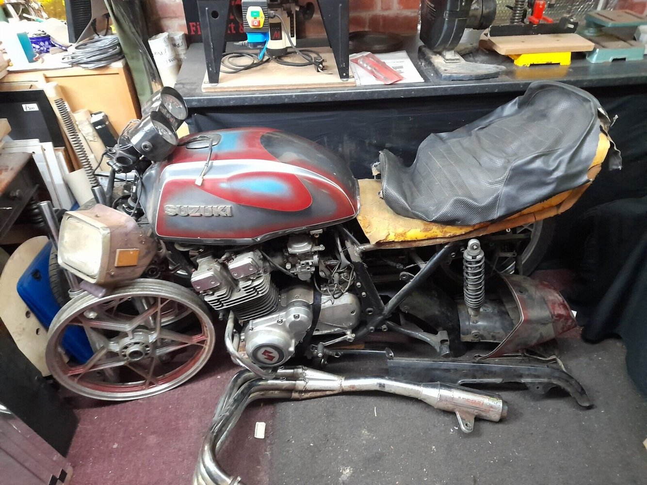

great job..I was very surprised at how these bike frames can be under tension when cutting sections out, one of the 1st i done it sprang out like a snapped bow string because i never temp braced it like you have done to yours. Now i also weld in braces before i cut too.
Worth knowing that for when (if) I ever get back to my cafe racer project!
