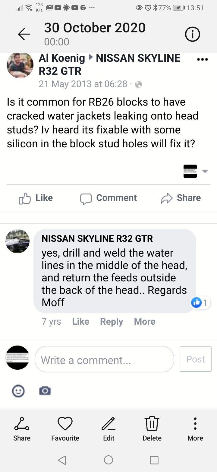

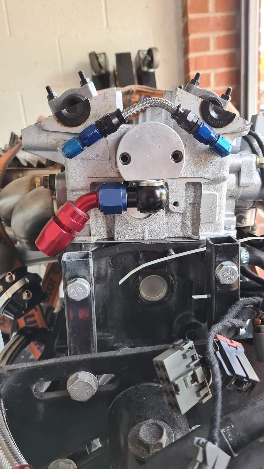

WE have got a photo of what we believe the mod looks like externally but not internally.View attachment 257209
The mod in the center we know all about as its a oil return but would not allow oil into the water.
Its the mod between the two sides of the head that we are trying to get info on.
If the head is cracked internally between the water jacket and oil ways we have been quoted 650 plus vat for a repair.

Anyway main priority now is to identify the fix for the head if it looks like its leaking between the water jacket and oil ways
