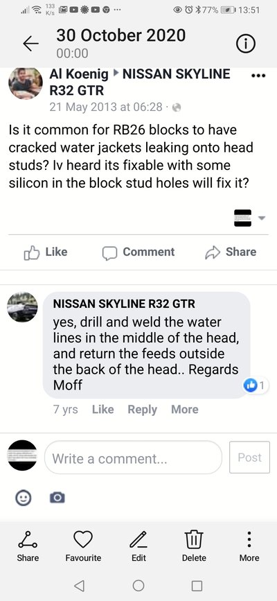

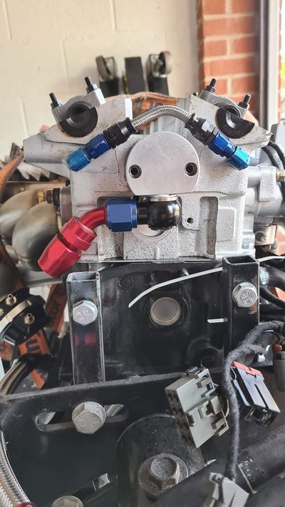

WE have got a photo of what we believe the mod looks like externally but not internally.
The mod in the center we know all about as its a oil return but would not allow oil into the water.
Its the mod between the two sides of the head that we are trying to get info on.
If the head is cracked internally between the water jacket and oil ways we have been quoted 650 plus vat for a repair.
But as I think I have found another price rip off (will post that in the other thread.) I can see why they mention a GTR tax.

Anyway main priority now is to identify the fix for the head if it looks like its leaking between the water jacket and oil ways
