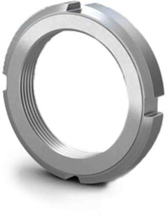

Got a couple of these to remove on my saw gearbox they look like this for anyone unfamiliar with them I was!

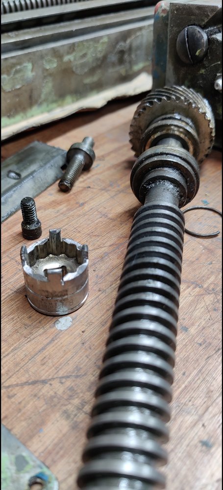

There’s a couple of different sizes on it one is in a recess. I’ve tried to drift them round but that’s not working I’ll need to torque up properly on reassembly anyway.

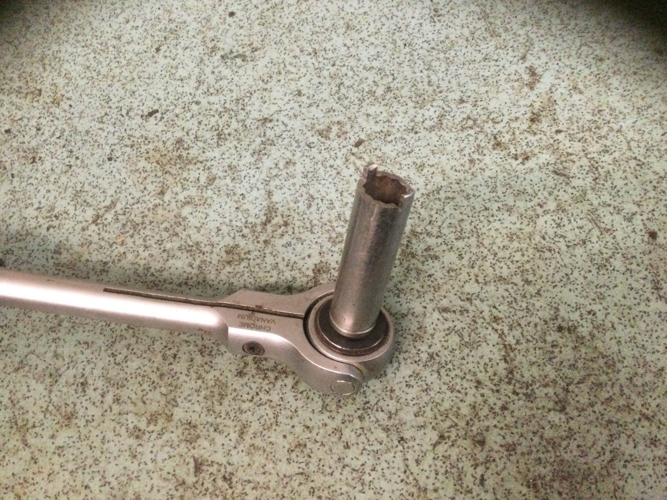

I guess my other option is to cut about an old socket
