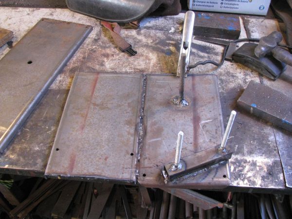

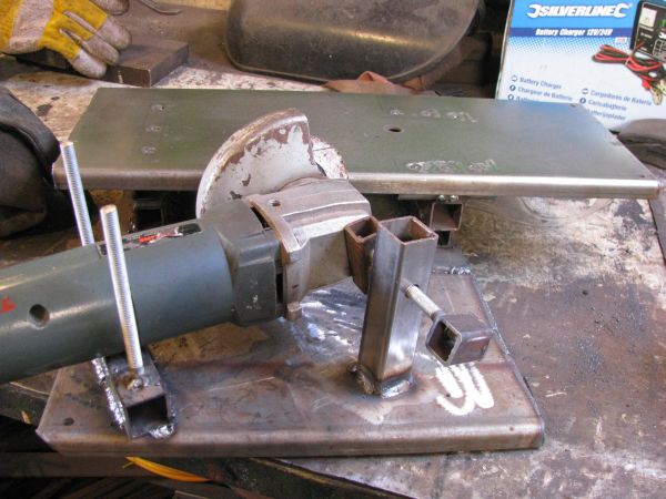

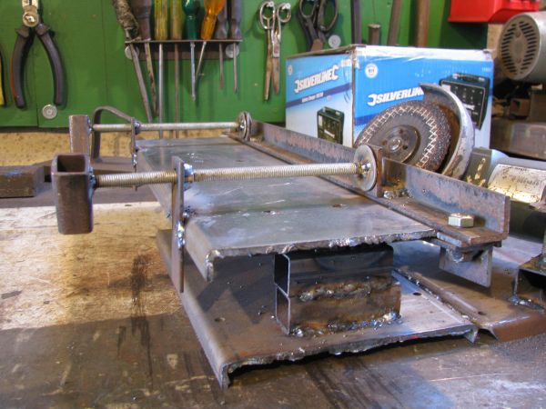

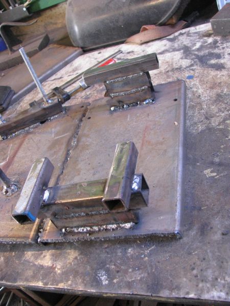

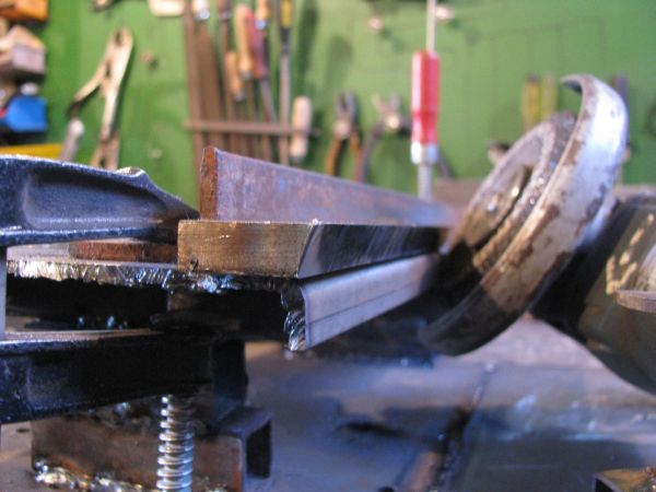

Hi,
I need to cut some strips of 6mm MS and have them to a reasonably accurate width, various widths too so it's not easy to simply buy it in...
also I wanted to put a fairly accurate 60 degree angle on some of it, and on some 10mm MS. Three of these needed to be as close to 'spot-on' as I can get it as it's to mate up with 'ways' and 'cross-ways' on the lathe that I'm starting to re-build.
So I looked at making some sort of jig, maybe similar to a router table as used in woodwork.
I had a piece of plate that came off a pallet at work, around 39" x 8" and 5 - 6mm thick. This cut up nicely into two pieces around 12" long to make a base and the remainder, around 18" would make the table. A grinder could be lightly clamped over to one side of the base, and angled so the workpiece missed the guard. I could then twist the grinder to get the angle on the piece.
That was the basic plan and making it up as I went along, I did this...
![table1.jpg table1.jpg](https://www.mig-welding.co.uk/forum/data/attachments/12/12207-e1c1c782173e08e1230904a3fa80e49f.jpg)
![table2.jpg table2.jpg](https://www.mig-welding.co.uk/forum/data/attachments/12/12208-e21501c2856016594618164e0066ee61.jpg)
![table3.jpg table3.jpg](https://www.mig-welding.co.uk/forum/data/attachments/12/12209-49de032b919742b43543305ed7a259ed.jpg)
![table4.jpg table4.jpg](https://www.mig-welding.co.uk/forum/data/attachments/12/12210-dfa369ae593583ca97e19e67c0b21090.jpg)
![table5.jpg table5.jpg](https://www.mig-welding.co.uk/forum/data/attachments/12/12211-e755b5bb90a9089194d95d613eaeccd7.jpg)
Initially I had a piece of angle for the work-guide and simply clamped in in place. But then I thought I could do better and came up with a clamp at each end with 13mm bolts. Also a couple of threaded adjusters where I could move the guide by around 0.5 mm at a time to take shavings off the metal with multiple passes.
