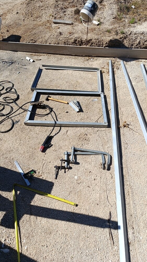

Loaded my Fakita batteries, my old and thrusty little Stamos S-MMA 250, a square and tape measure in the trunk.
Arrived in my property at 9:30AM
Deburred all the parts previously cut with my Makita cut off, connected the welder and had a go.
I've used old 2.4mm E6013s cause easier on zinc coated since it's not something that requires a lot of strength.
Roughly 90A.
Struggled little bit at the starting of the rod but that maybe because of the zinc, or the rods most likely over 5 years old even though they are stored in a sealed container.
The welder worked fine no strange voltage drops.
And I felt pretty good cause I've used free and green power to weld something together.
