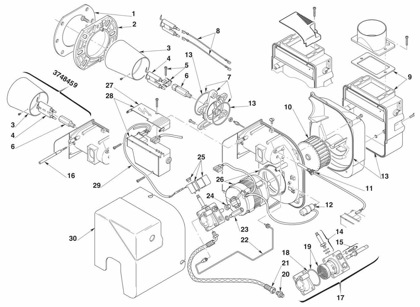

The value will be written on the side in uF or MFD. Around 3.5 or 4uF I think it'll be. They're plastic so if duff probably won't be obvious if blown as in split or swollen.
You will need a capacitance meter to check it. Shop around and you'll get a cheap multimeter for around a tenner that'll do it.
Capacitor something like this:
Worst case you might have to add some crimps on to the new wires or just join new wires to old with some inline crimps.
Riello MECTRON 40 4uF Capacitor 20087025 3005798 - Polish made - NEW - free post | eBay
Is your burner buzzing and not starting?. or locking out in the mornings?. or is it sounding slow to start?. These are made in the biggest capacitor factory on Poland - not the Chinese types.
www.ebay.co.uk
