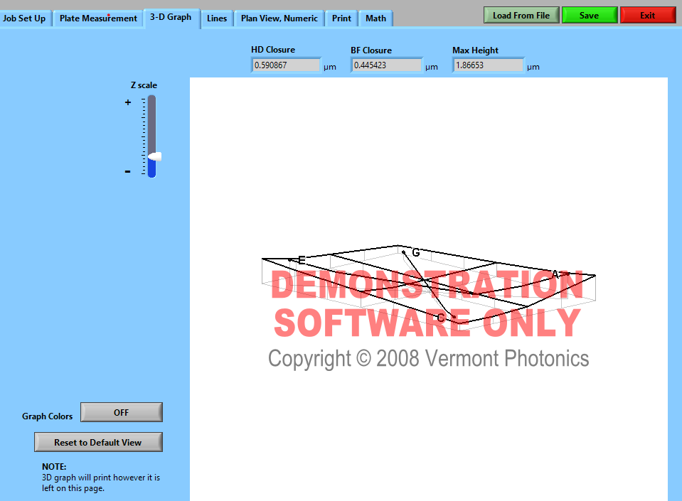

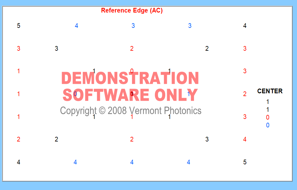

I'm gonna change my mind on this to say 'Not unless you're very experienced'. It's very easy to make a face which is apparently quite flat but actually has a fairly uniform dish, as I did today.
This is my 12" x 18" test subject.
I didn't get a 3d graph sceenshot of it but the figures make it to be no better than a grade1/grade B equivalent. It's low in the middle up to 4.9um on two corners.

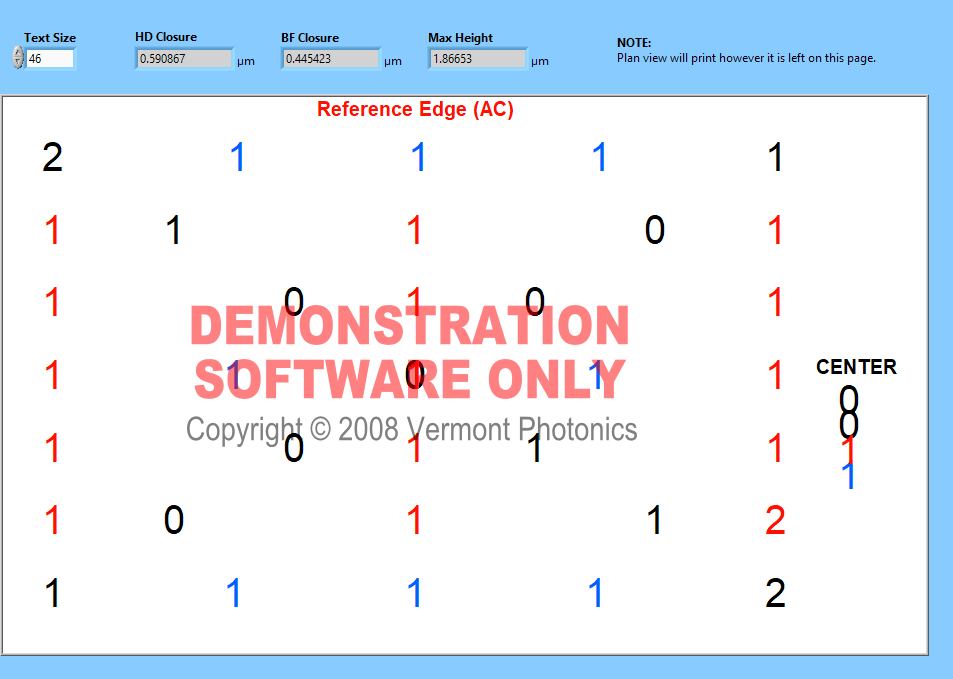

So I re-charged my lap and went over it again favouring the corners in an effort to bring them down without going too mad and rolling the edges. The result is much better.
This easily achieves the equivalent of grade 00 and just about makes the US grade AA for the size of plate. Very pleased with that.
Of course it's wholly unnecessary for my purposes but what the hell - it was my first attempt at re-finishing a plate. It doesn't even qualify for the specification which is why I say 'equivalent to' - there are stipulations that it doesn't achieve. That doesn't matter though I achieved my goal and got it from 20 microns deviation to 1.8um globally. I wanted to see if I could hit that spec and I did. I have found that it's quite easy to produce a Grade 0 plate but a 00 is a lot more challenging.
BTW it's so flat now that another plate placed upside-down on it will float right off the edge just from the air molecules not being able to get out from between the plates quick enough
