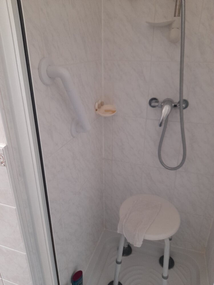

I didn't trust the stud wall when I put up 2 (a 42"/32") tv's in back to back bedrooms in my place, I cut the plaster board out on one side, inserted a wood/plywood in fill between the studs to fix to, refitted the plaster board filled and painted...
Depending on the required location of the handle, you could possibly create access behind a mirror and lower reinforcing/fixing panel into the stud wall, replace the mirror job done......
