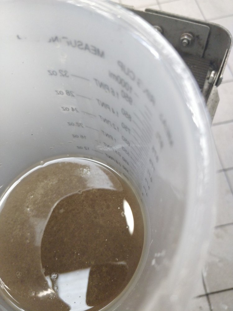

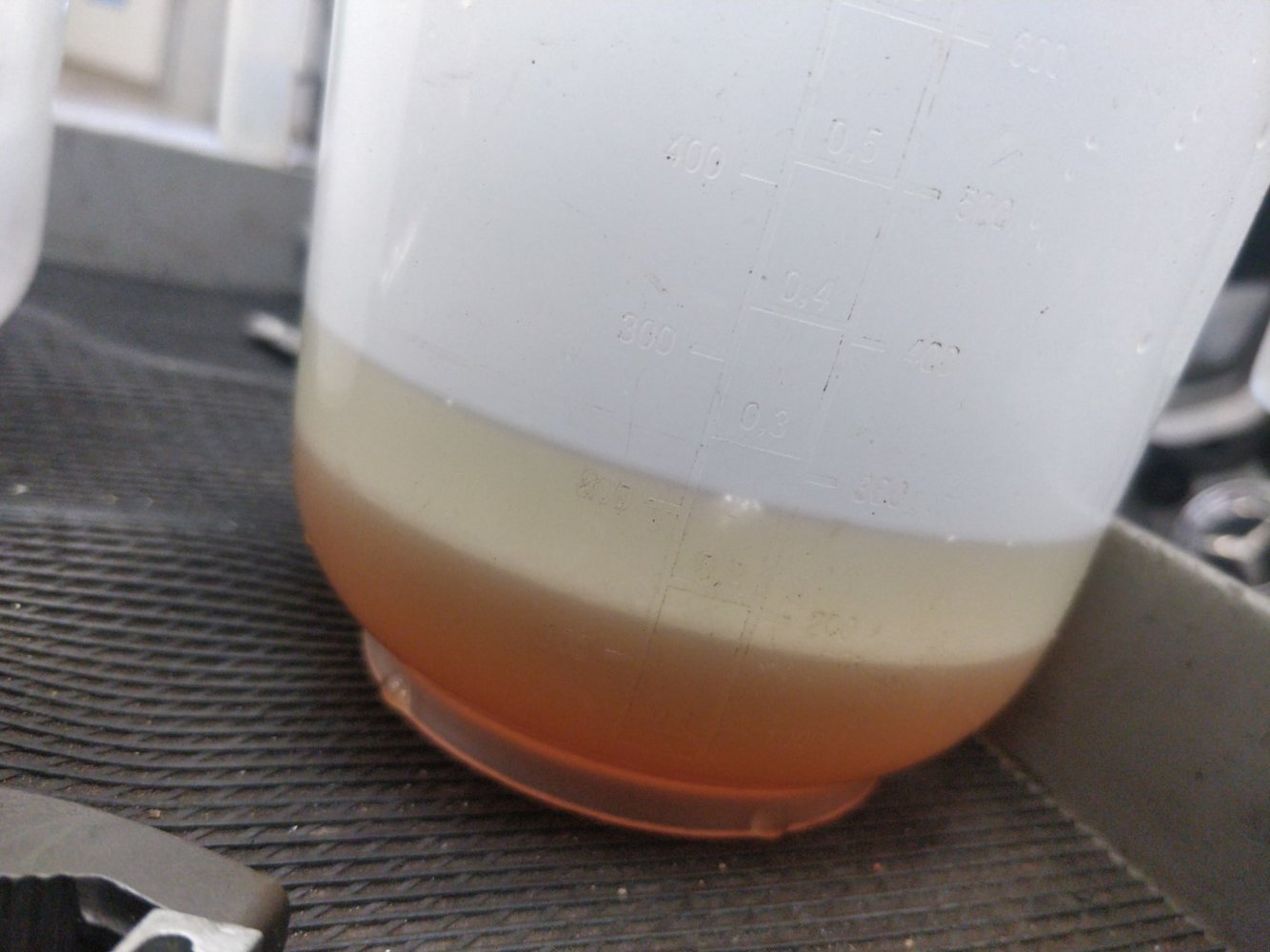

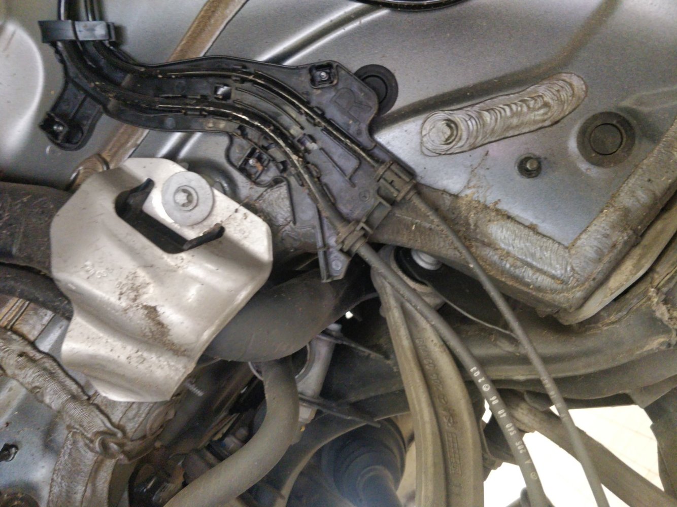

My Citroen BX leader was like that with a split tank.Here's the result of queueing for hours to get the dregs of the fuel at the filling station.....
View attachment 312141View attachment 312142

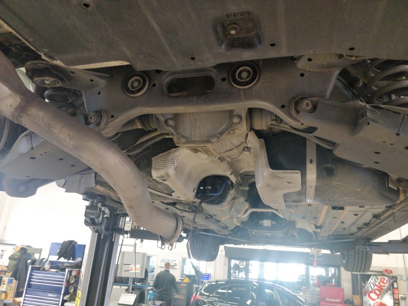

That was the third draining of the fuel filter, we recommended removal of the fuel tank, flushing & cleaning - otherwise the vehicle would go on warranty restriction.

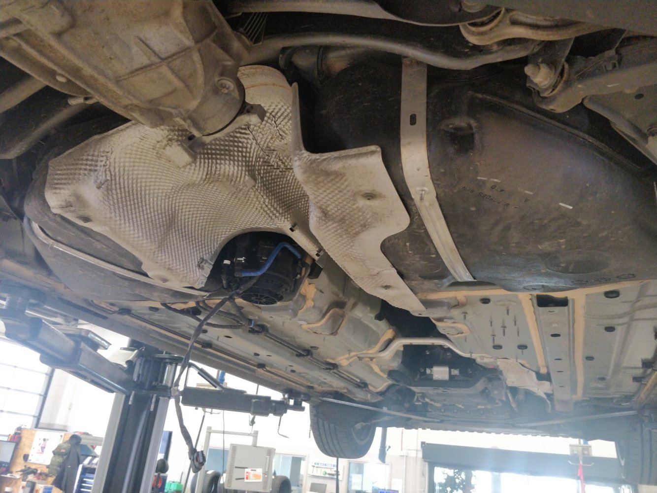

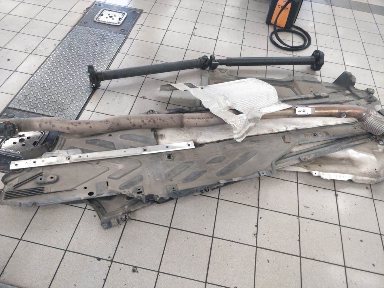

The fuel tank is a 'saddle' tank, so the propshaft & exhaust middle section need to be removed, along with all the underside trimView attachment 312143
There's the tank
Looks simple from there, right?
Wrong, the black pipe is the filler neck, bonded to the tank and rigid.
It sits between the bodyshell & the rear subframe, so that needs the brakes disconnecting and the subframe lowering, then you can get the tank out.
The rear diff is suspended from the subframe, all in all 7.3 hours including 1 hour to drain & clean the fuel tank. All for a bit of fuel which the driver (by his own admission) queued up for 'just in case'... It's not the first one we've had this week and probably not the last, the other was a petrol A Class on Motab, the driver was 'demanding' to know why there was water in his 'legitimate fuel from a legitimate filling station' and why it wasn't covered by warranty, even though he was paying nowt for the car and Motab were paying for repairs....
