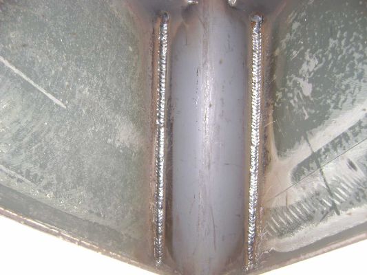

Got everything welded up today, started cleaning the gussets, will finish them tomorrow, and weld them in.

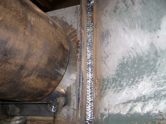

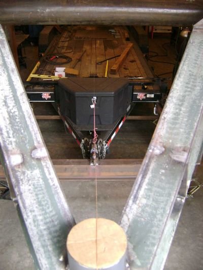

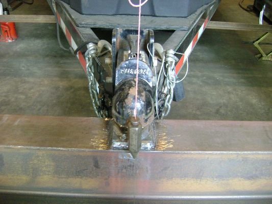

Just wanted to show how close I got the alignment of the gooseneck adapter to the trailer. Remember I had to use a torch to heat shrink the beams to bring the A-frame back in alignment. I have a nail driven in the deck at the back of the trailer right in the center, and used some staging as a batter board at the front of the trailer. Today I placed the string in the center of the Bull Dog gooseneck tube, and dropped a plumb bob off the string line to the bumper pull hitch. See the soapstone mark? Not to bad, what do you think? The last two pictures are of some vertical up weld using Lincoln’s L-56 .035 wire.
