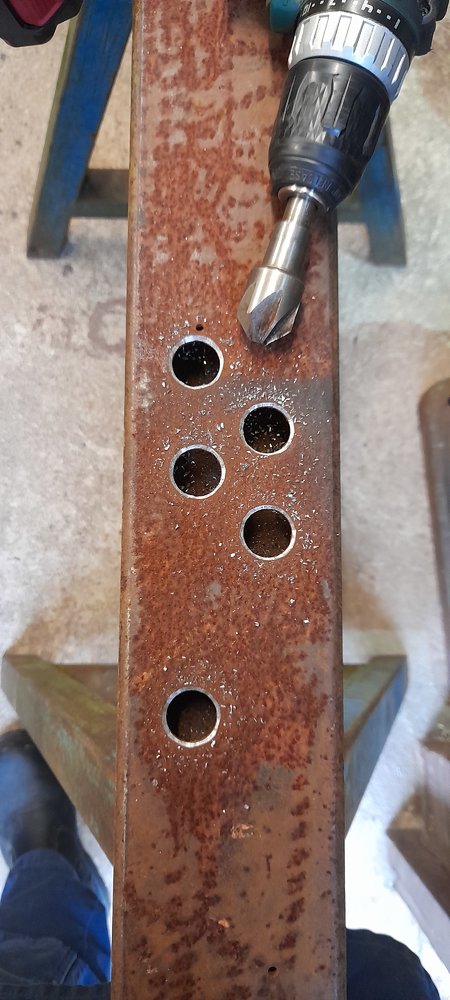

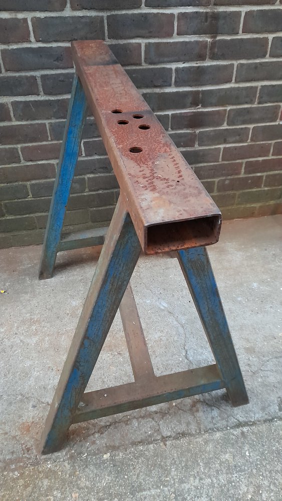

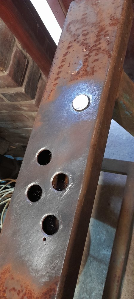

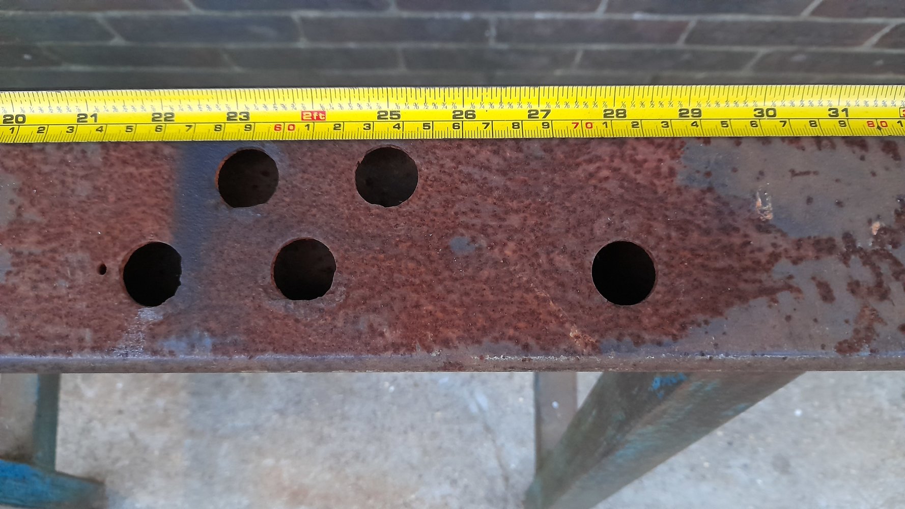

I'd put a piece of flat bar on it, you can go thicker if you wantI acquired this stand for my own use outside the home workshop. It needs to be fixed up and painted to make it look a bit more respectable. I'm tempted to weld plates to the open ends, and I definitely want to fill the drill holes. I'm tempted to cut a rectangular section from the top and weld in a repair plate. Or should I plug the individual holes somehow? 3mm wall. Looking for collective ideas. Thanks
That's another option, a good one tooI would slide a bit of 6mm plate into the box section and wedge it to the top ,then plug weld it in place through the existing holes. It’s a ten minute job whether stick or mig.
Bob
Cut some round bar stock the right depth drop it in the hole and weld round the top ! Grind it flush ! Simple

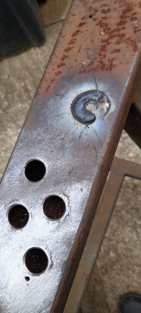

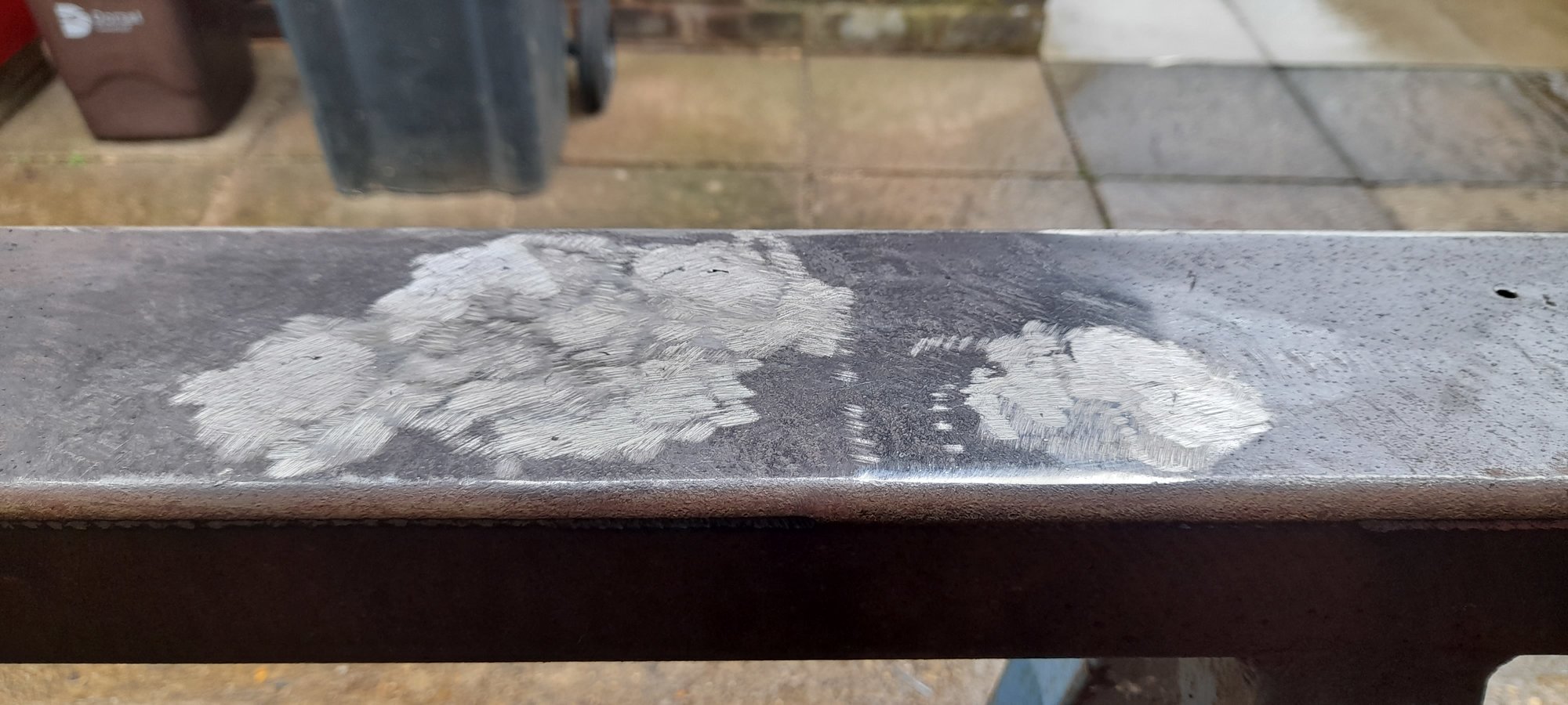

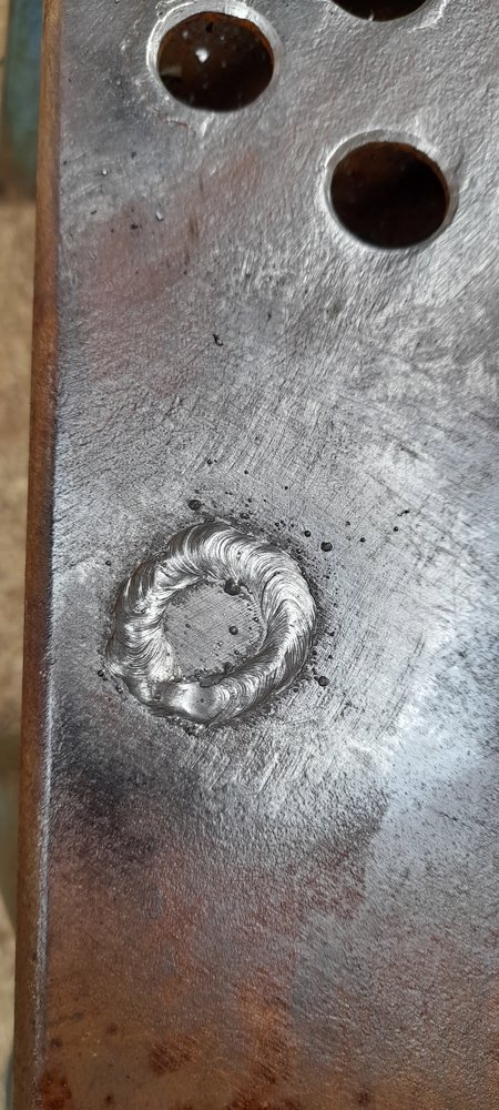

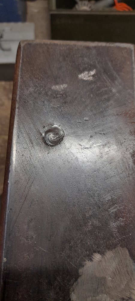

And the little hole on the right?Not perfect, but good enough. Gave me some badly needed practice welding with a circular motion.View attachment 467924
Not perfect, but not good enough. I need practiceweldinggrinding.
