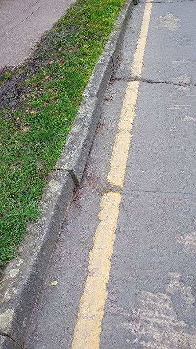

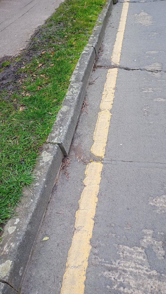

In my village, over in the new estate (1930-50's) there are concrete roads with what are known as suction kerbs, roughly 6" square section yard long concrete kerbs that were dropped onto the still wet road surface when the roads were laid, they are getting knocked out of place by dust karts, home delivery trucks and builders lorries and are very expensive to replace as we have to cut through the reinforced concrete road surface and set in new deeper kerbs at a cost of £13,000 for every 100 metres, that is a lot for a smallish Parish Council to cover.
So the question is:- with modern adhesives would it be worth trying to re-attach kerb stones at least as an experiment? what adhesive would the panel suggest? The kerbs must be able to withstand a sideswipe from a passing bin lorry etc. I understand the need to clean the surfaces.
