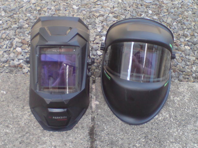

I got a Ginour mask a few weeks ago (and havnt used it yet) and since the Lidl ones are also at a bargain basement price, I got one of them today to compare, so first impressions
the Parkside helmet (on the left) is taller and narrower than the Ginour mask on the right, and the Parkside mask weighs approx 650g compared to 550G of the Ginour mask
In the light state, the Ginour mask on the left has a clearer and brighter image than the Parkside mask, but the Parkside make has a larger viewing area. also the parkside image has a green tinge to it, but not as bad as a non "true colour" mask. and the object though the lens is about 3m away

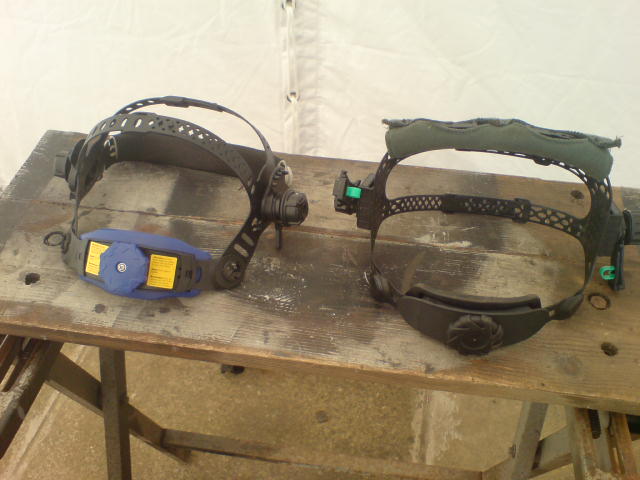

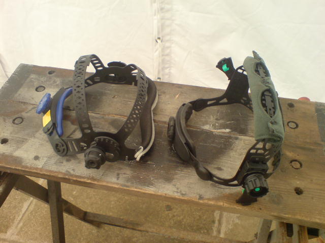

and the headbands, the Parkside one is on the left and the Ginour one is on the right. I had to take the headband off to take the second pic.
