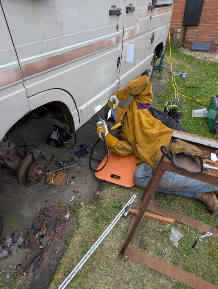

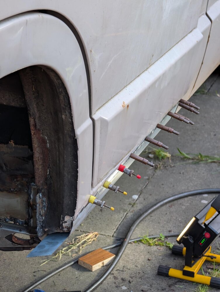

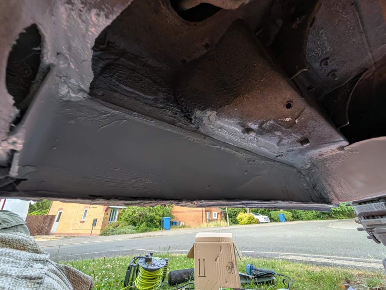

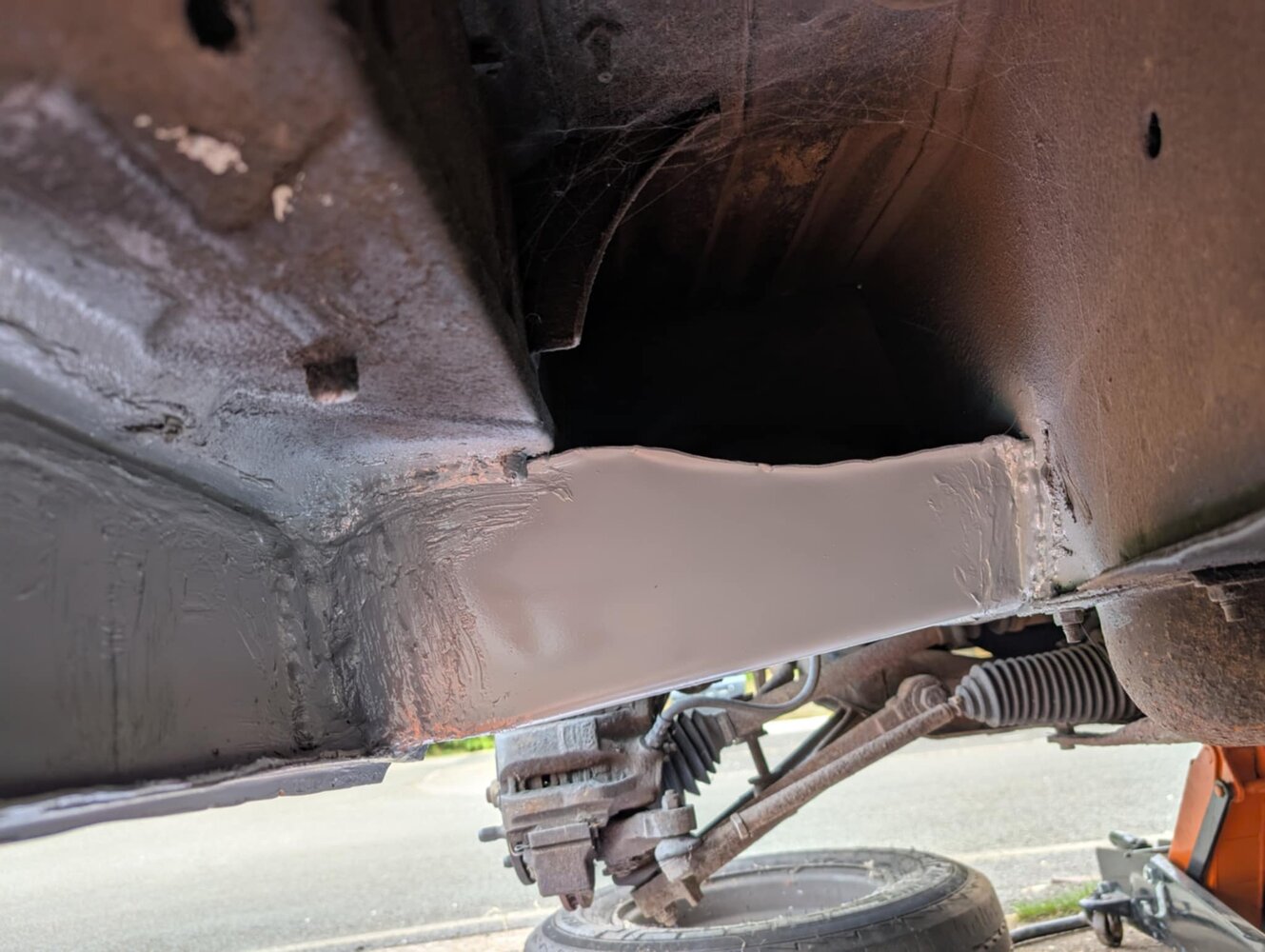

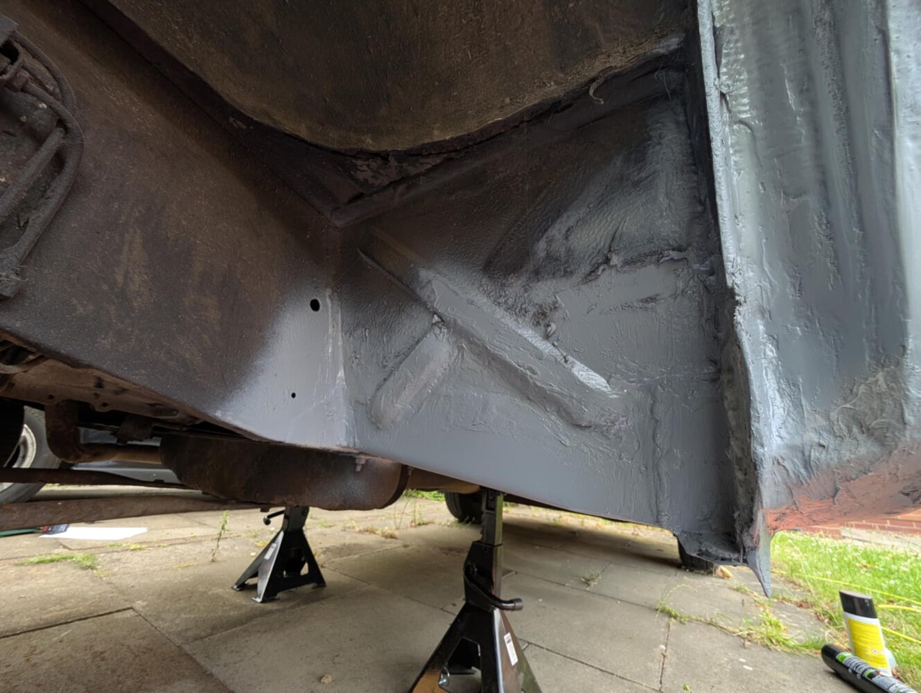

Outrigger in, I don't think my mate got a good photo of when it was fully welded up because I was trying to push on with the next stage of the repairs to get everything closed up today.

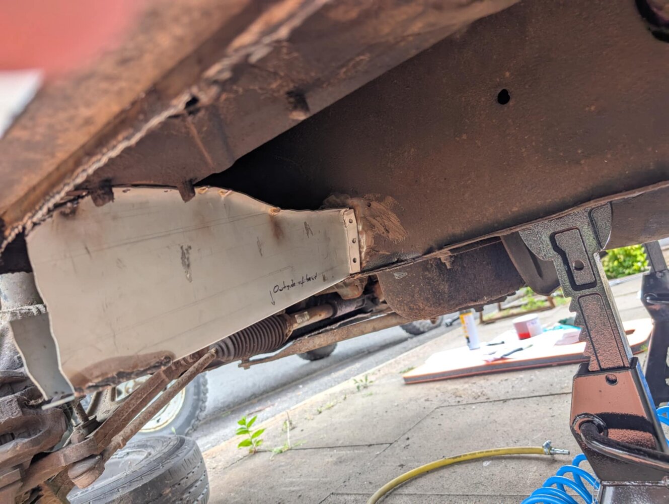

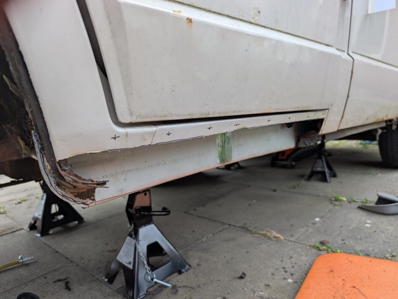

Making and fitting the inner cill.

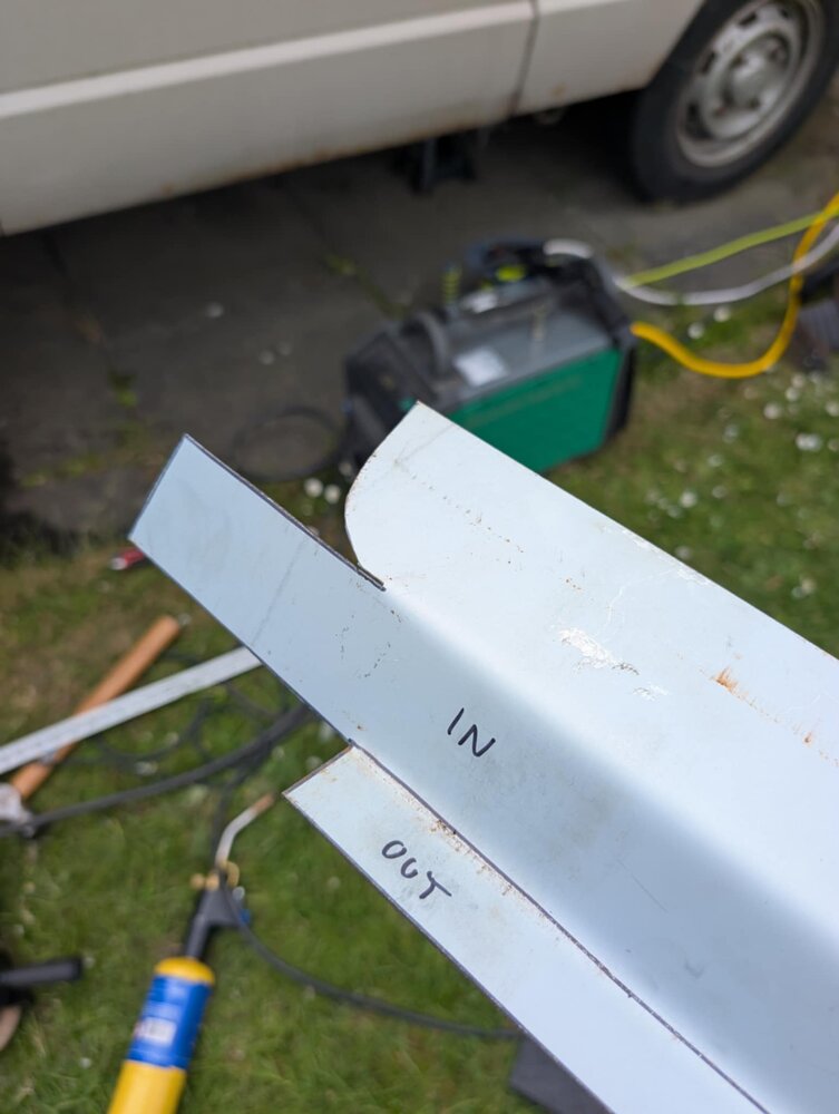

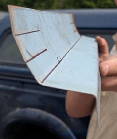

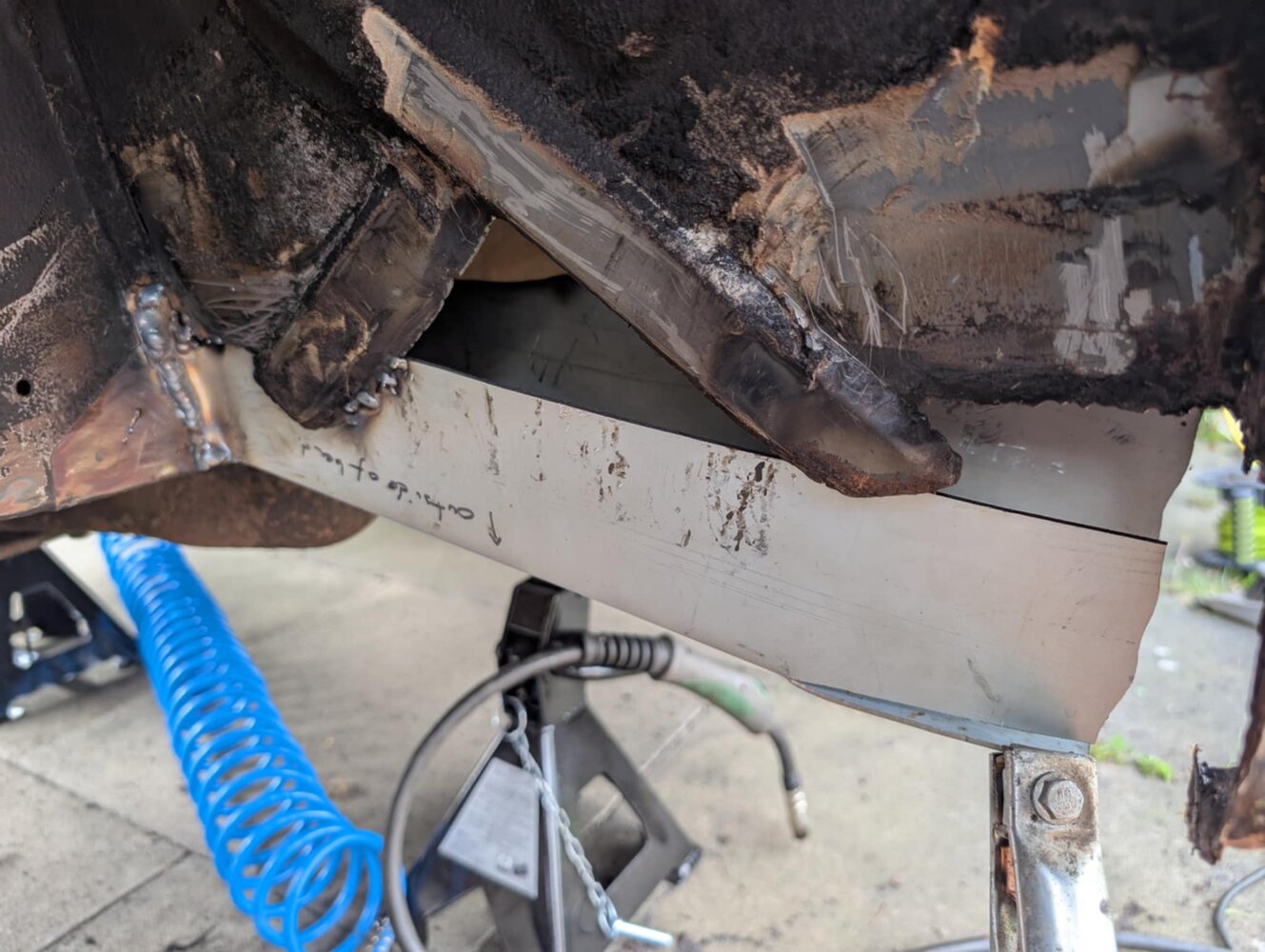

Making up the outer cill

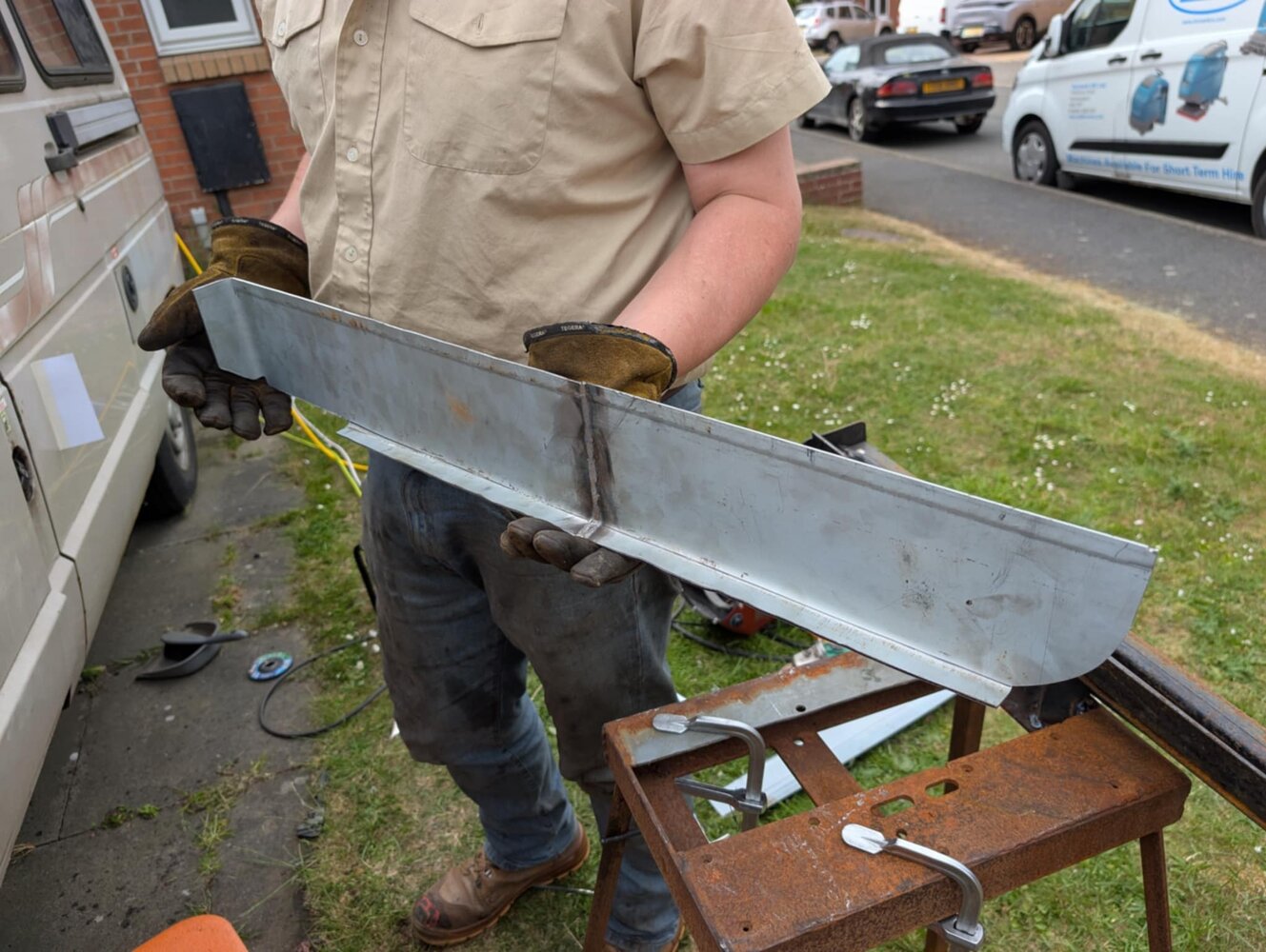

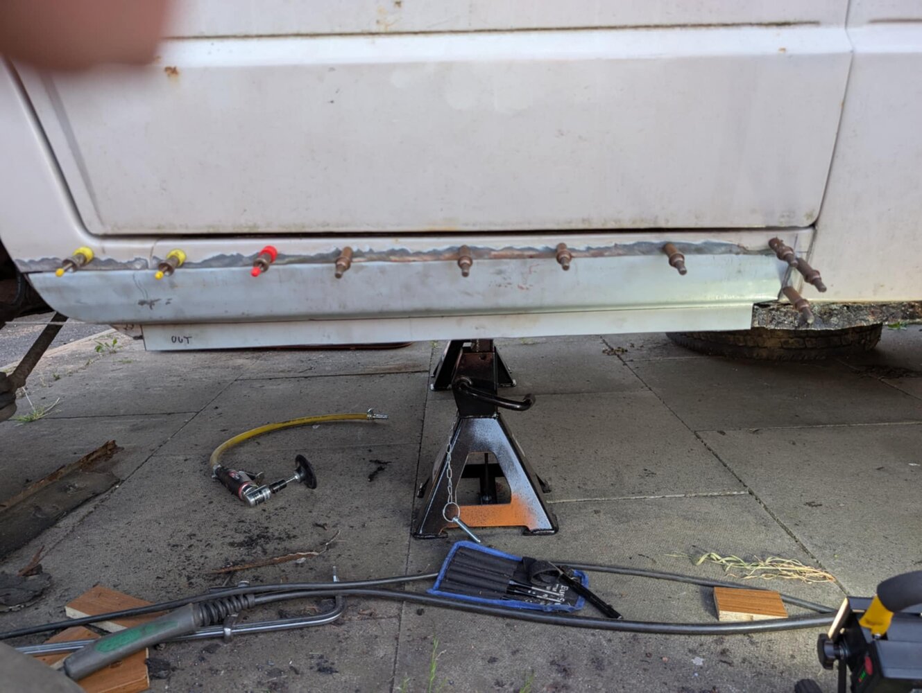

Fitting the outer cill ready to weld.

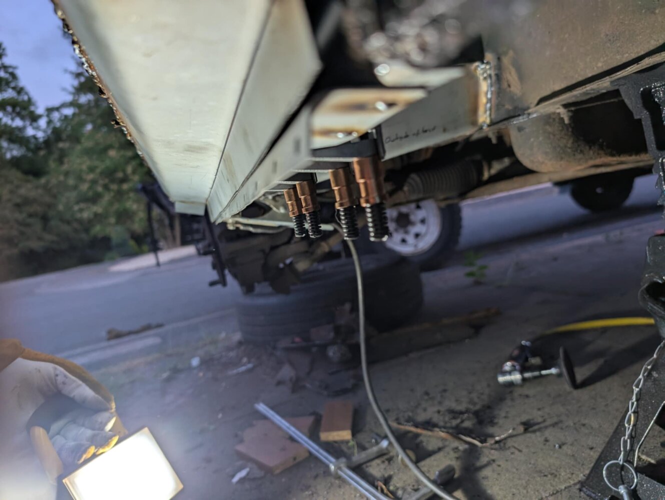

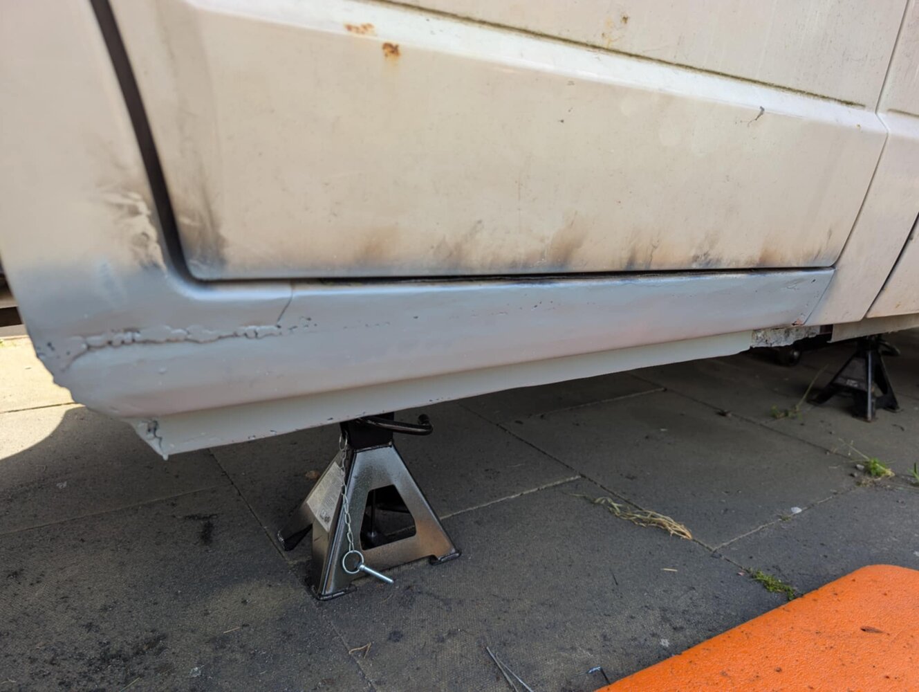

Fitting the strengthening rib that plug welds to the inner and outer sills where they join.
