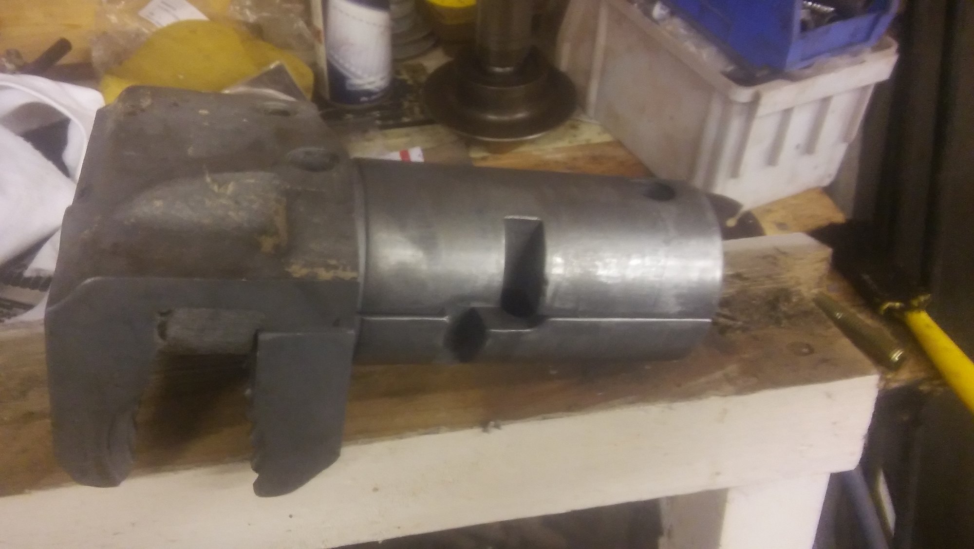

The shock of paying for a sheet of bronze would finish you off so you would never know if it did cut okI have never tried cutting bronze it will cut it but not sure about quality
The originals are missing, Ive borrowed some to copy.Why not set the pair up in a jig and bore them out. Pop some cross holes in them for a key then stick them in a sand casting box with a core and cast bronze back onto the half nut bodies, then re-cut the thread into them. Could even use Babbitt which would mean very low wear on the screw.
I did think about making some in ally as a machining /fixture experiment
Chunk of bronze is £900 and 70% becomes scrap..if i dont mess up
I ll post picture tomorrow. Dsg hnuts are not conventionalBuy a bit of cored bronze, should save a bit of cash & dwarf.
