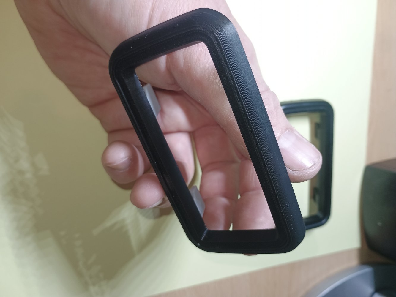

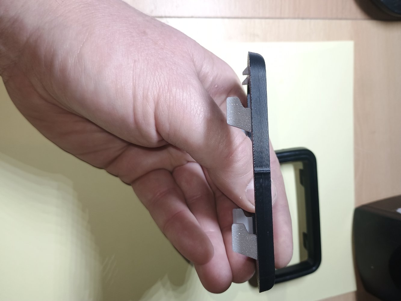

Orca has scarf seams, that might help?
Can you change the radii of the fillet? Print a few test pieces to see if it changes.

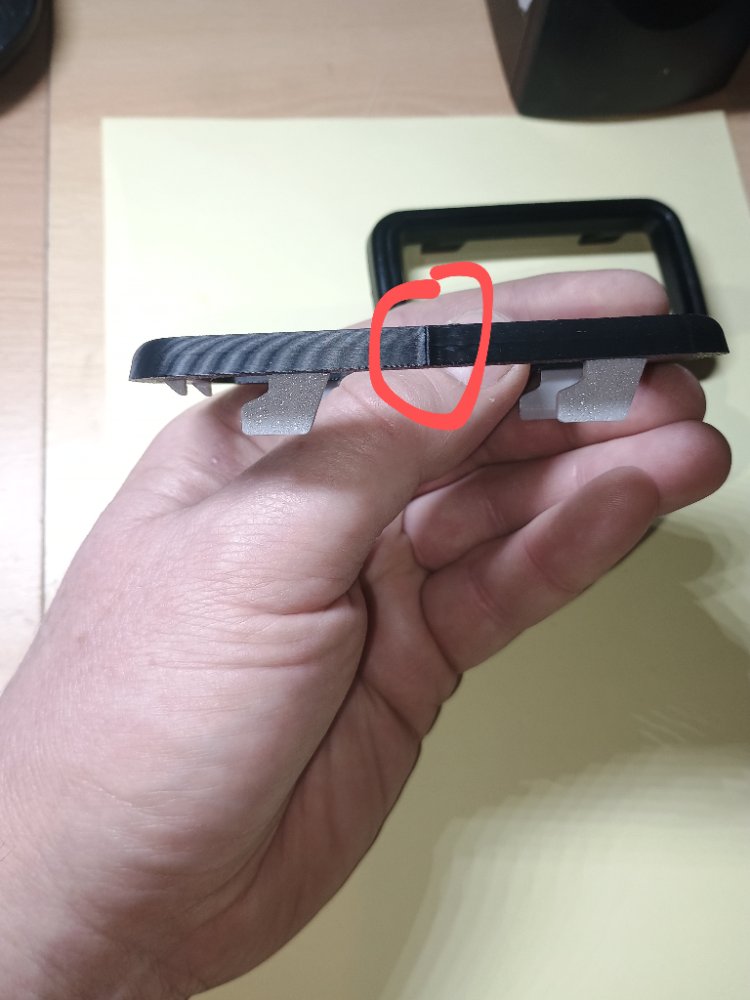

If I'm looking at the right thing in the photos they don't look like seam lines?
Try slicing then preview then zoom in and see if they are visible.
I was looking at the wrong thing.
Cura gives you options for the seam (called Z start or something?)
You can start at a random place on each layer so it's less noticeable. Or at a selected point so it's easier to remove.
