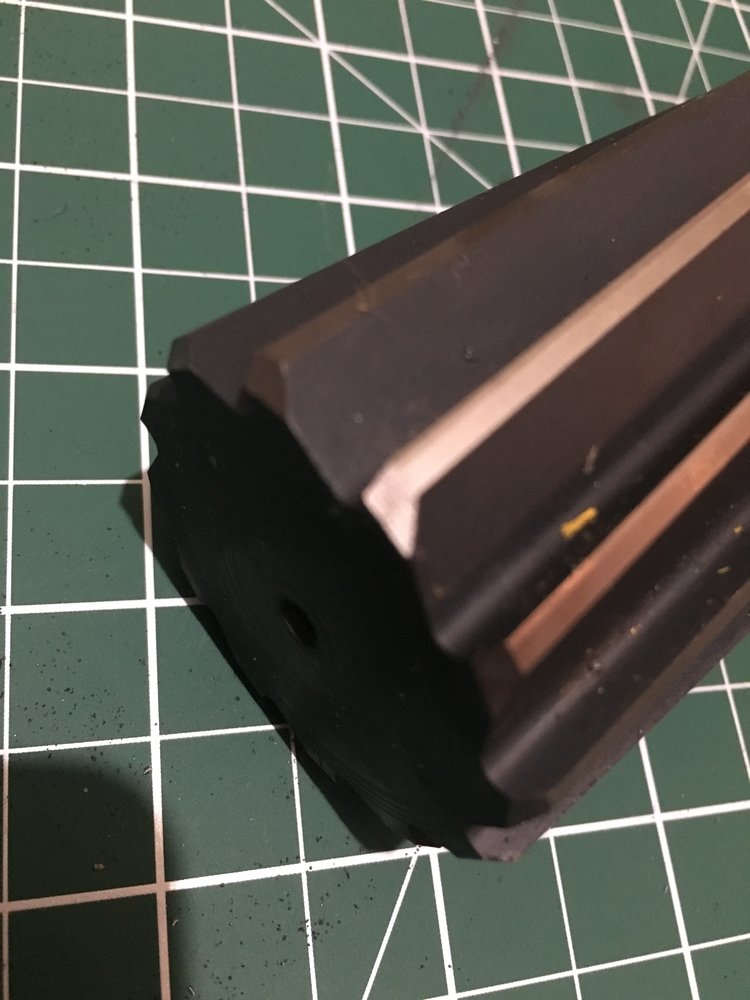

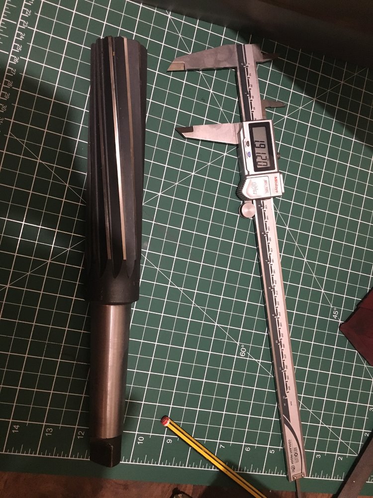

Yes that's the style we use, it passes through the bronze bush and is supported I the roller bearing so it cuts straight.Ahh I assume it is one of these?

Other than the tiny lead you can ream a blind hole especially when you’ve drilled just slightly under so the chamfer left is Minimal defending something that everyone knows has bored the **** out of me nowDid I? Read it again. I said the taper was less on a machine reamer - but not non-existent.
How do you ream right to the bottom of the hole. It must be longer than required as you cannot cut the botyom of the hole with a reamer.
Cheers, we posted one of them off this morning.And when that doesn't make the hole big enough stuff something in one flute.
