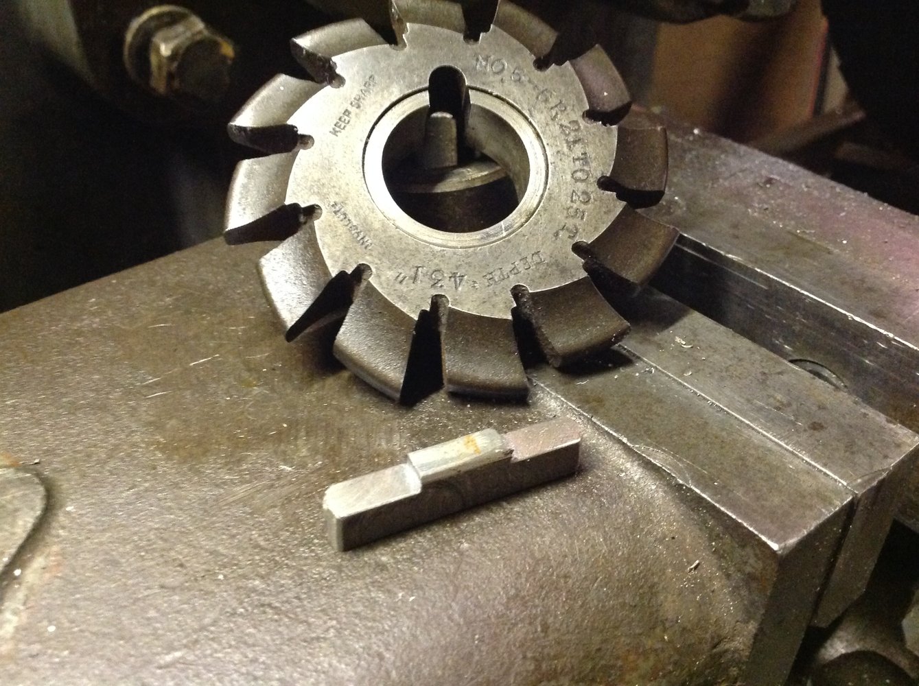

Just had some time tonight to get back to this. I have a number of 1.25 dia cutters, so needed a way to mount them.
The key has been made longer so it uses some support from the slotted spacers either side of the cutter.
So I had to try it. Single cut with a 10 thou cleanup. Looks like I have some arbor deflection, but the supports are way wider than would normally be used..
