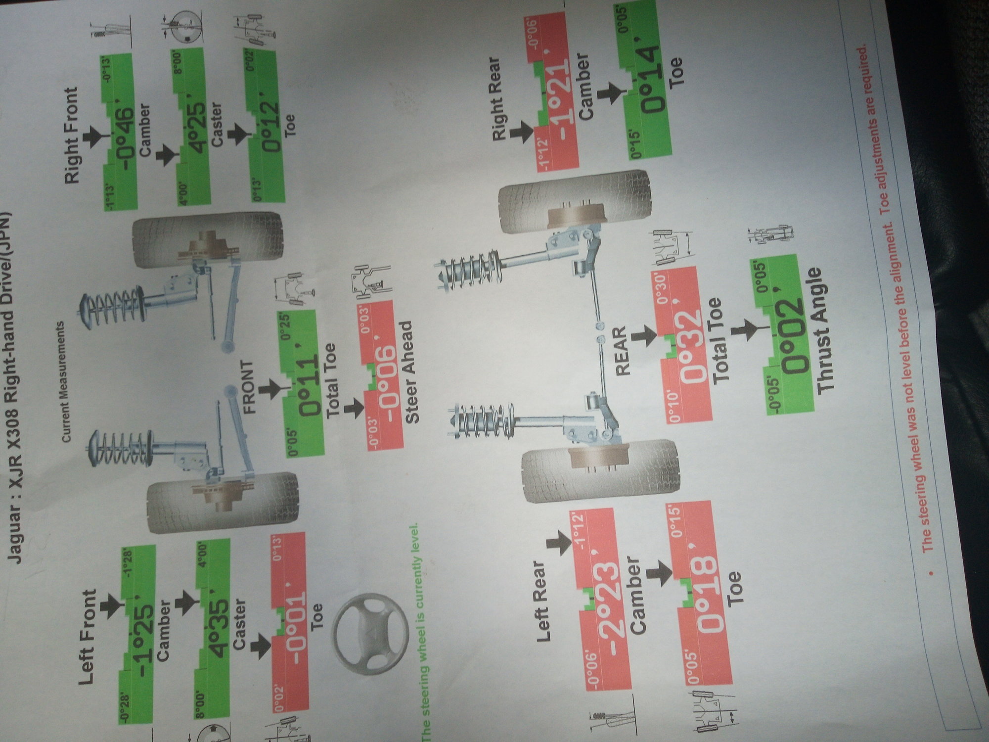

canber will not really cause rear steering that is why I question the results because the toe is not really out and you would expect it to be out if the camber is out that much ??I dont doubt the results tbh, alignment is the only thing they do, it deffintly pulls to the left too. Am i right in thinking thats because its sort of rear wheel steering the car left with that much negative camber?
