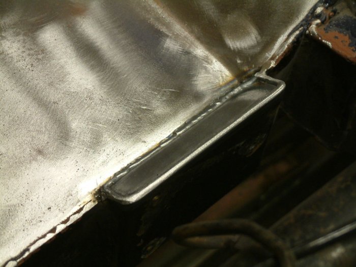

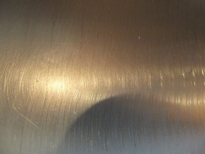

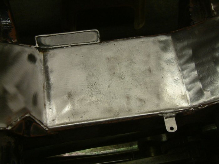

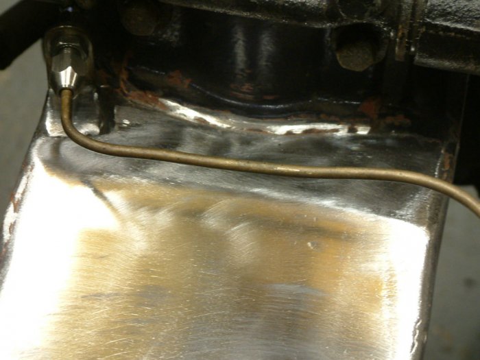

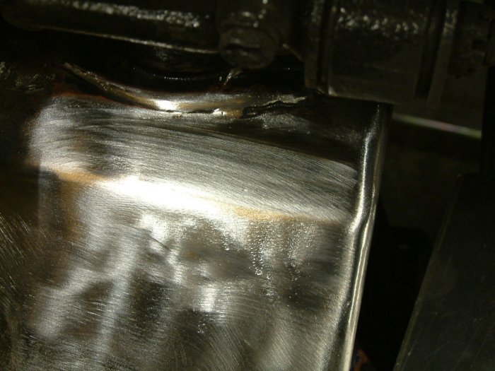

I bought a couple of those Dronco Fleece discs off Weldequip, brilliant for fast paint removal and surface prep but not very good at getting into corners. Leaves a good finish for painting over but not easy to get the marks and swirls consistent across a flat surface. Spits chunks out if you catch any edges! Here are a few photos of a crossmember I was working on yesterday.
