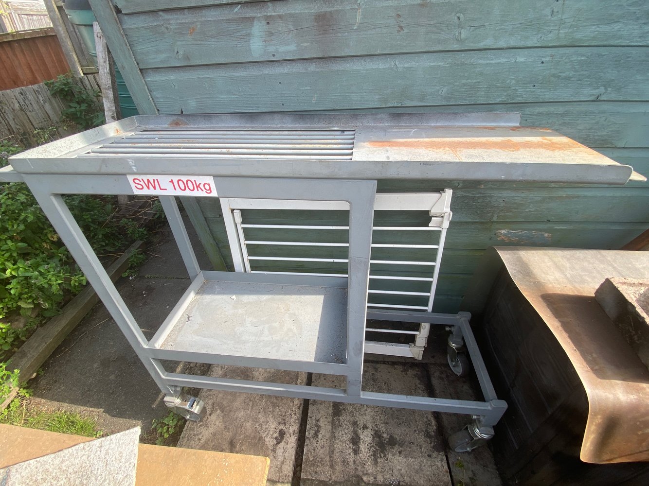

If I were to add a steel sheet on top, over this bench I got , would you leave a void under it (and maybe place some box section on the sides?) or would you go directly to the surface?looks like a bench you’d use for sand casting, filling moulds etc.
i think ideally, you’d have a bench top you could happily tack down to.

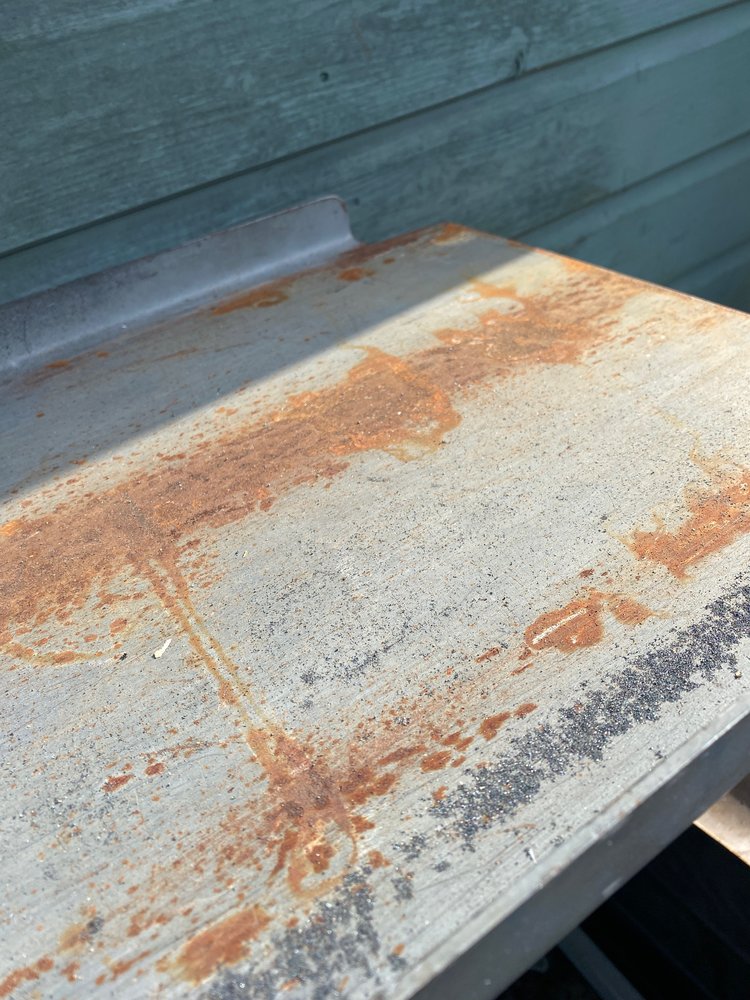

Note - there is a lip of about an inch around 3 of the 4 sides.
And then would i get away with say, 4mm thick due to fact It already has a fairly sturdy top already?
