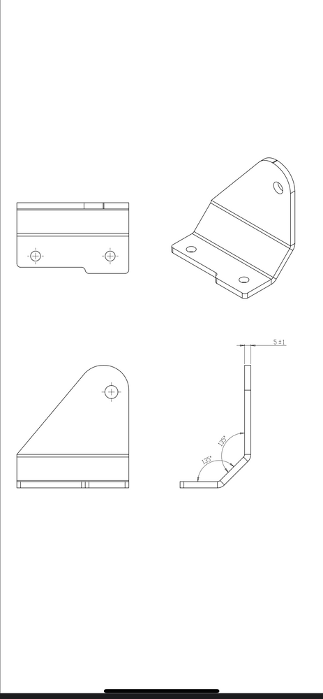

is that a big vice and a beeg hammer ?I can only bend it with a miracle bender so it won't be the tightest radius going but may suit your purpose.
I actually drew it on a piece of cardboard.....
Local fab shop get's allot of these "Farmer Walk-ins" and moan about the charges to draw it, to program
That assumes you’ve set up the material properties, bend radii and k dimensions in the CAD package firstIf you've drawn it in 3-d, go to the flat pattern, click on the face, and then right mouse "Save as DXF"
If in 2-d just save the whole file "Save copy as DXF"
All of those things I do in real life.'That assumes you’ve set up the material properties, bend radii and k dimensions in the CAD package first
If not, your DXF flat pattern will at best be a guess.
If your hole positional tolerance is +-2mm you might be somewhere near it fitting but in 5mm plate it won’t be much better than that
My point at work when our newer members spend flippin' ages (due to how our system works) creating a flat pattern our suppliers then ignoreThat assumes you’ve set up the material properties, bend radii and k dimensions in the CAD package first
Brads only gone and knocked me one up, what a guy!@Brad93 would be able to sort this
