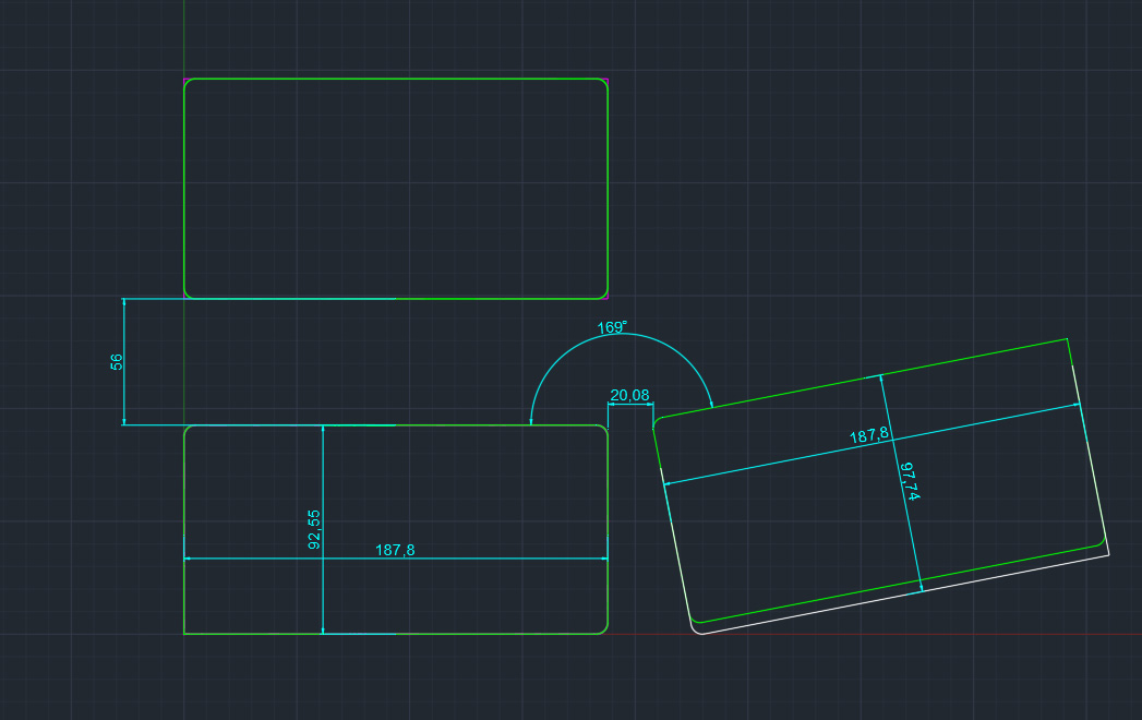

Nothing shown so far as I can tell. One assumes the constraint is provided by the operator and some unseen other features.
You'll need to provide the location of at least one pivot point.
If it's not important, I'll pick a pivot point for you..
On the fixed block put the pivot 40 in from the right hand side (centered vertically)
To stick with a vertically centered pivot on the moving block put that one 95.51 from the right hand side and you'll be there.
Orange (link bar) will be 160.81 between centers.
As I see it, the points where the arms are attached to the two "modules" are shown in the right place in the original posting. Anything else won't keep the intended positions when open and shut. But, both ends of the "orange line" arms will need to pivot, plus there will be an additional need for a joining rod between the arms at each end of the modules, to stop it all getting too floppy.
There is another solution, which would provide greater mechanical constraint, and involve basically a hinge, where the pivot point would be at half the height of the gap between the modules in the closed position, and set approximately 10.04mm (actually slightly less than 10.04mm, because of the 11 degree angle) behind the rear of the modules in the closed position.
That, pretty much, works! I think my minor error is somthing to do with multiple re-draws in CAD, but, its basically working.

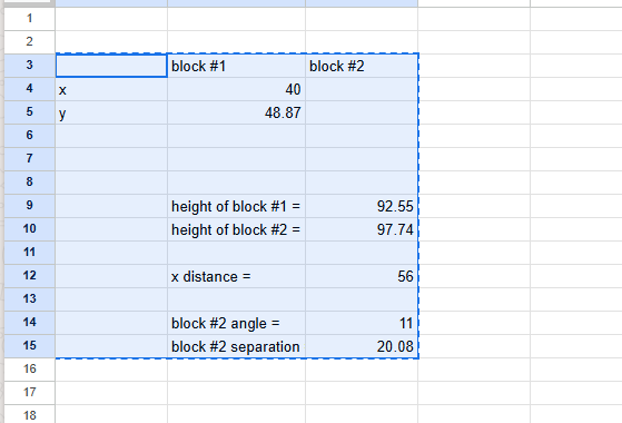

Can you show me the sum you used in more detail, so as i can move around the pivot point on block #1 to suit the design better? Its not a fixed requirement, but, with your working, i can load up a spread sheet with the numbers, and see what it spits out for block #2 when i move block #1's point.
Ive been trying to do this for ages now, and, whilst your numbers work, im still unsure how to calculate them for myself!

Not without a given pivot point.
With the 2nd block in the top position the left hand edge is at 0⁰.
In the lower position they are at 79⁰ so that gives you 2 angles. From that you only need one dimension to work out all the other sizes on a triangle, hence why I've used 40 as a start point.
I suppose you could put a formula into a spreadsheet to show you the position of the pivot on one block in relation to the other but you'll still have to define one first even if it's just centering vertically or something
Yep, thats what i mean -
I could put it into a sheet, and enter my preference for block #1 pivot, and then see if the position it spat out for block #2 pivot were favorable to me.
What youve given me works, which is what i was struggling so much with, but there may be more optimal layouts.

i just cant remember how the points were calculated. Im sure i did it in CAD with intersecting arcs, but @hotponyshoes seems to have done it with an equation.
If you want to construct a solution using a compass, I'm pretty sure this is correct (don't shoot me!)
The two white circles (orange radius) represent every possible position of the target corner in both positions.
The green arrow is the length the target corner must be from block 1 pivot when it meets X.
Where the two white circles meet tells you where the target corner must be X distance from the green vector. You know the length of the green vector, draw it in place and you could even draw a blue circle to show the X distance but that overcomplicates things....
The key issue I think is that block 2 needs to be oriented as shown when target corner reaches X and you can find that solution by intersecting the white circles as above.
