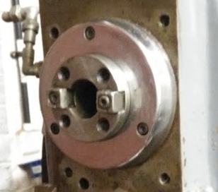

Update, contacted a company regarding having the spindle reground to mt3, the reply was that due to the tolerances and awkwardness they will not grind to mt3, but could do an INT taper too
Just nabbed that NT30 shell mill off Amazon (for a tenner, why not) but am struggling to find a receptacle for it. Would like to at least find a straight (parallel) adapter so I could grip it in a 4 jaw. I am reluctant to turn it down to ~20mm which seems a bit too skinny to drive it on the lathe plus I will one day want to fit it to <whatever it is I have on> the Bridgeport.
I have an SA40 (same taper and size as the INT40)taper in my mill, I have 3 SA40 to morse sleeves, (morse1,2 an3) that don't have drive dogs, they have never slipped and frequently need a deadblow to pop them out! Here in France the SA40/NT40 taper are the most available taper mount!I would have said INT would be preferable to MT. The issue however is that MT is "self-locking" taper and drive is via the taper. With ISO/INT (the difference between them is only in the drawbar thread) the drive is via drive dogs and the taper only exists to ensure concentricity. It is NOT locking and not suitable for drive.
So you would have to fit drive dogs. Which would mean more machining and make it look something like this.
Which may or may not be a problem depending on the spindle design. Unfortunately the http://www.lathes.co.uk/taylormillermk2/ page doesn't show the spindle closely so I can't suggest if it's realistic or not.

The answer is! I don't know. In my opinion, the draw bar and the taper are sufficient! I would risk it, to be able to have tooling that fits as opposed to one solitary item!SA40 has drive dogs though. That it works without them (and it will happily most of the time) doesn't make it "right". My "ISO 30" in my Harrison will typically need a tap to remove and is almost certainly driving 99.9% on the taper. The drive dogs will stop it rotating though regardless of how heavy a cut you take. You cannot say the same if it's just retained by the taper, would it stall the machine before it slipped?

It's not going to be as rigid as something that engages in the spindle bore but if it works why not?So, not much progress on the re grinding front. I’m considering buying a cheap collet block and turning a thread and register to screw directly to the spindle nose in place of what would have been the original spindle nut. Any thoughts on why this will/won’t work?
