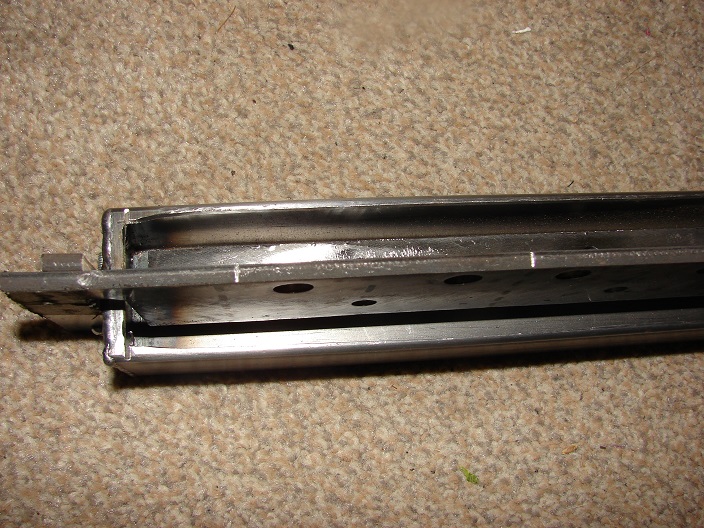

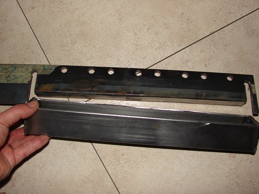

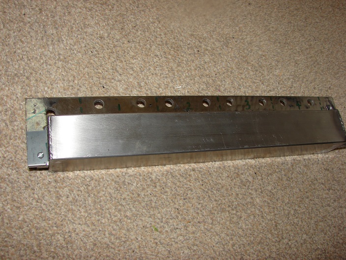

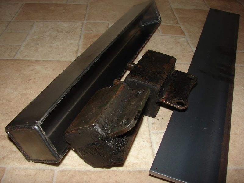

Hopefully this helps explain Plan B. Ends welded to the box section and then the top cut off with a slitting disk. I now need to drill holes for the mounting studs through the base of the trough and hang the 5mm top plate from brackets to be welded on each end. Once the rubber has set it can have the ends cut off the trough and 4 completed rubber mounts can be separated by hacksaw. The 5mm plate needs the holes drilled and something done to the bottom of it to hold it more securely in the rubber, as per earlier comments.
