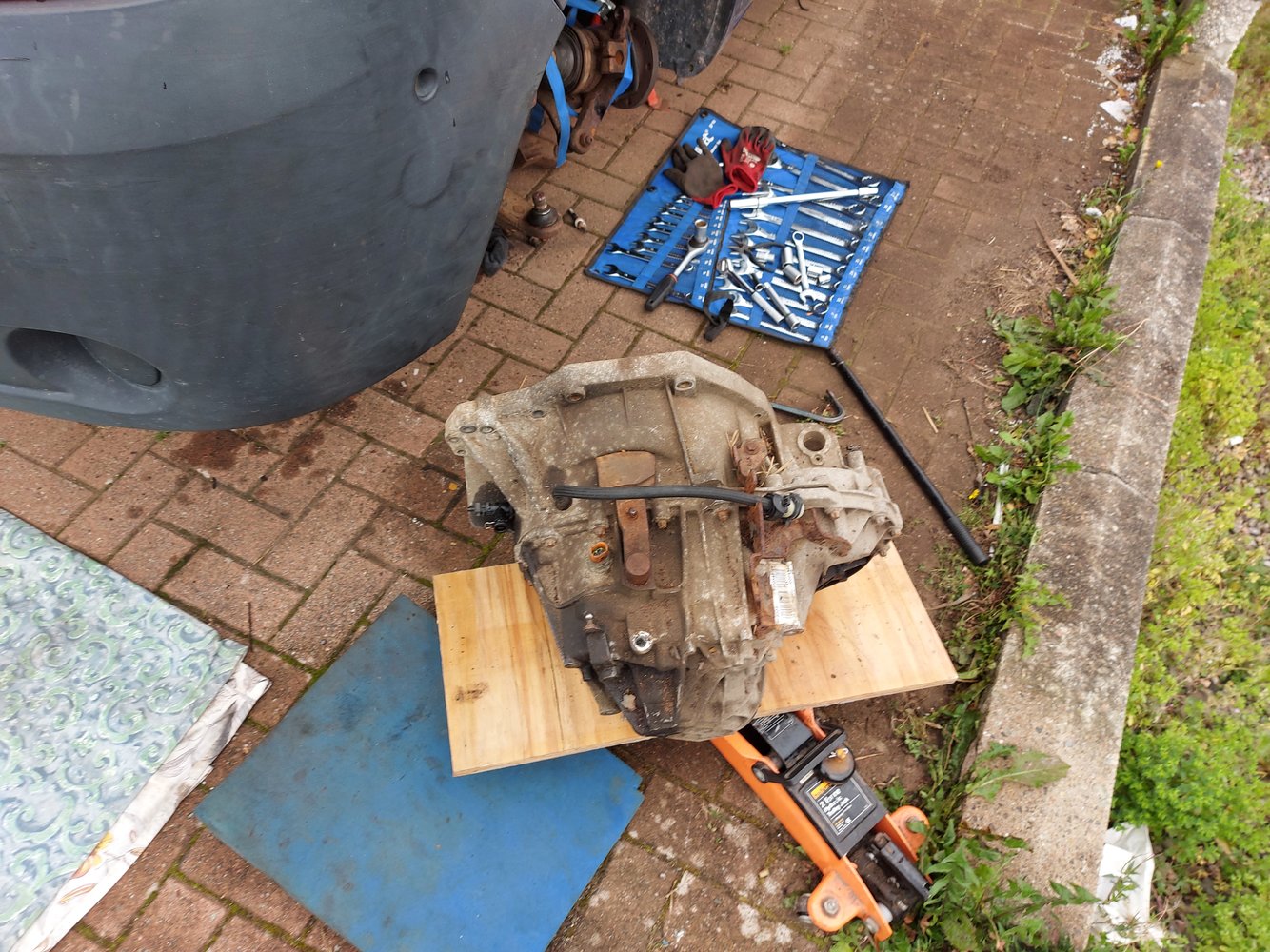

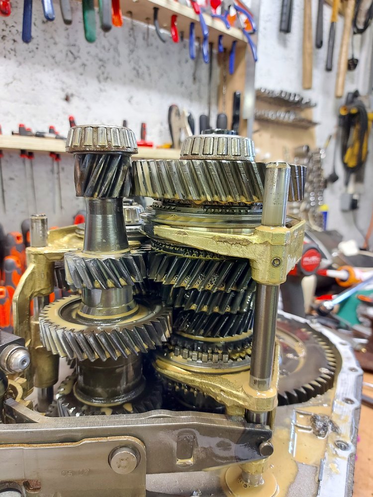

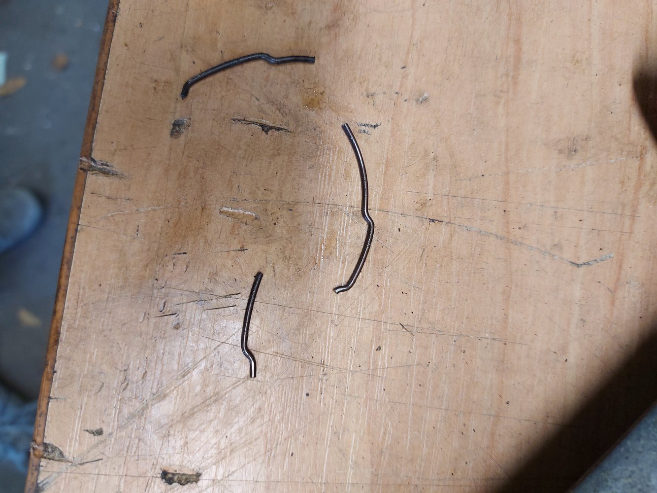

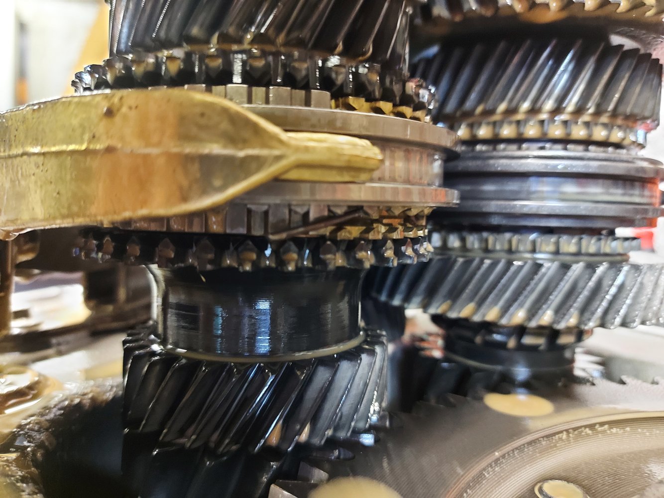

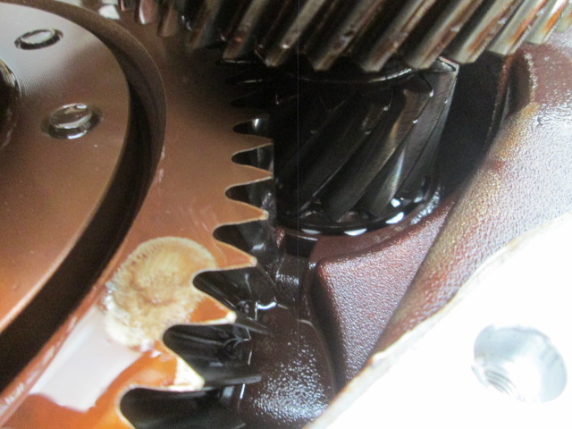

I too know the "pleasure" of rebuilding the Renault PF gearbox. Mine had 3 problems, selector bushing was goosed (and unlike others can only be replaced by splitting the gearcase), 5th/6th synchro spring had snapped preventing 6th gear from working and when inspecting it the 6th gear bearing was worn (Apparently quite common on these). Took every last drop of my 12t press to get the shaft apart to get at the synchro.
View attachment 444180View attachment 444181View attachment 444182View attachment 444183

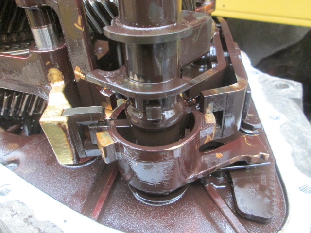

I have not seen that synchro spring broken before. I wonder if it had anything to do with the worn/seized top selector shaft where it goes through the case ?I too know the "pleasure" of rebuilding the Renault PF gearbox. Mine had 3 problems, selector bushing was goosed (and unlike others can only be replaced by splitting the gearcase), 5th/6th synchro spring had snapped preventing 6th gear from working and when inspecting it the 6th gear bearing was worn (Apparently quite common on these). Took every last drop of my 12t press to get the shaft apart to get at the synchro.
Selector was loose as a goose as they say. 1st to 5th were vague to say the least!. Had my eyes and ears on when using the press and it went with such a bang I still s**t myselfI have not seen that synchro spring broken before. I wonder if it had anything to do with the worn/seized top selector shaft where it goes through the case ?
This is also a common source of problems, causing stiff gearchange, and not being quite able to get it beyond the detents, causing it to either grind, or be thrown out of gear.
The much earlier ones had a big rubber cover over it to stop water ingress, but that was deleted for some odd reason, probably cost cutting.
Yes the press, they do go with a bang !

It makes my tribulations with my wifes MG6 1st motion input bearing a tad trivial..I too know the "pleasure" of rebuilding the Renault PF gearbox. Mine had 3 problems, selector bushing was goosed (and unlike others can only be replaced by splitting the gearcase), 5th/6th synchro spring had snapped preventing 6th gear from working and when inspecting it the 6th gear bearing was worn (Apparently quite common on these). Took every last drop of my 12t press to get the shaft apart to get at the synchro.
