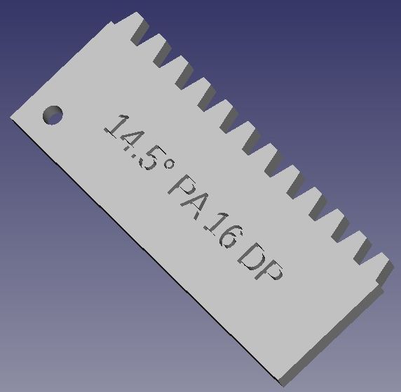

There are often questions elsewhere on here about identifying gears.
It is possible to buy gear gauges, but they are expensive.
Attached should be three files: an example STL, a JPG picture and an OpenSCAD file as a parametric way of making your own set of gauges.
Delete the .txt extension as required to recover the original file.
